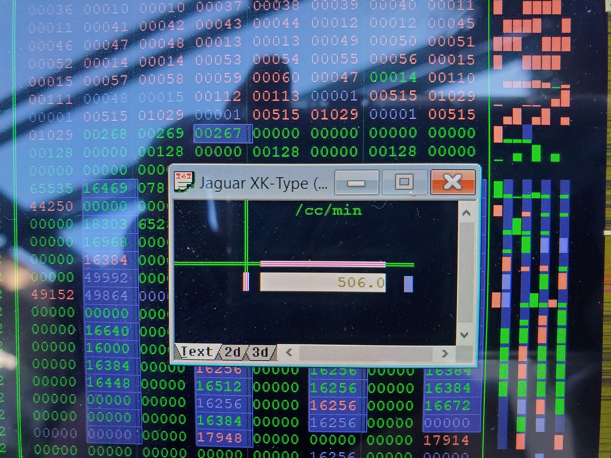

So first trying to figure out exact injector size on our 07-09 Xkr cars to see how much room we have on maximum Ethenol content. Going by the super rich factory AFR at WOT it appears that there will be some room for more Ethenol with leaned out WOT.
Flex kit installed by anyone?
Specs on our injectors ?

There are type of 4.2 injectors. 03-05 green ones and 06-09 red ones. I have not flowed them but there is indication that at 43.5PSI ( 3bar ) they flow just 330cc, but since base pressure has been set
for 55PSI the actual flow is 370cc. At the 65PSI those injectors flow a bit over 400cc. I have tested 4.0 R injectors, AJ 26S and AJ27S, and they flow 360cc at 43.5PSI - but since base pressure is just 45PSI, they flow less than 4.2 ones. 4.2 injectors can be replaced by Bosch EV14 - forexample 530cc or 630cc. Since you are able to tune the fuel maps the size is not a problem even with normal fuel. There are a couple of problems with 4.2 fuelling system ( if not also the fuel pump ): The system is retunless, so you might want to modify it to be with retunline and add FPR to set desirable fuel pressure. Also, for E85, the fuel damper gaskets may start to leak because of the rubber they have used as OEM. If you would have return line - you do not 100% need the dampers. I have used this route. There are very good E85 flexfuel kits available nowdays. I used one 2016-2018 and fuelling was just fine at any ethnaol & - driven 5-85%. Now I have fuelfuel function in the aftermakert ECU, so no need for separate box.
EDIT: "Stock flow on these injectors matches the OE specifications.
330CC/MIN 100% Duty Cycle @ 43.5 PSI
https://www.ebay.co.uk/itm/SET-of-8-...-/201820425788
Thanks for the tips, I was hoping that our stock red ones flow at least 420 or so CC. I guess I can always log and calculate the duty cycle of the injectors to see how much e85 I can push.

I think I just found what I'm looking for in the ECU file itself. 90% confidence... Good news if correct 👍

Well there ya go. But, 50 lb/hr seems a bit on the low side for alcohol. Will that be enough? I truly have no idea, myself. Course, E85 doesn't need as much as 100% alcohol.
