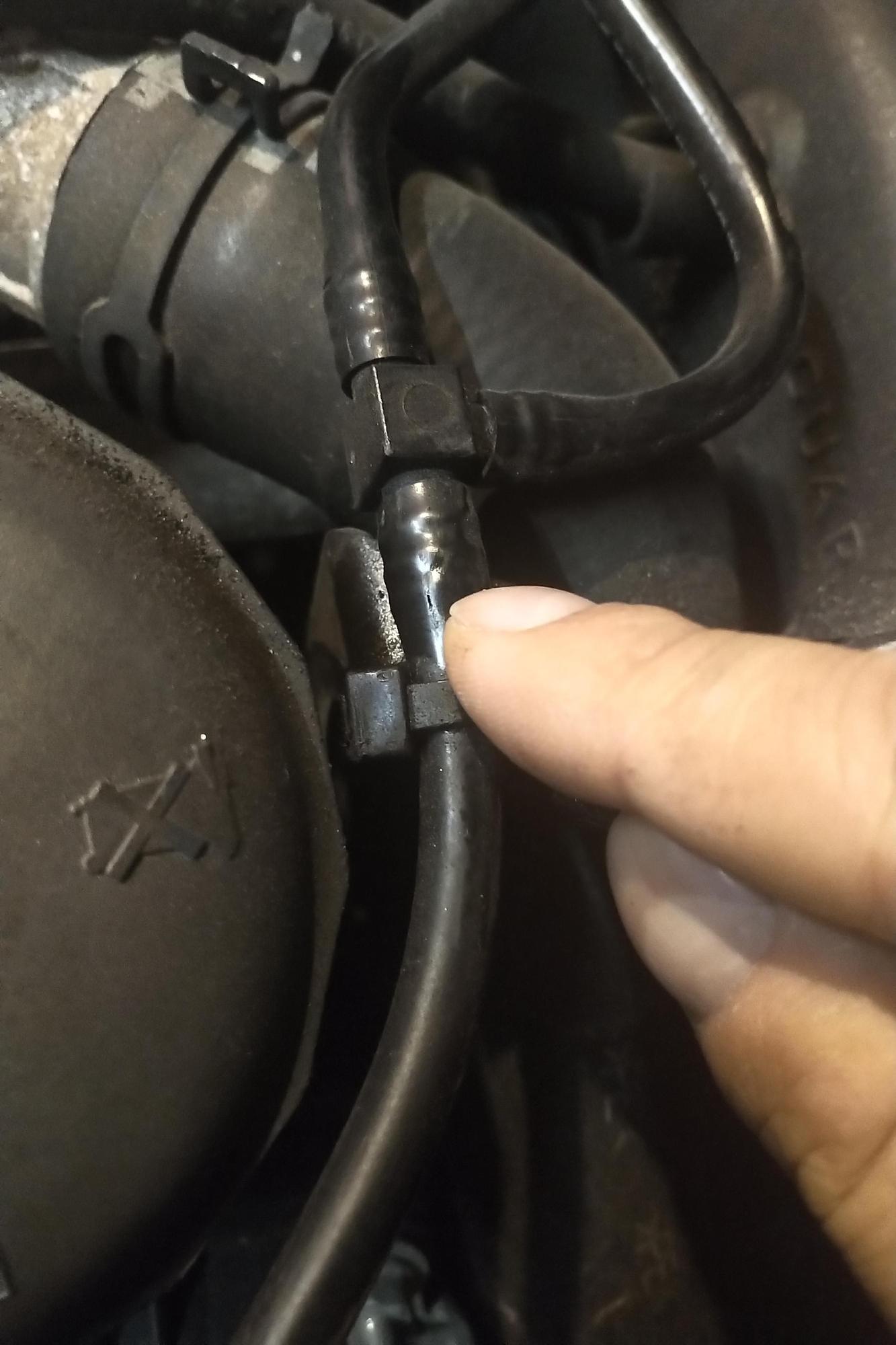

Well, bit of an update here. I was getting ready to go to the Jag dealer tomorrow to order the water pump and some other stuff, went out to the car to check if I had an oil filter cap wrench that would fit and happened to notice this....
A tiny little split in a tube for the coolant overflow - looks like it's leaking coolant onto a bracket below it and from there it's running down around the water pump.....So there's a chance I don't need a pump after all! Going to replace this tube first and monitor from there. Tube appears to be part # C2P13304
