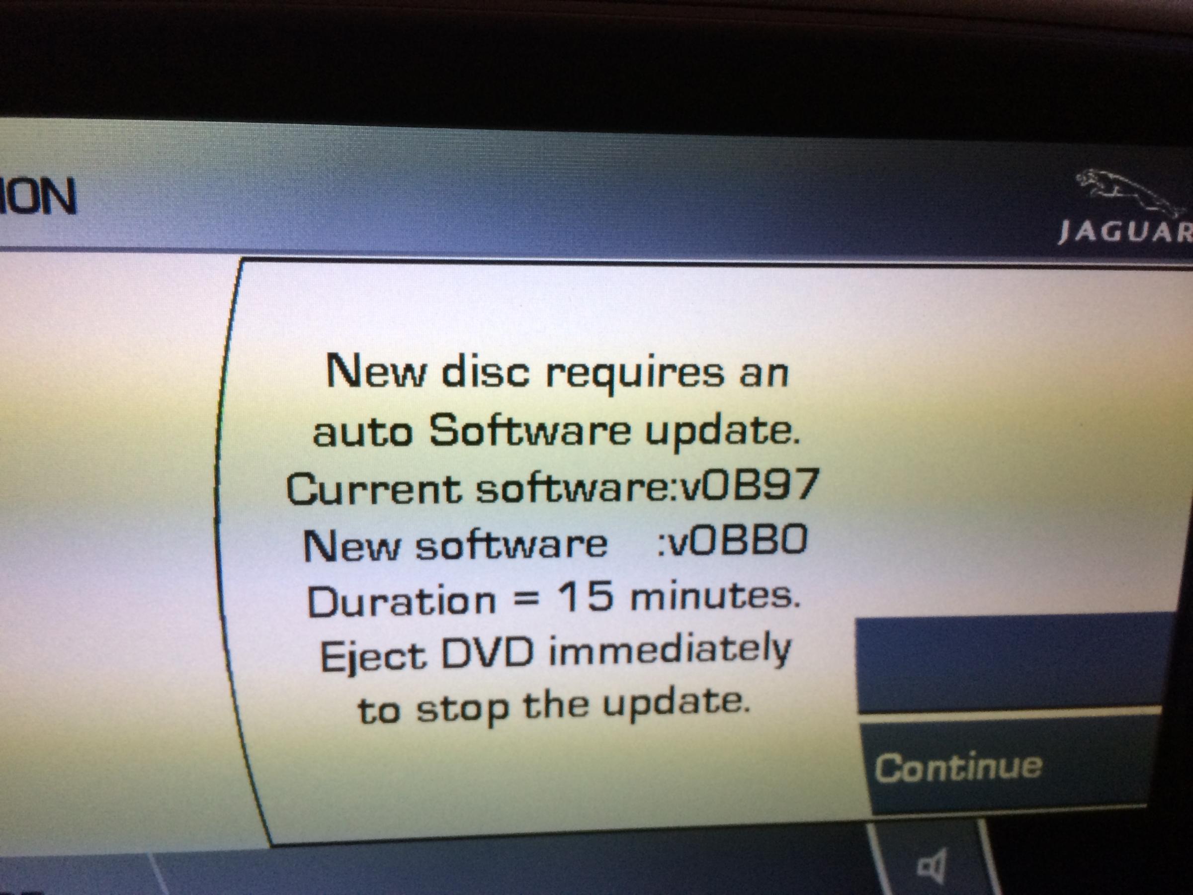

The 2013-2014 Nav DVD does contain a software update (see pic). It took about 15 min. to install and showed the leaper on screen three times while I was watching. The Navigation option is grayed out during the install, otherwise, all other functions on the display unit work while the update is processing. I had the 2008-2009 DVD previously (came with my 2010 XK when I got it a month ago), so I expect there are a number of map and POI updates over the last 5 years as well.

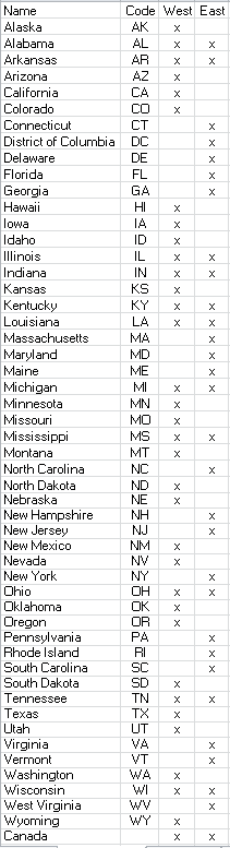

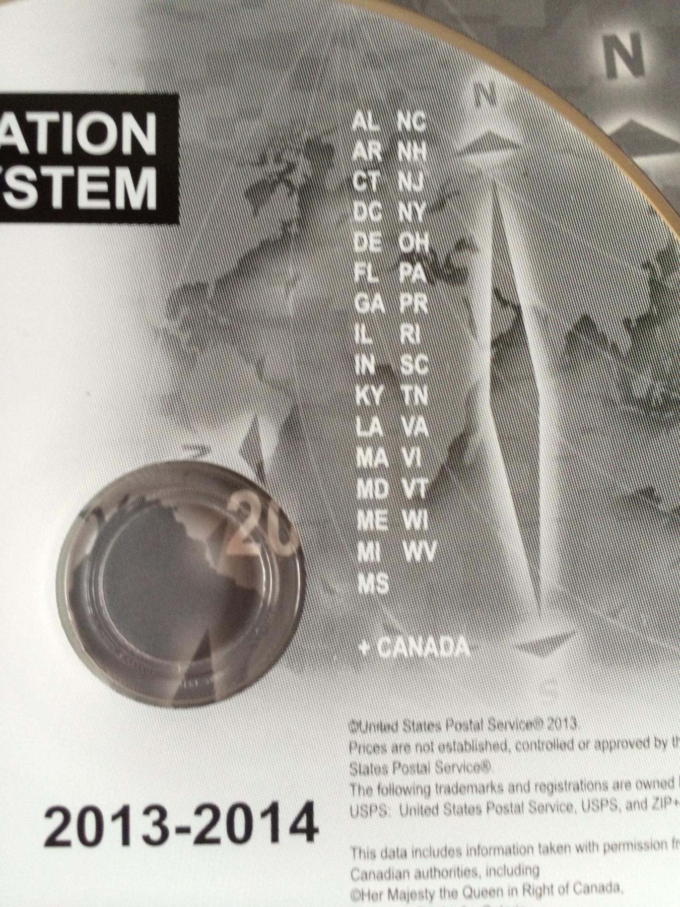

There are two disks with the DVD set, one for West and Canada and the other for East and Canada. The shipping label shows this is for the XF as well. I created a cheat sheet to show which states are offered on each disk. I paid $222 including tax and shipping from the Navteq site. Since I live in California and don't anticipate a cross-country trip in this car, if someone wants my East disk for half that, shipped, shoot me a PM. I won't rip copies so please don't ask.
