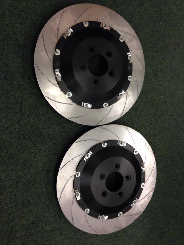

No they bolt right on and I got the calipers for 1500 but they literally the last set in the world and all the parts were source from three locations. THANK YOU SNG BARRETT!
This is what you need
C2P 16232 caliper
C2P 16231 caliper
C2P 13388 Bracket
C2P 13387 Bracket
C2P 16209 Hose
C2P 16208 Hose
These are the AP rotors that Spires made for the calipers
Well, how does that help me?
Rotors look really nice! How quickly did you get them?
Old Mar 20, 2014 | 03:00 PM
Rotors and caliper will be here next week. They are working on the rear Diffuser and a few paint chips this week.
