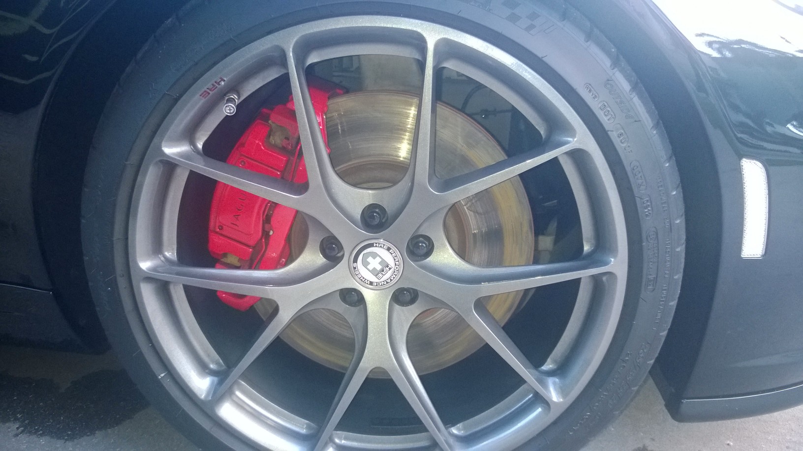

Since you went to the Alcon 6 Piston calipers........will your wheels have proper fitment over the oversized Alcon calipers?
The HREs have plenty of extra room, the stock calipers are actually huge and I still a have plenty of room. That was one of my concerns as when Spires told me to go the Alcon direction
