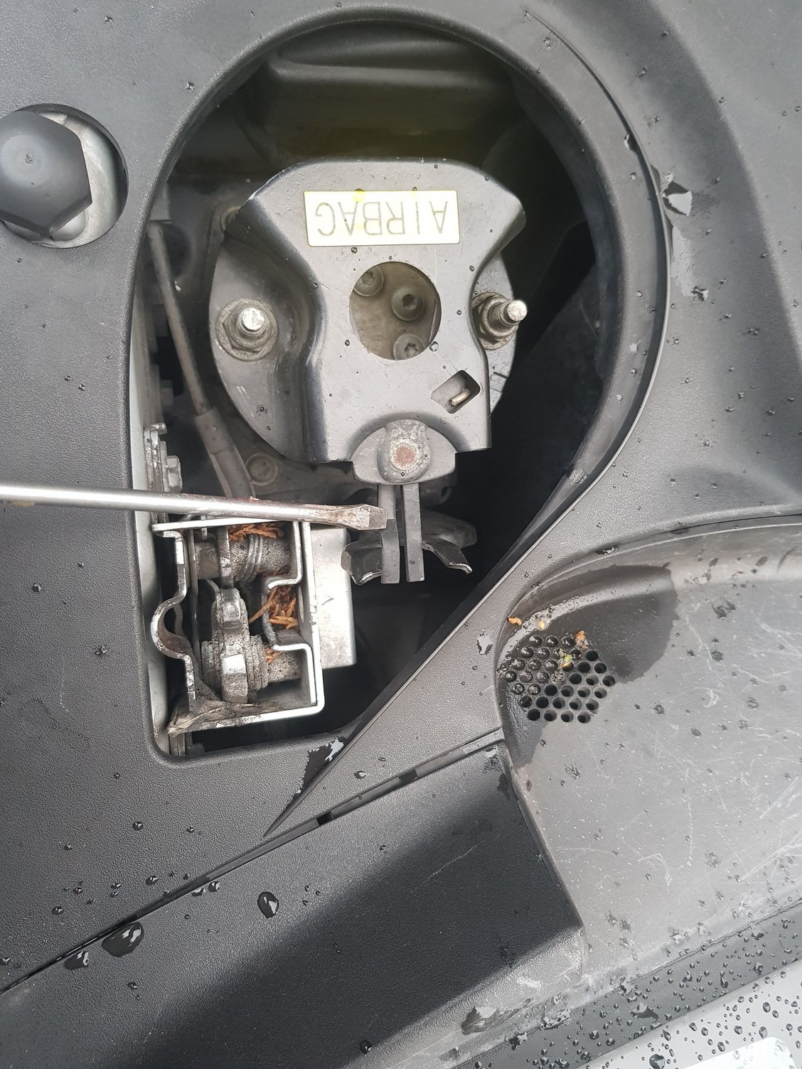

Default Did your bonnet air bags go of?
If they did then it's the two black "V" shaped switch When they are apart this cuts all power to the car. A simple cable tie pulling them together will allow the power to the car.
if the bonnet bags did go of and you are un sure of what I am trying to explain, let me know and I will post a photo of the switch I am talking about.
yes please post pic if you are available.
Ok, if your bonnet air bags go of then this black pair of switches will separate into a V shape (screwdriver pointing). They are spring loaded. When they do spring out it will cut all power to the car.
in the second picture you can see I used a cable tie to keep them together while I was doing a job on the car with the air bags removed from there located positions. This allowed the all power to the car so it could still be started and operated as normal.
Hope this helps some one understand a little more.
