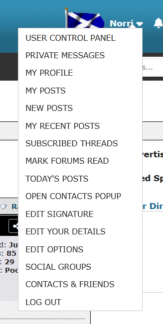

As an aside, how can I send a PM to a member?

Click the drop down arrow by your name at the top of the page then follow click on "send new message" in the list at the left hand side of the page.

Because you've been a Forum member since 2020, you're qualified to send PMs. To send a PM, tap on your screen name at the upper right corner to open the drop-down menu, click on Private Messages, and then Send a New Message.
