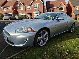

Doesn't look neglected and driver's seat bolster suggests not high miles (?).
Could be the angle of the photo but the shut line between the bonnet and LH wing looks like it drops at the front.

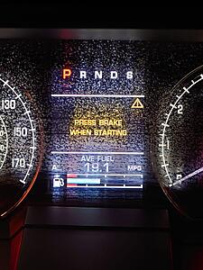

Pretty sure I should tackle the Speedo issue first. When the sun hits it right I can't even read the dials making it a pretty hefty safety issue.
Can you advise me on how to remove it?

The wing and bonnet don't quite meet perfectly, I noticed this before buying and have also found masking tape in the passenger door shut. It would suggest the wing was sprayed at some point, the plastic side skirt/ sill cover is also dented just behind that same wheel. Again it suggest there was some kind of incident.

Yeah the photos really don't show the amount of parking dints and other minor issues. But I suppose given the age of the vehicle I have to expect that to an extent.

So I've finally got around to fixing the misted up gauges. It turned out the marks were on the outside which I can only imagine they have come from a very strong cleaner being left on the plastic (such as bleach).
Night-time before:
First I tried some polish and cutting compound but unfortunately this didn't work. So I reluctantly wet sanded the plastic with 1000grit paper, after that I went to town with the cutting compound. The results speak for themselves, I should say it is not perfect but it's close enough and certainly a huge improvement!
During:
Night-time after:
Daytime after:
Perhaps this will serve to help others in the future but I seriously doubt many cars have a similar issue. The previous owner must've been an idiot to think using bleach on plastic was a good idea. A few words of warning, don't close the boot when the battery is disconnected, a minor mistake but one I won't make again. Also don't open the door because the window won't drop to allow it to close properly, I learnt both these lessons the hard way while it was raining *facepalm*. Aside from that the gauges come out easily, lower the wheel and bring it all the way forward (disconnect battery now) then remove the wood trim (4 clips on each corner to pry away). Then remove the black plastic gauge surround, 1 screw sits under a hidden flap at the the top of the surround (just visible in the photo above), the other two sit behind the wood panel, they are the black screws. Now remove the surround to expose 4 hexagonal screws which hold the cluster in place. The black steering column surround can be moved by hand making it easier to access the bottom two hexagonal screws, once all 4 are out pull the cluster forward and disconnect the two electrical harnesses. That's it! Putting it back in is very simple and is a direct reverse of the removal.
