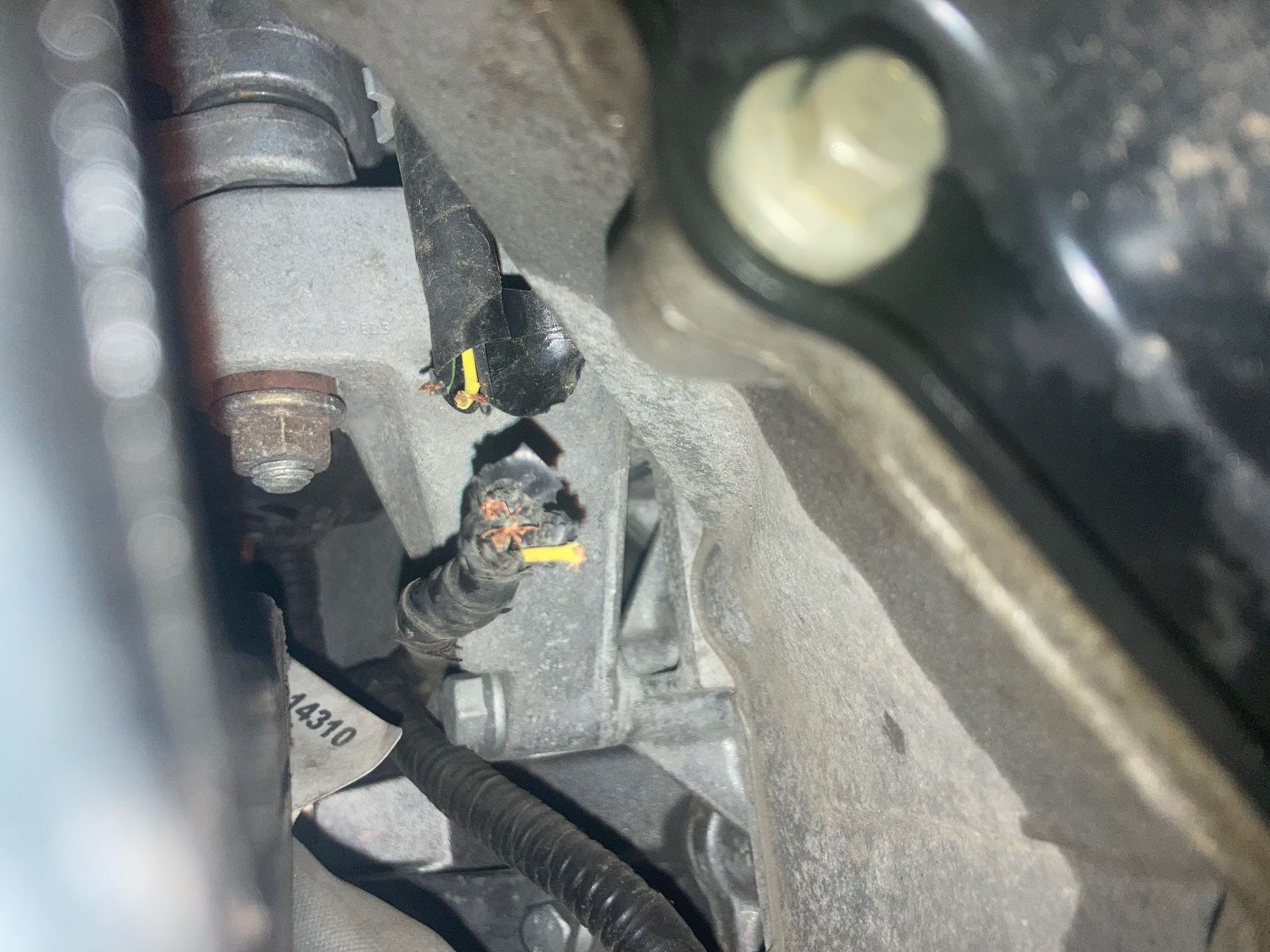

2.P0198 - Engine Oil Temperature Sensor high - I tried cleaning the sensor but the code is still showing, Ordering a new sensor.
Changed out the sensor today, part # LRA1600AA, doesn't fix the issue. I investigate further visually and wiring is broken.

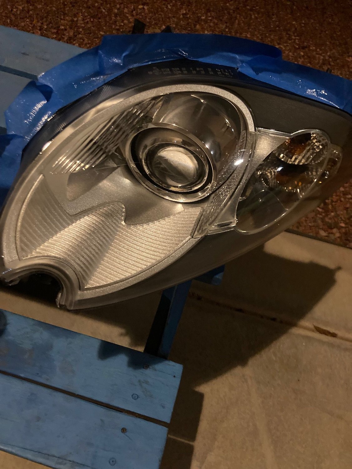

On a positive note I just finished resurfacing the LH side headlight and sprayed it with 2K SprayMax clear coat. It was my first time attempting this and I would say my results are about 90% of what a professional would probably do. It has some water spots under the clear.

Headlights after sanding and spraying with 2k Clear coat.

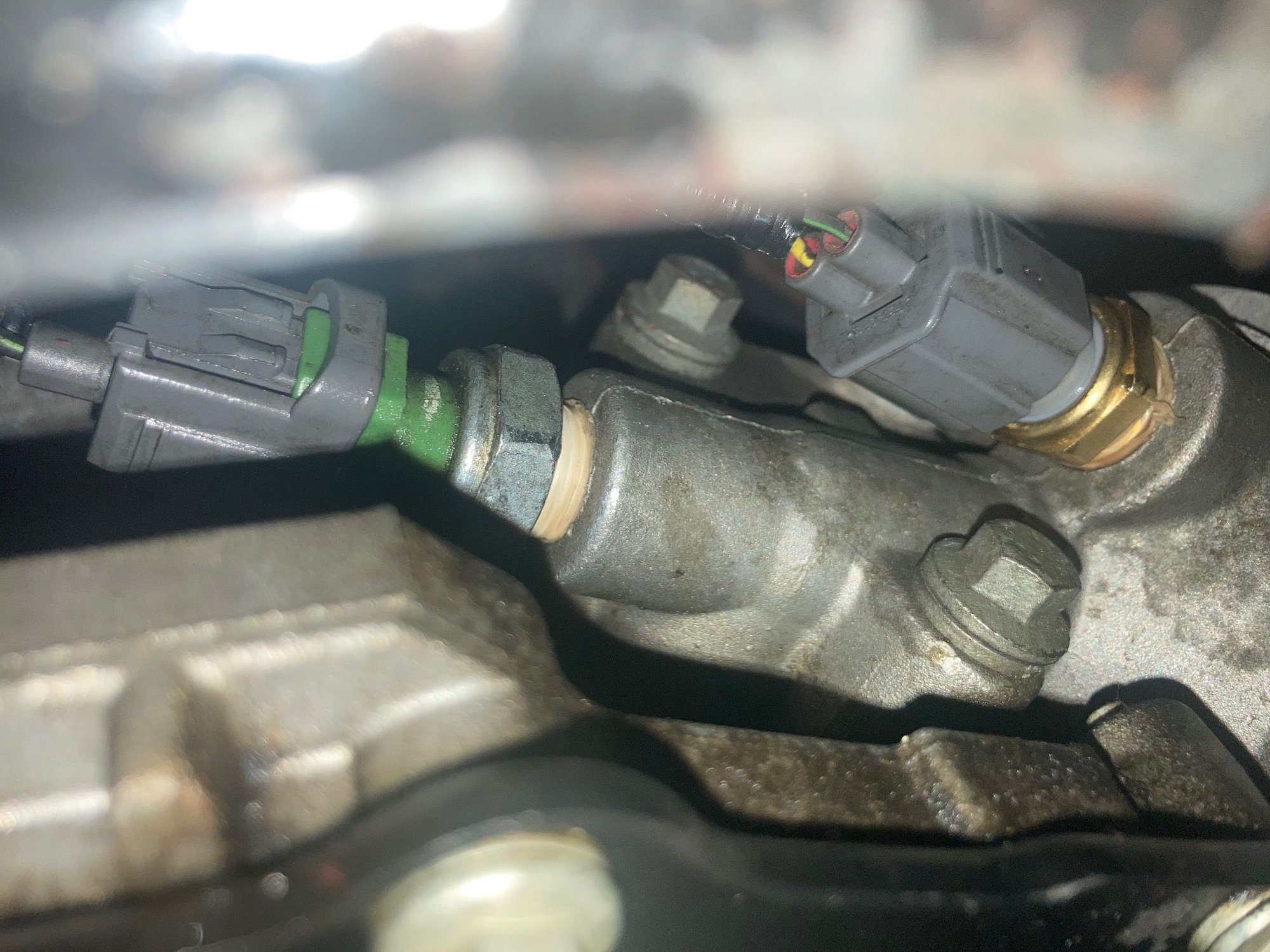

Does anyone know how I can figure out which wire goes where? It looks like the Engine Oil Sensor has a yellow wire and a black with green stripe wire. The Oil Pressure sensor has a black with green stripe wire. Where/how can I verify I am splicing the wires correctly. Yellow goes to yellow but how can I figure out which black/green goes to which black/green?
Wonder how this broke? How will I figure out which black/green wire goes where?
Engine Oil Temp Sensor is the one with the yellow wire. Oil pressure sensor is the one with a single black/green wire.

One of the black/green tracers should have a wider tracer than the other wire. SHOULD.

is that ‘broke’ or cut.

check the electrical guide. If they both go directly to ground then it doesn't matter. It one of them goes to ECM or something then you'll need to figure out which one is which for sure.
