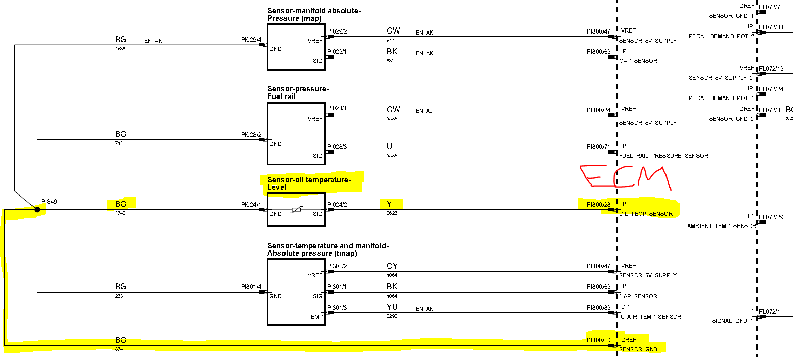

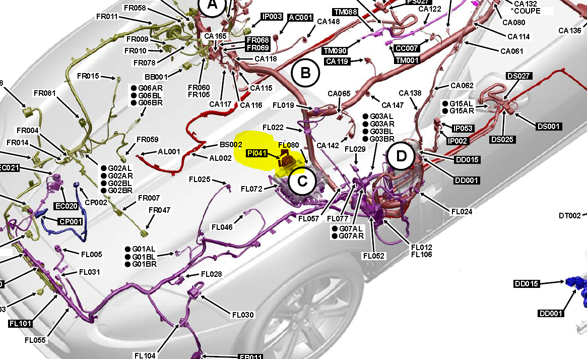

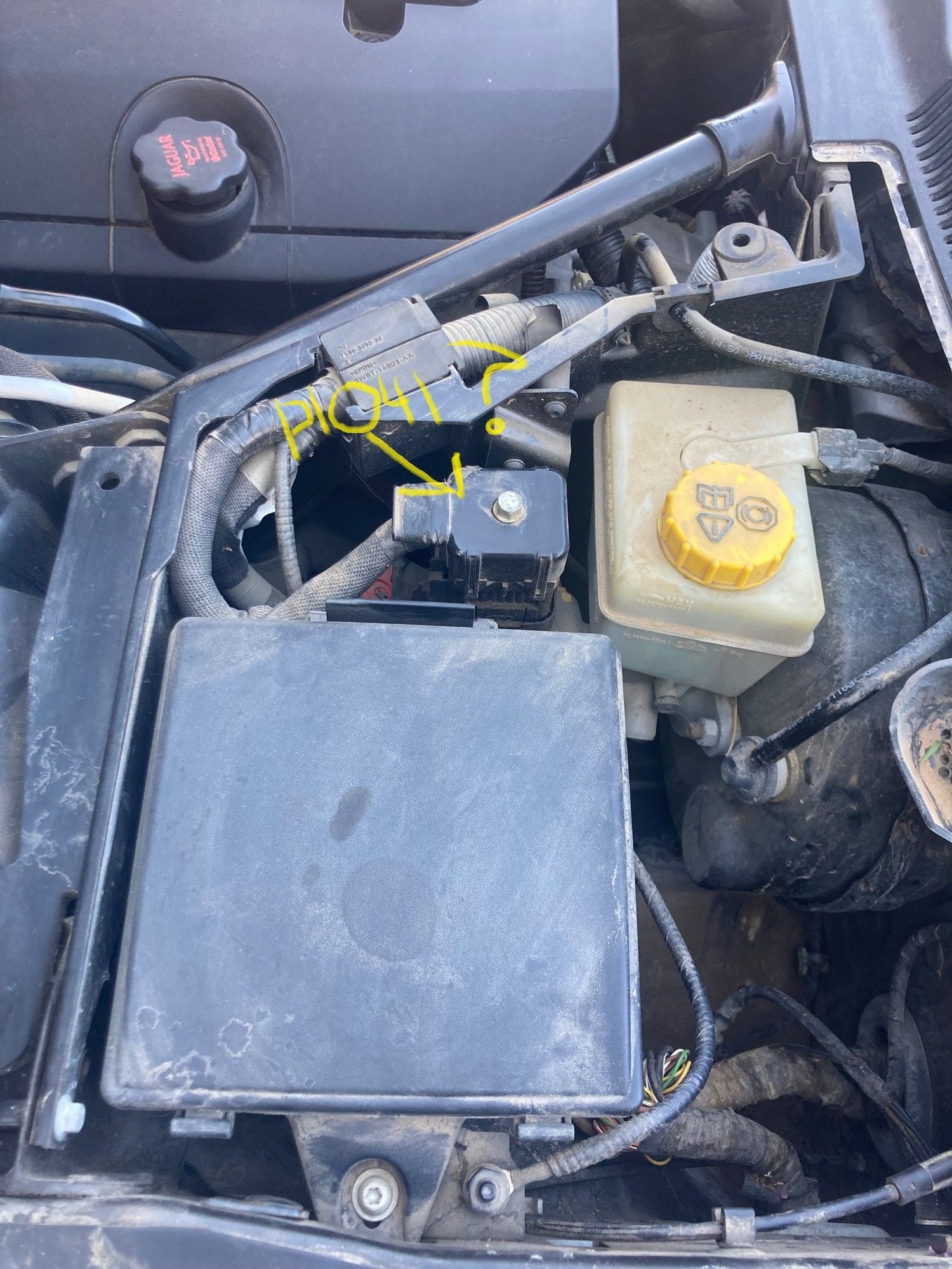

Easiest way I can think of to verify which BG wire goes where is to check for continuity with a multimeter between the Oil Pressure switch and connector PI041 pin 16. Please the various pictures below, I believe connector PI041 is the black cube connector I have pictured below, if so, do I disconnect it by unscrewing the silver bolt on top? Not trying to break anything! Thanks
Is this connector PI041?? If so how do you disconnect it? Do you undo the silver bolt on top? Thanks, don't want to break anything and cause further issues!

That would make it such as the second wire is merely a jumper to another connector.

Fixed the wiring, didn't even need to use the multimeter as the Oil Pressure has a thick black/green wire and the Engine Temp Sensor has a skinny black/green and yellow wire. Waiting on parts to fix the other issues!
