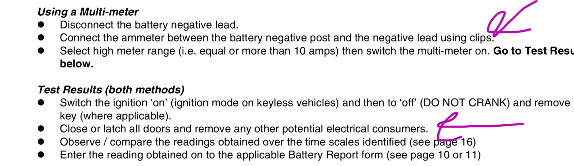

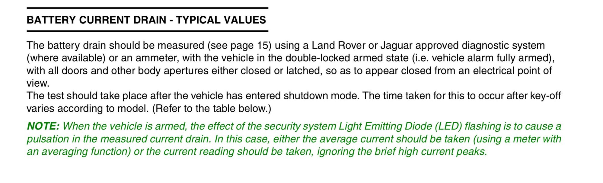

I am actually shocked having seen many threads about the alarm system, nobody measured the standard current draw for the alarm when operating as designed with no short or issues.
I’ll now be spending the next 10m reading the doc Sean shared, but on page 1 I found this comical:
Close/latch all doors. But measure at battery. Which requires the trunk to be open, especially on a convertible.
Yes I realize it is directed at mechanics who have SDD.
But for a multimeter, this is impossible:

Old Oct 21, 2025 | 06:40 PM
HealeyJag's Avatar
Joined: Mar 2025
Posts: 433
Likes: 265
From: Indialantic Florida
Default Brain
Originally Posted by Circumnavigator
I didn’t say no effects. It dropped from 12.57v to 12.49v in the second 24hrs of sitting.
Top down. Key fob sitting on the flat surface behind the psgr door.
Opened the trunk twice, but with LEDs in there doubt it drew much.
Love your engineer brain!!!
Ok, so it’s not telling you how to fool the car into thinking the trunk/boot is closed and latched, or how to run longer leads to the meter outside the trunk/boot, and close the lid on them? Easy enough to do either one, not rocket science.

Old Oct 22, 2025 | 10:35 AM
  #34
Sean W's Avatar
Joined: Jun 2013
Posts: 8,946
Likes: 4,747
From: USA
yep, also, open the door and physically close the latch while leaving it open. then press the lock button on the FOB. you've tricked you car into thinking the door is closed. Though I've never done this on the boot, I do it all the time when cleaning my interior. Easiest way to see that it's working after to physically close the latch with a flathead screwdriver. When you press the lock on your FOB, the dome light goes off immediately. That or just get longer leads as @kj07xk noted.
Old Oct 22, 2025 | 11:30 AM
  #35
Circumnavigator's Avatar
Joined: Feb 2025
Posts: 764
Likes: 355
From: Charlotte, NC
I was just nit-picking.
I’ve done it for the boot while I was hard wiring the Ctek and messing about.
Doing the doors just never crossed my mind.
Will test on t after my 3 days sitting battery measurement.
