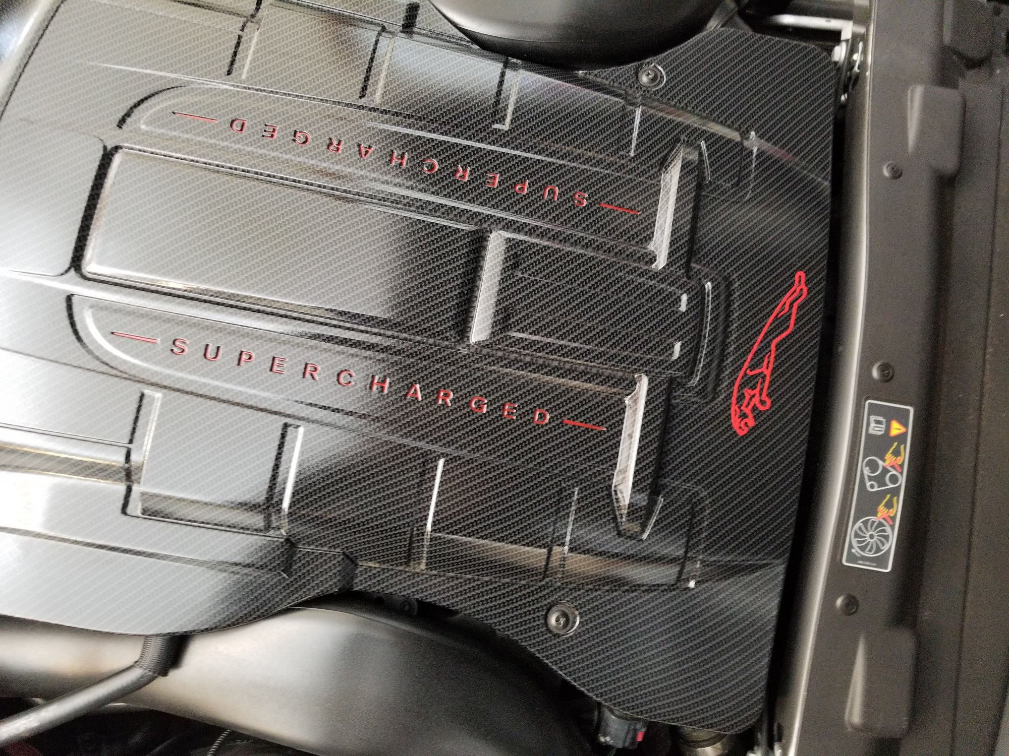

I always open the hood after I've parked in my garage to let the heat out of the engine compartment. That helps prolong the life of the rubber parts. But I won't remove my engine appearance cover cuz it's too pretty!
