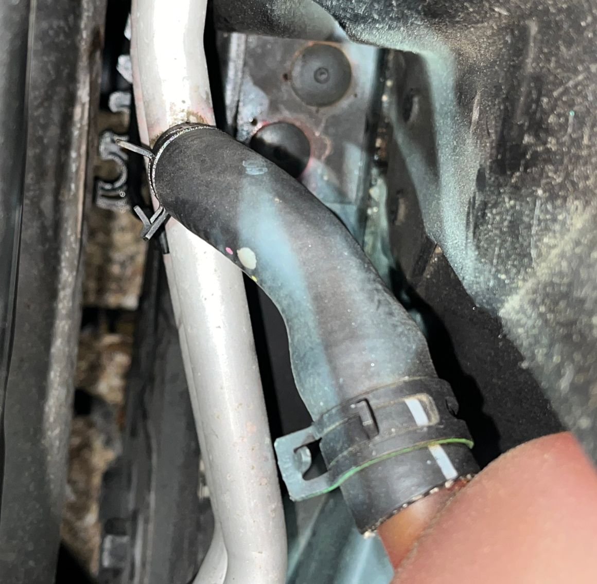

I have a leaking rubber hose that goes from the bottom of the over flow tank to a metal cooling.
The 4” rubber hose is part of the metal line. Jaguar states it’s discontinued at a cost of $448!
I am inquiring if anyone has replaced this short rubber hose and what vehicle that rubber hose was originally made for or any info available.
This is the leaking rubber hose

Think the part number is more than just that rubber piece, it includes the rest of the pipe too.
Not much help, but if you google the part number, you can find it for around $340 (like I said, not much help).

Yes it is the entire tubing and rubber hose. It’s crazy. I’m just looking for a fitment from another vehicle or some other option to replace that 4” rubber hose.

? its just a portion of a coolant hose. Why not just measure the diameter, walk into an auto parts supply shop and, replace it with a generic hose?
Myself, I’d walk into a marine supply as typically the hoses are better quality.

Yes, absurd that you would have to buy this whole assembly just for lack of a small hose. I replaced mine a while ago, using this scheme I posted few years ago. Note that this hose is of different diameters at either end, adding an extra dimension of "fun" to the project.
"...I got around this problem by using an old hot-rodder trick: find a smaller diameter hose that'll fit inside the larger diameter hose. It's a tight fit, and the clamp will further hold everything in place. I bought a hose at local parts store that had an assortment of various preformed bends (Dayco(?) / Davco(?) part number 8783(7) and cut out the suitable bend section that I needed, then jammed the smaller diameter hose in the appropriate end. Clamped down, and lasts to this day."

I woke up at 4 am this morning thinking the same process. Thank you for validating my thoughts. There is a hose shop in York by me that I’m hoping can get or have the processing equipment to make me a hose of the different diameter. The length is also a restrictive factor.

A Drayco bypass hose. A piece of 1/2 heater hose and a heat gun to make thing flexible.
thanks for the info guys.
