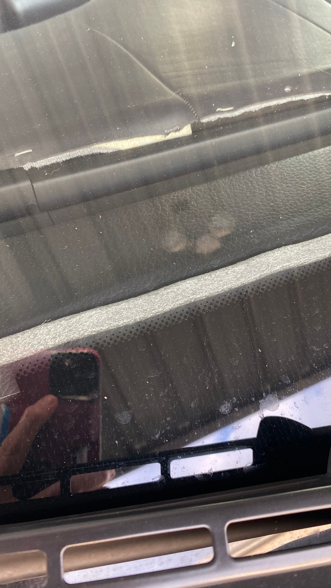

forgot pic of my dash issue and the color. Thanks in advance

This is how it starts for everyone. I assume that we're looking at the edge against your windshield. Once that edge is loose everything else happens. I am assuming as one forum member has done that you could just remove the windshield, have an upholsterer (or you yourself) use a long nosed air stapler and staple the folded down front edge to the frame from one side of the windshield to the other. Before doing so,lifting the leather from the dash to spray or spread a high heat adhesive, then stretching back to shape and stapling. The center grill speaker cover has to come out and the leather stapled to the frame in the little indentation all around. These staples will prevent the leather from ever shrinking down again. My dash looked much like yours, maybe worse, and it's been over seven years since we repaired mine and it still looks like the day it was done. I don't use a windshield cover, my car is not garaged, and the temperature in the San Fernando Valley for much of 6 months of the year is above 100*F during the day. With the dash removed as I didn't know at the time we removed it that the repair would be so simple (I thought we'd be reupholstering it), the repair took my upholsterer less than 1 hour to fix, and my mechanice re-installed the dash while he was doing other cosmetic upgrades to my car. Another forum member contacted me for some of the leather braid to cover the staples, this morning. I know I have some laying around the house somewhere, and I am going to look for it over the next few days. When I find it, if you need some let me know, and I'll be happy to send you some from my leftover stash.
