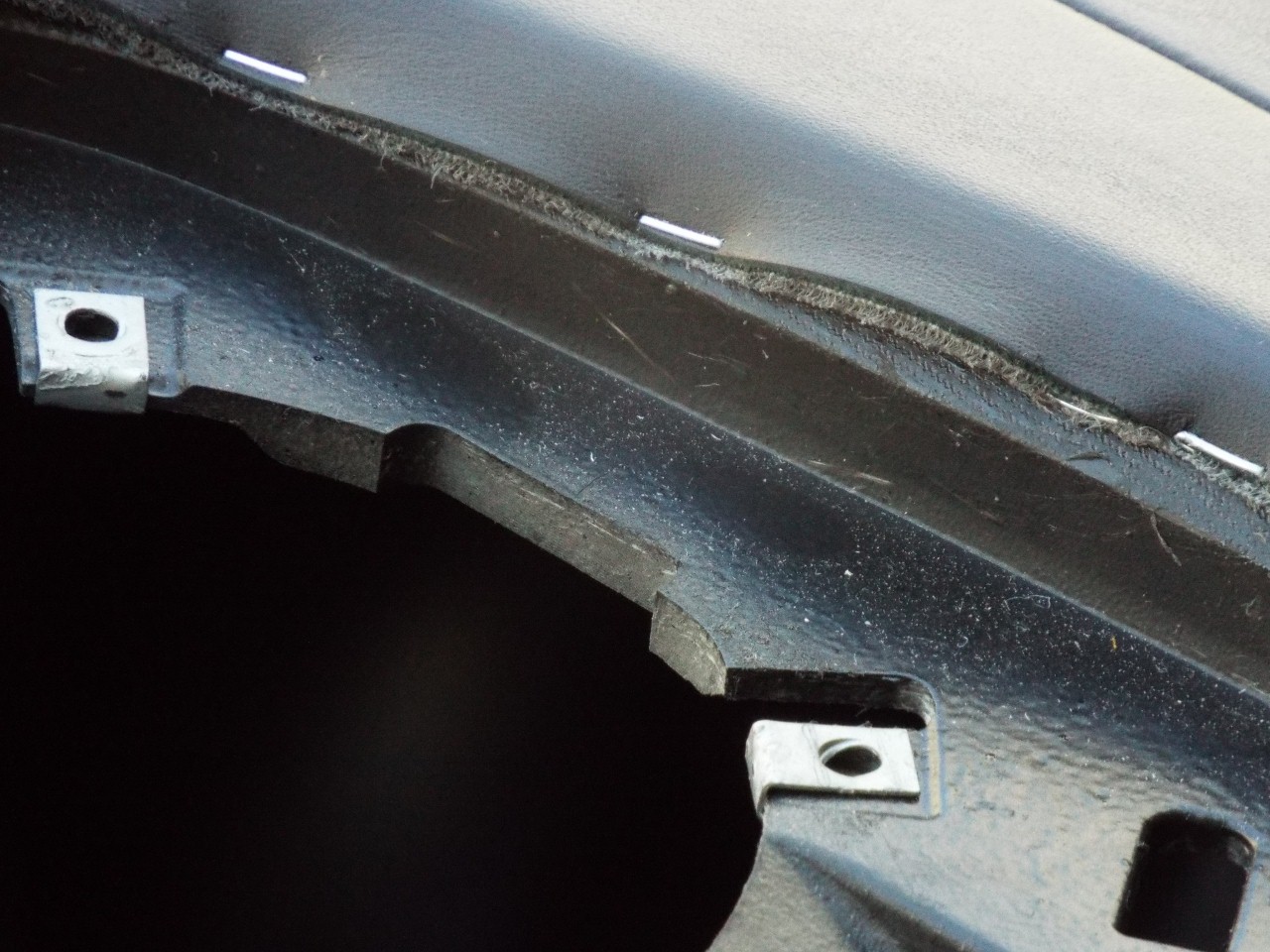

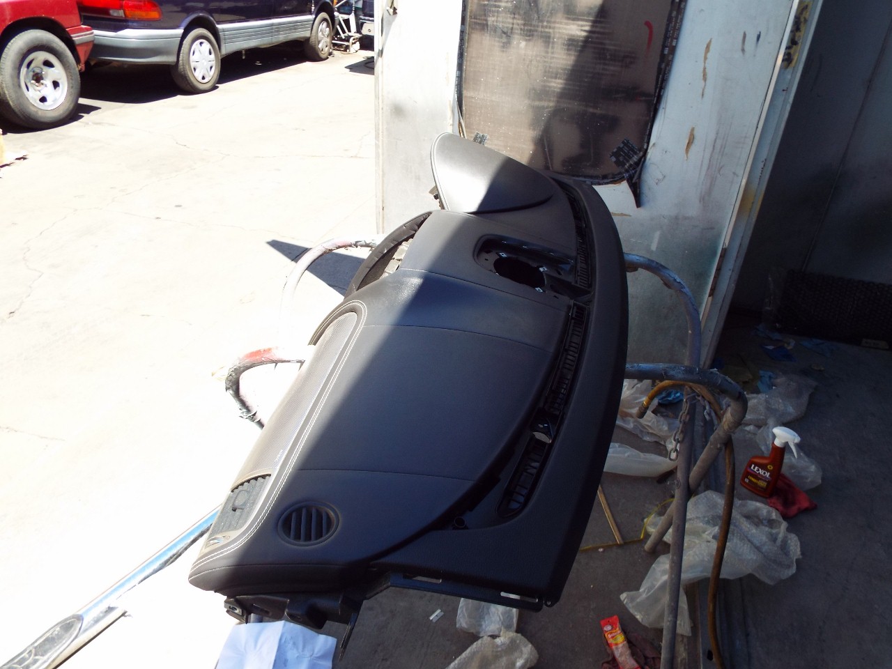

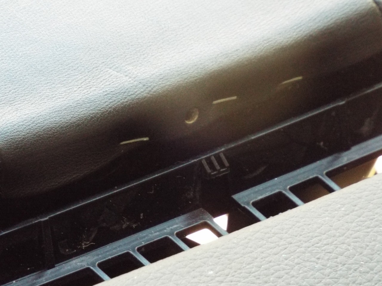

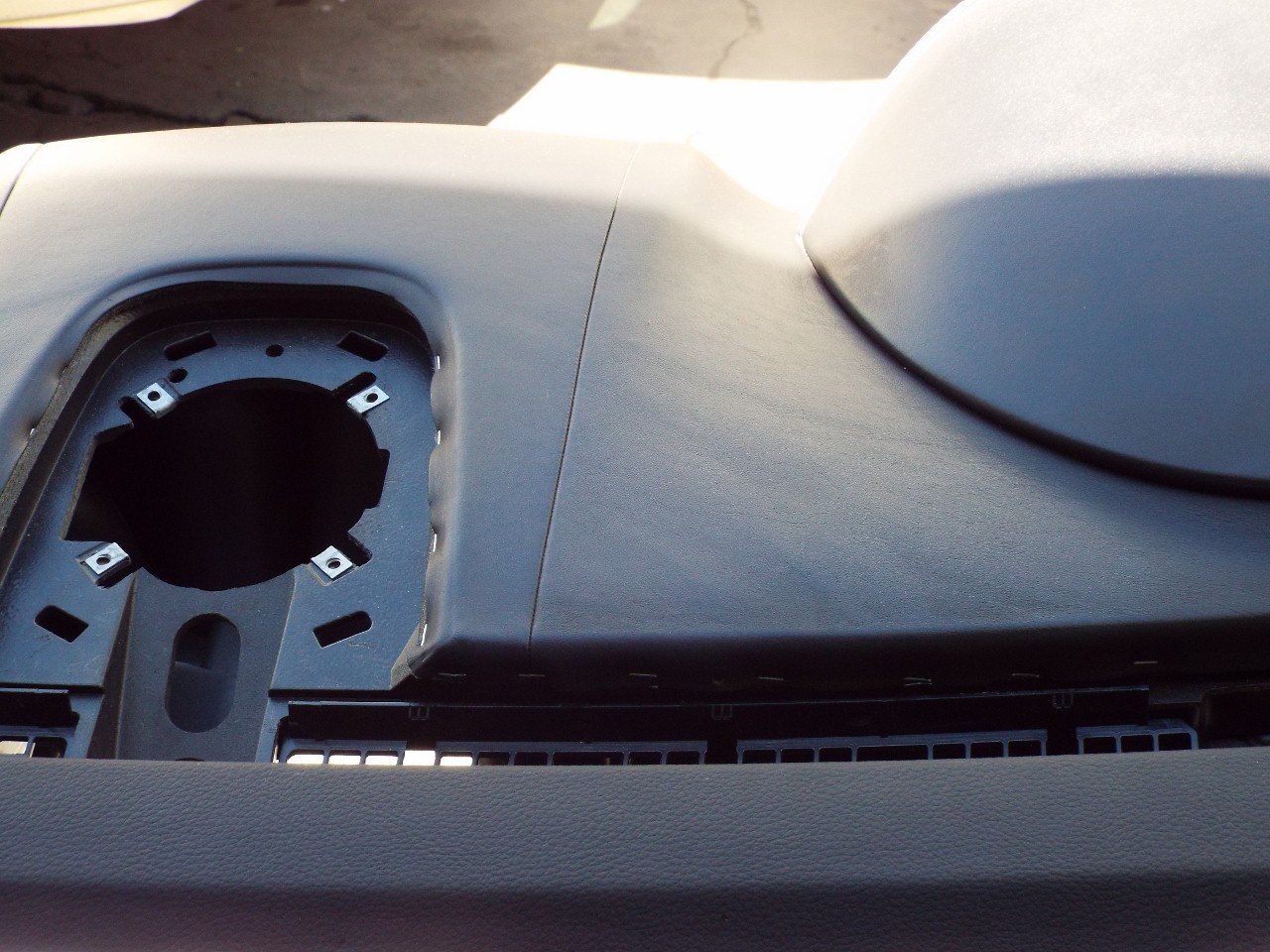

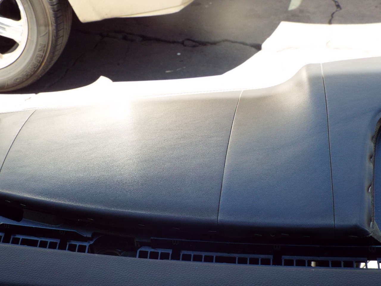

Well I've just returned from picking up my dash and........
it's perfect! It looks like new, even on the driver's side where there was rippling due to the backing not being bonded properly, it is virtually imperceptable. I can see very faint traces of where the ripples once were, but I believe even these will disappear once it has been "stretched" out for a longer period of time. Airbag bubbles are gone and the sloped areas leading down to the nav screen are once again attached solidly to the frame. These areas were not even touching the frame and could be pushed down more than a 1/4" with air in between.
My upholsterer used an automotive adhesive called Super Tack ST-230 whose description on the packaging says, "Top and Trim Adhesive--High Heat Resistance." Additionally, he stapled down the leather to the edges of the frame as well as around the center speaker. He also told me that he believes Vic's (TopsOnline) has an even stronger automotive adhesive, but he had this one on hand and has had good success with it.
When I asked him for a bill, he wanted nothing, however I gave him $100 anyway for his time.
The first thing I did was slather Lexol conditioner on it (a lot easier to get to all the little nooks and crannies when the dash isn't installed), which I'll do after the dash is re-installed and I get the car back from it's other work.
Frankly, I'm pleasantly surprised (more like stunned). Now the questions is how well it will hold up. To be continued....
