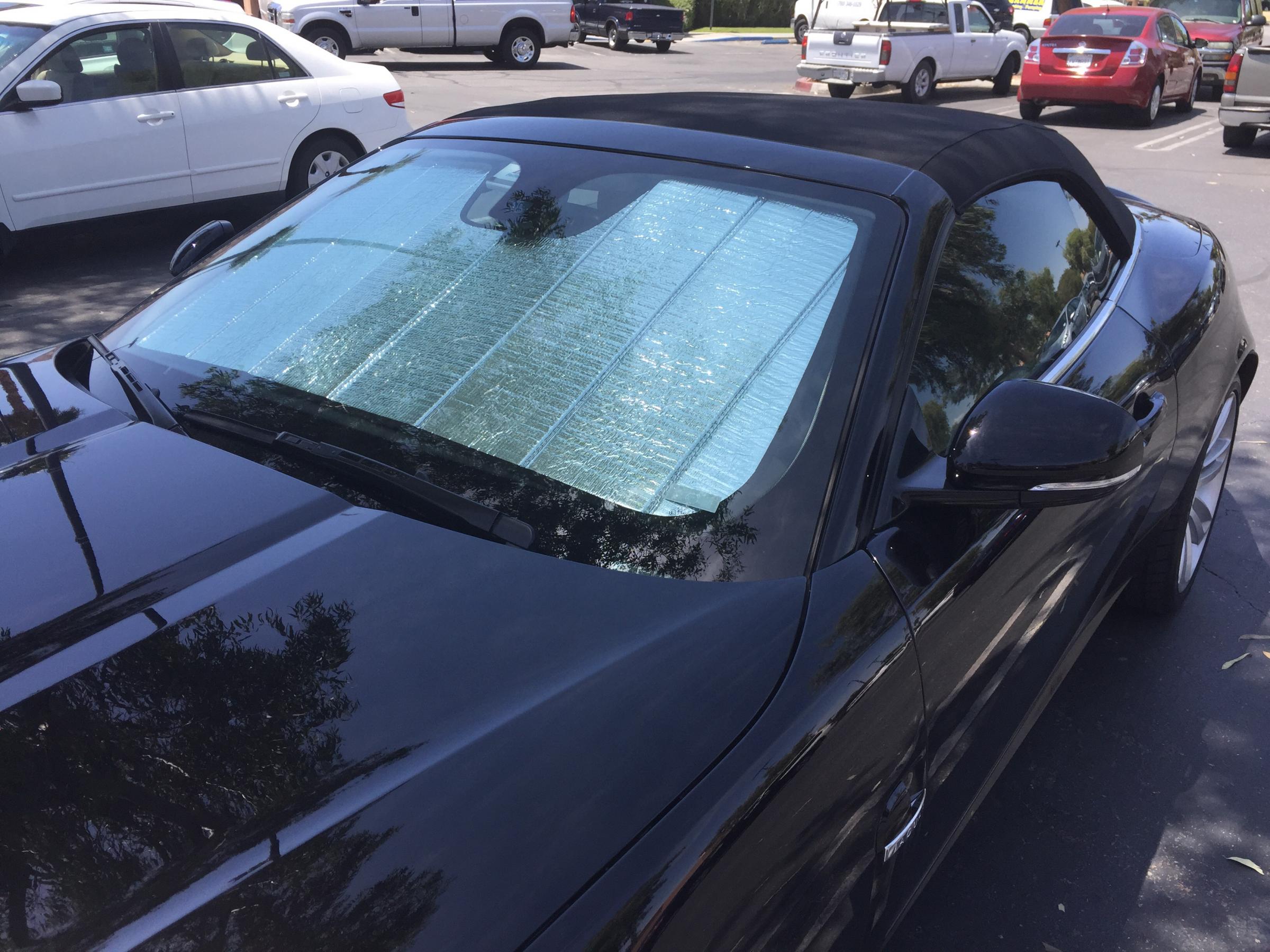

As a low desert resident where it is always sunny and almost always hot - the solution is a simple one. Custom made sun shield. Every day. Every time it is parked in the sun. + regular and liberally applied leather treatment. So far my '11 XKR shows no signs of shrinkage.

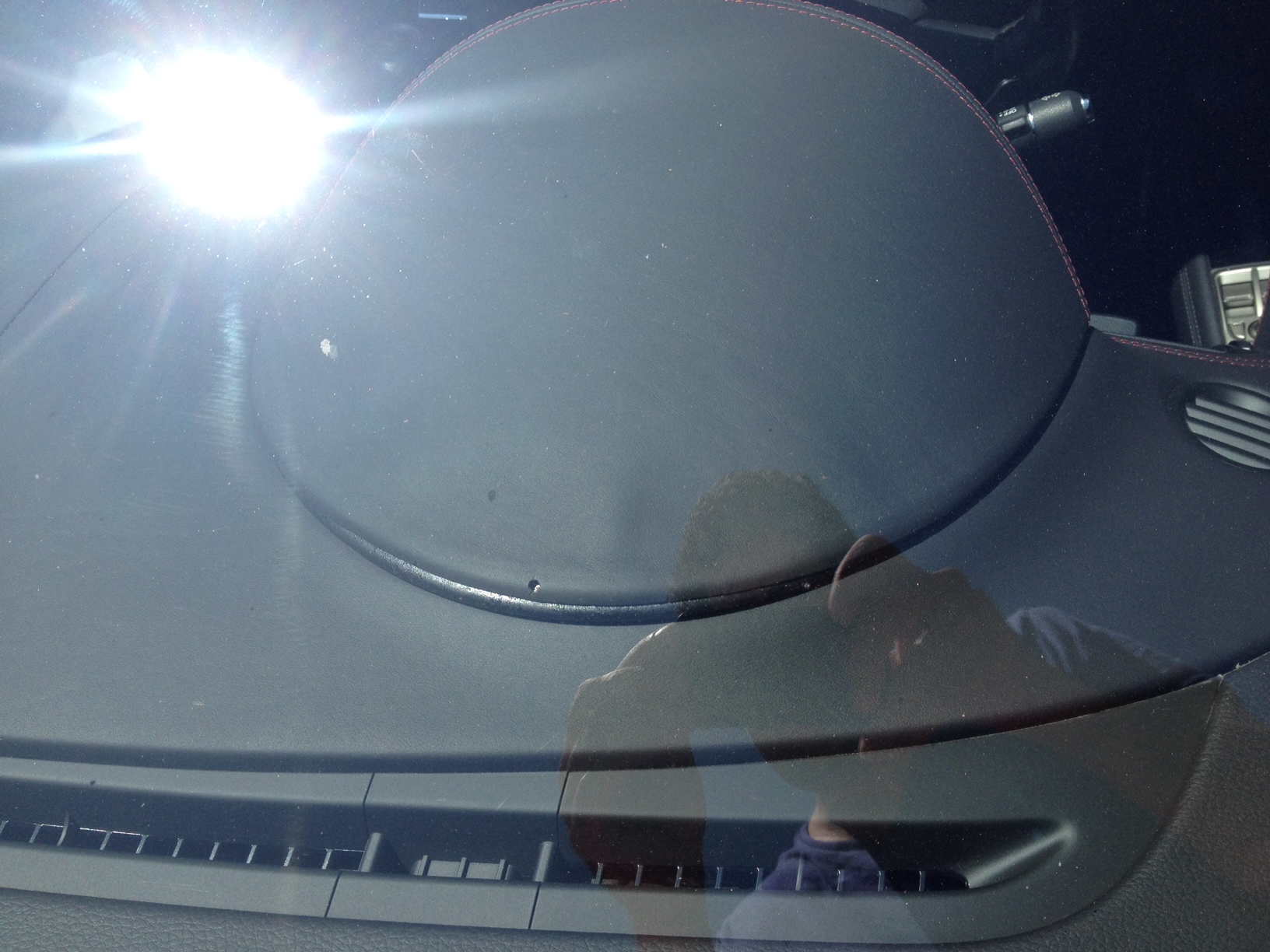

Attached is a picture of where my dash leather is shrinking. It is only over the portion of the dash covering the speedometer/Tach.
I purchased this 2011 6 weeks ago and the vehicle is CPO through 2018. I noticed the black plastic trim where the leather pulled the day the car was delivered but silly enough thought that it was designed that way until reading this thread. Obviously the Jaguar dealership missed it during CPO process along with my independent inspector who was detailed enough to notice the vanity mirror light was not working on the passenger side.
I purchased the car in Texas and Live in CA. I took the car to Hornburg of Santa Monica and the service rep. immediately said not covered because the shrinkage constituted normal wear and tear.
Jaguar NA touts the CPO program for it detailed inspection and repair of the vehicle, including interior, prior to certifying. So I think JNA may be on the hook. Regardless, like many of you, I do not believe this is normal wear and tear, but more akin to failure of a part or defective manufacturing. What are your thoughts? Secondly, does anyone know if the dash is one piece or in the alternative this piece can be removed separately? If it can easily be removed, I may not want to invest the time and energy in a fight with JNA and instead have it repaired myself. Other than this problem, the car is amazing!!!
Thanks to all of you for all the great information you provide.

Sent you a PM, but it's ridiculous that a CPO car isn't covered for a well known issue. Go above Hornburg. However I think there may be a reasonably easy fix for this particular type of shrinkage.
Ted
