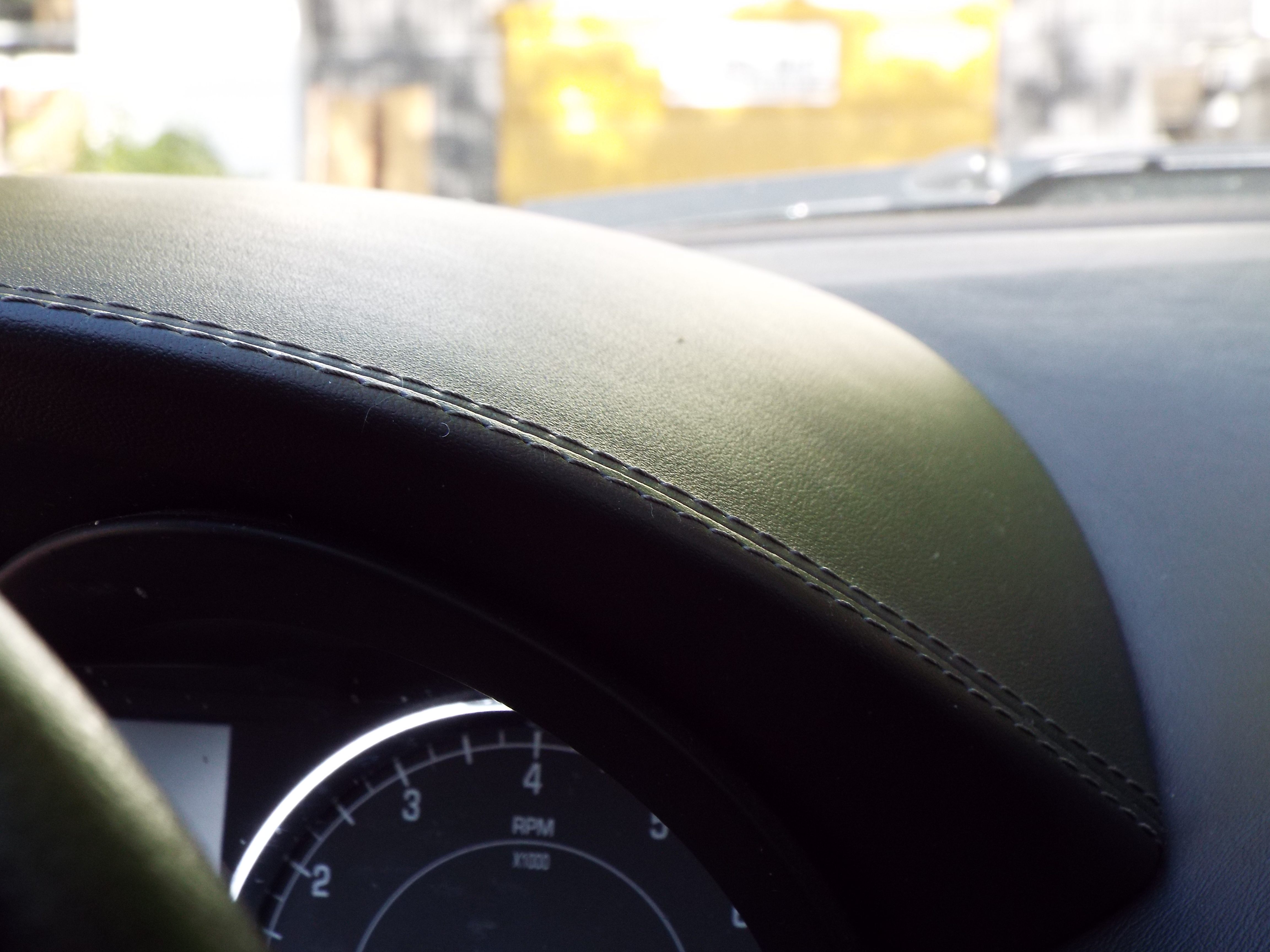

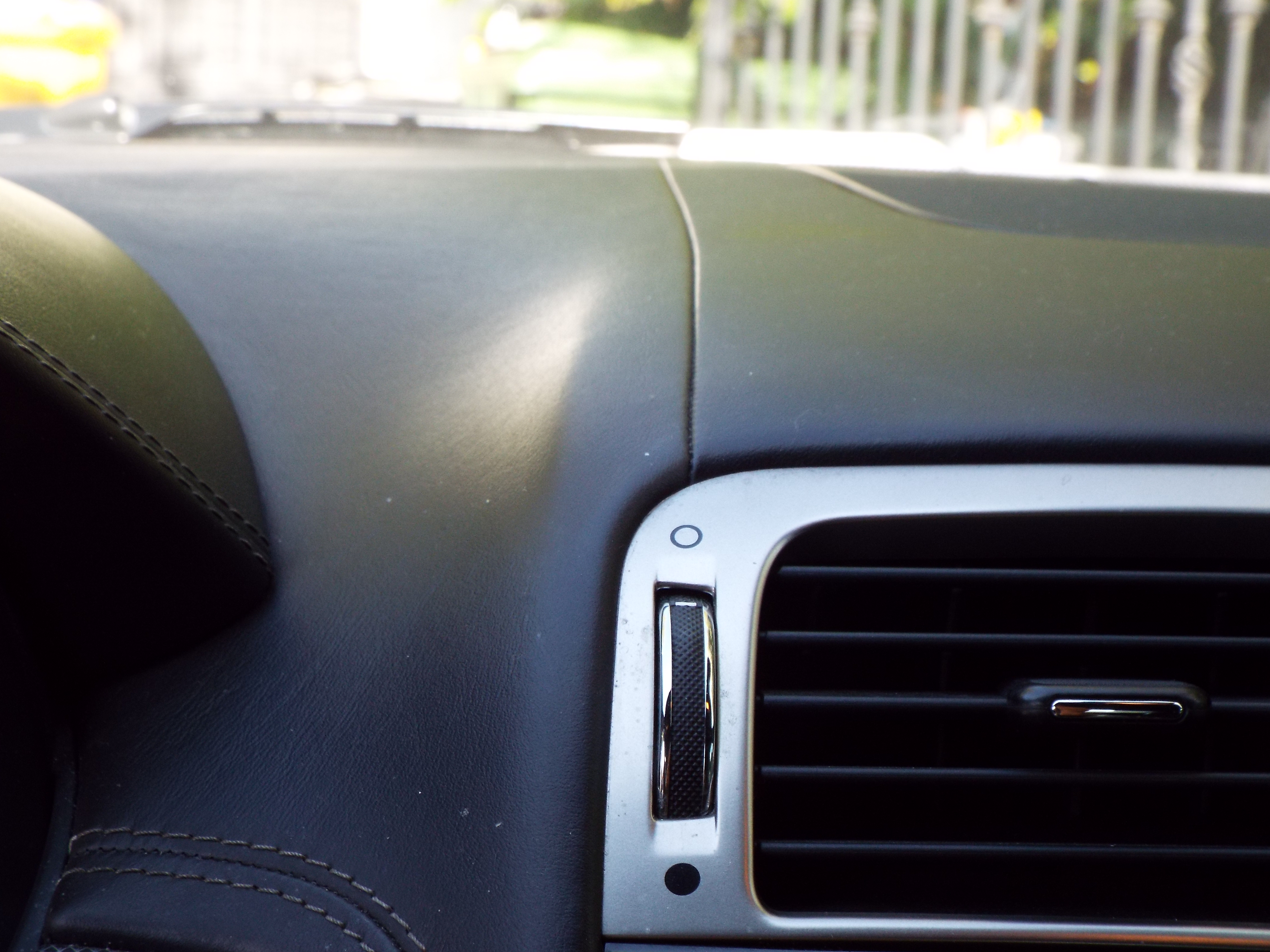

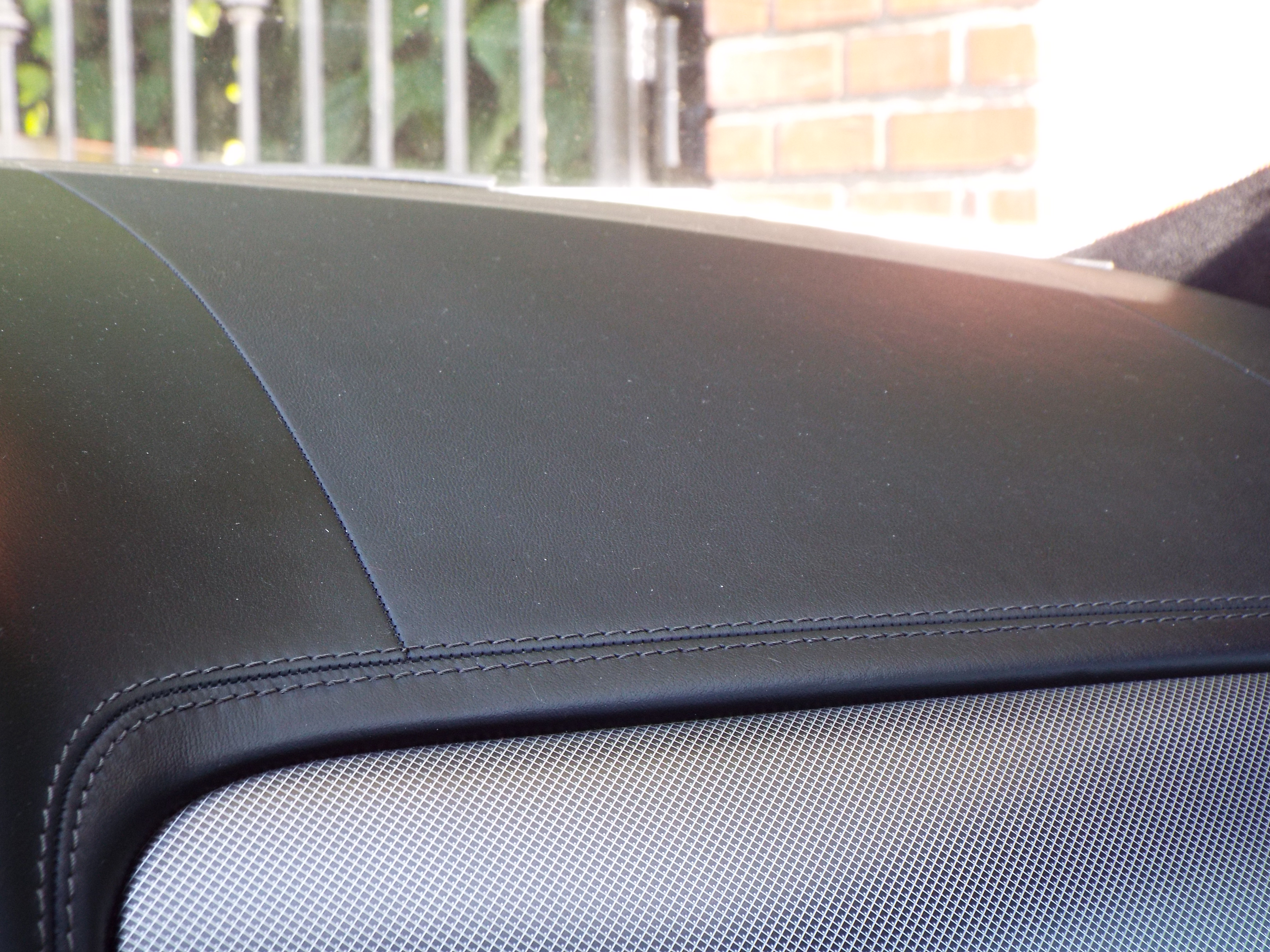

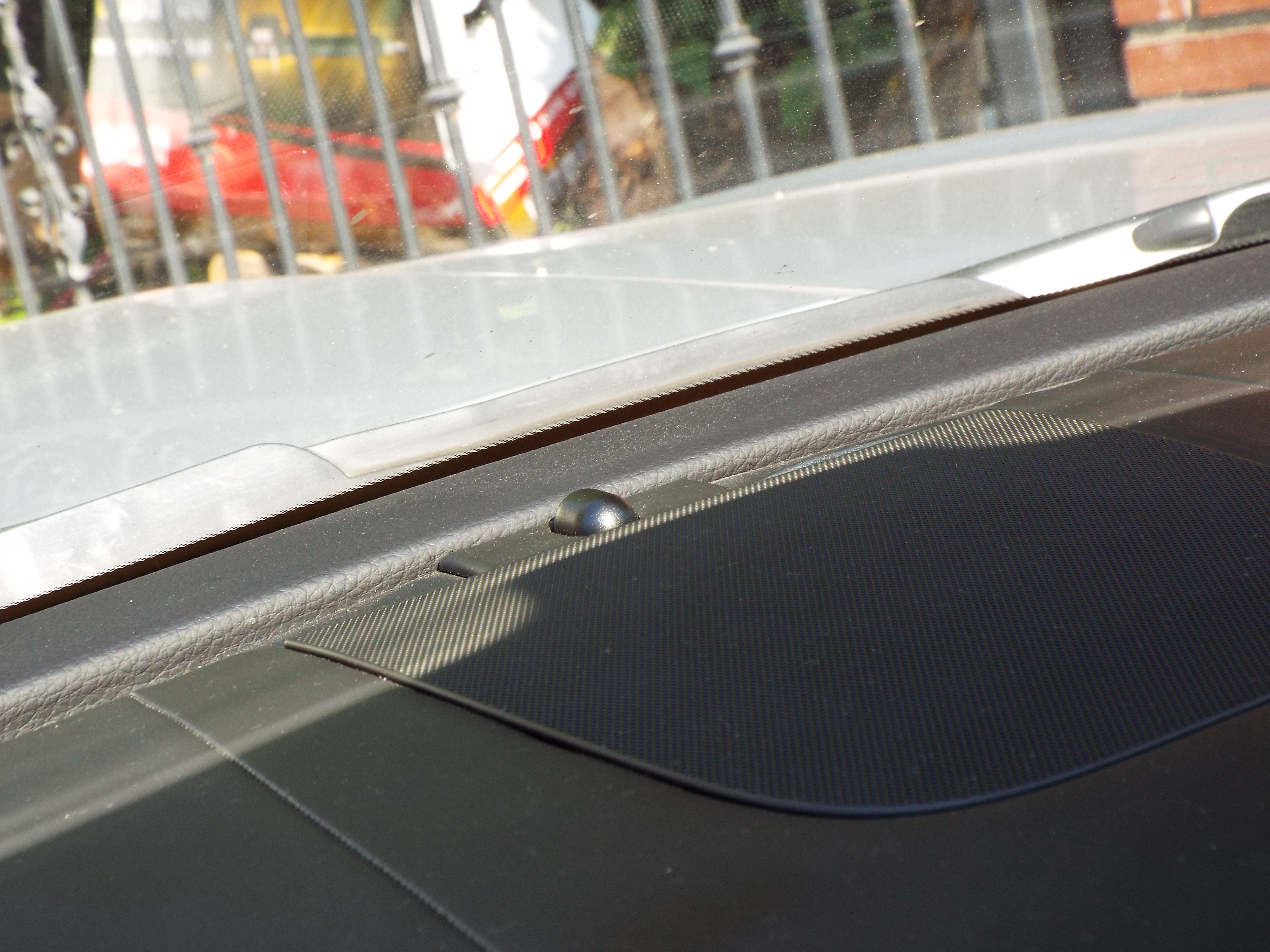

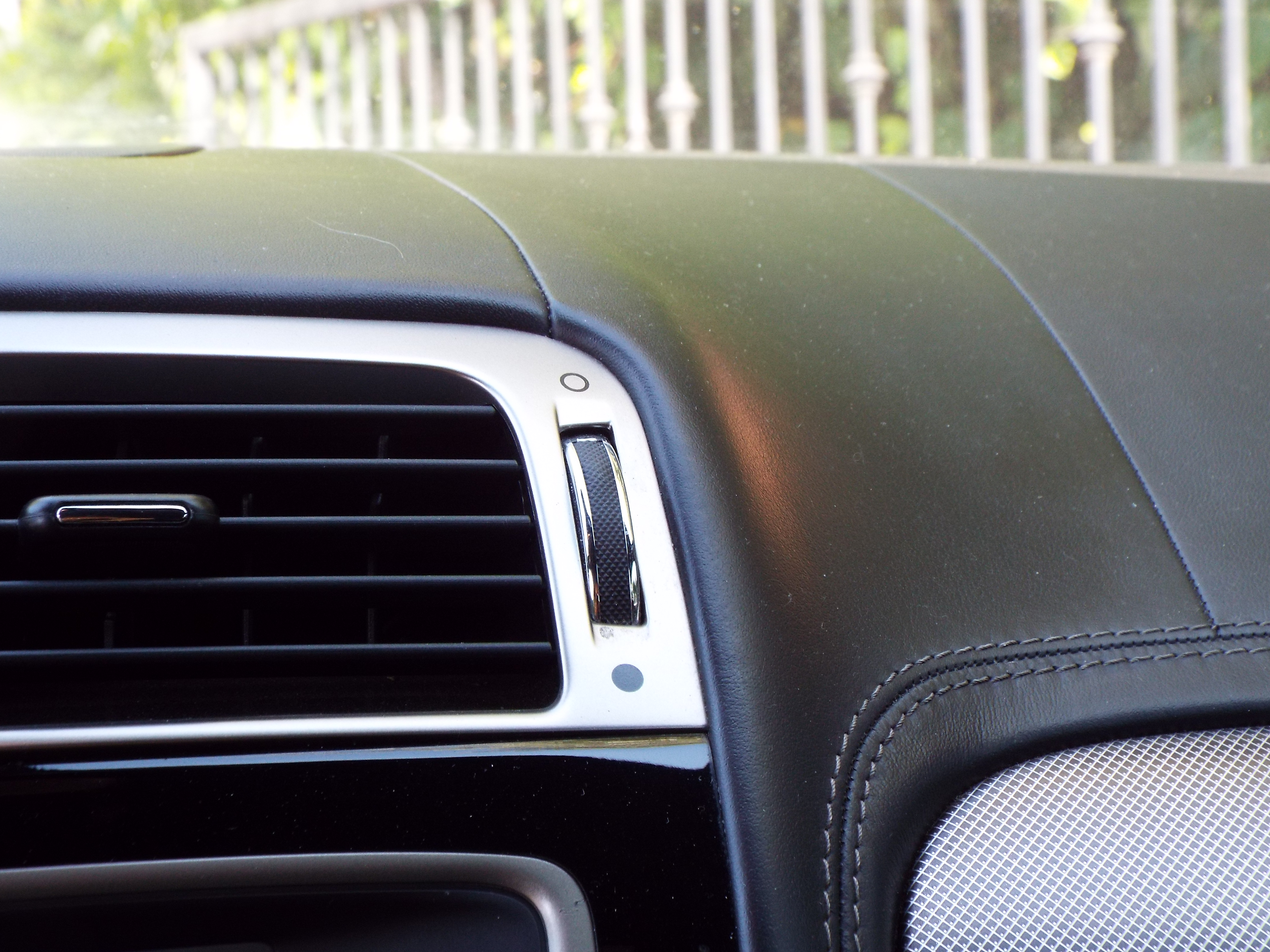

tberg's Avatar
Posts: 5,008
Likes: 2,623
RobB (and anyone else who thinks jerome's solution will work),
Unfortunately jerome's solution which is to restretch the leather, tuck it back to the lip of the dash in front of the windshield with a spatula of sorts, will not be a permanent, nor even a temporary solution to this problem. Through the hundreds of posts on this subject on both the XK/XKR and XF forums, outside of getting a dealership to replace the dash under warranty, apparently no one besides me has successfully repaired their dashes. There is NO SCENARIO, NONE! that will provide a permanent solution to this problem without anchoring the leather to the frame via staples. PERIOD! There are no "clips" to which the leather was originally attached, there were no magic fasteners, there was just glue. Jaguar did not even provide enough of an overlap of the leather to wrap around the underside of the dash where it might have helped to keep the leather from creeping up. The pictures on my early posts on this subject show the lack of any fasteners. I was fortunate to have a mechanic/body shop with whom I do a lot of business, take the dash out for me, so that I could repair it properly. The only other possibility without dash removal is windshield removal. I believe that with the glass removed, a long nosed air stapler can reach the lip at the back of the dash as well as around the center speaker. With glass out, the leather should be able to be pulled away from the foam, restretched, regued, and finally anchored/stapled to the frame. The removal of the windshield shouldn't be more than a couple of hundred dollars including re-installation as I have had it done on my other XKR by Safelite, and it was $225 including a new windshield. Everyone seems to have a theory about how to come up with an easy solution to this very common problem, but no one has actually done it and had a successful outcome besides me. As I've previously stated, I repaired mine more than 3 years ago, and there has been no change in its appearance since then. My car has never spent a night in a garage (during my ownership), is subject to temperatures in the San Fernando Valley that can reach (as it did one day this past summer) 120F, and which are typically between 90-110F from June through the end of October.
I am going to walk out to my car right now, take some photos, and post back in a few minutes to prove the point.
The solution is not rocket science but still has to be done correctly to work.
Old Jun 2, 2017 | 07:39 PM
  #279
tberg's Avatar
Posts: 5,008
Likes: 2,623
Okay, below are some closeups of my dash. It was too sunny for the pictures from outside the windshield to turn out, so these will have to do for now. I wanted to show it from the outside, because as previously posted, so that the staples would not show to the outside of the front of the car, I glued a half inch black leather strip that matched the dash perfectly to the front lip. I will take those photos another time. If you look at the photos of my dash, you will see that the molded areas that slope down from the sides of the center speaker are perfectly tight (previously I had the typical air pockets), the area surrounding the center speaker is tight and flat, and the cover over the passenger airbag (which on my car was not attached at all, it flapped around like a flag in the breeze) is perfectly fitted. All of this accomplished with a little bit of adhesive, and a couple of dozen staples, and that's it. And there is no other way.
Attached Thumbnails Leather on dash 'pulling'-dscf8371.jpg   Leather on dash 'pulling'-dscf8372.jpg   Leather on dash 'pulling'-dscf8373.jpg   Leather on dash 'pulling'-dscf8370.jpg   Leather on dash 'pulling'-dscf8369.jpg
