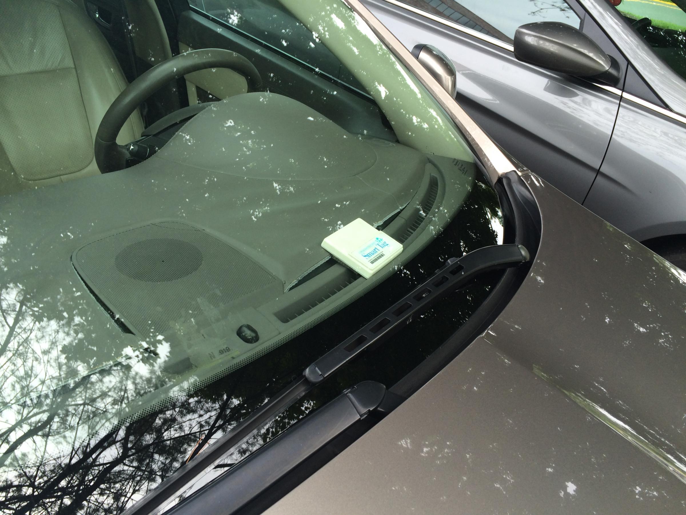

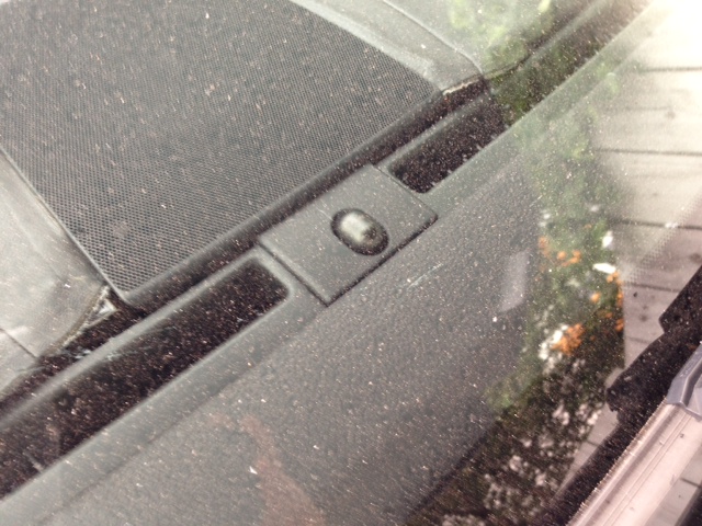

glad you were able to get it fixed. Now only I could find a shop like that in the MD/VA/DC area. Mine is terrible. Probably the worst pics on here. Raised issue with Jag NA and they are willing to cover 1/2 the cost. Dealer will replace for $3K so that still leaves me with a $1,500 tab. Still unfair because for their defect product. And as Cancre stated, you can't even get a confirmation that new dash will have staples. I'm willing to try an upholstery shop at this point. Any recommendations in the MD/VA/DC area? thx

What is the year of your XK, and how long have you owned it -since new? Your dash looks almost the worst of all of the pictures I have see. When did you first notice this? You don't even live in a extreme climate and to see this much damage is disturbing. Are you still under the original warranty or the Jaguar CPO one?

It's actually a 09 XF SC. I bought it at 40K 3yrs ago and noticed a bubble on dash but didn't realize what was happening until the grill on the speaker on dash cracked and it has deteriorated since then and that's what will happen if you don't get it repaired with the new dash with staples. By then I was over 50K so outside the warranty. I discussed with dealer at that time and they quoted me at $4k to repair. I don't have the CPO warranty. This is my 2nd Jaguar and can't believe they won't issue a recall. I mean, it can become hazardous if it continues to rip and obstruct the drivers view, right? That's what the rep stated.. "it's not a safety hazard", but I beg to differ. I'm sure me trying to glue it down won't help. Dealer rep stated that he thought Jag NA paying 1/2 the cost was a good offer based on year of car (2009) and mileage. I'm now over 100K but this has been there since 40K.

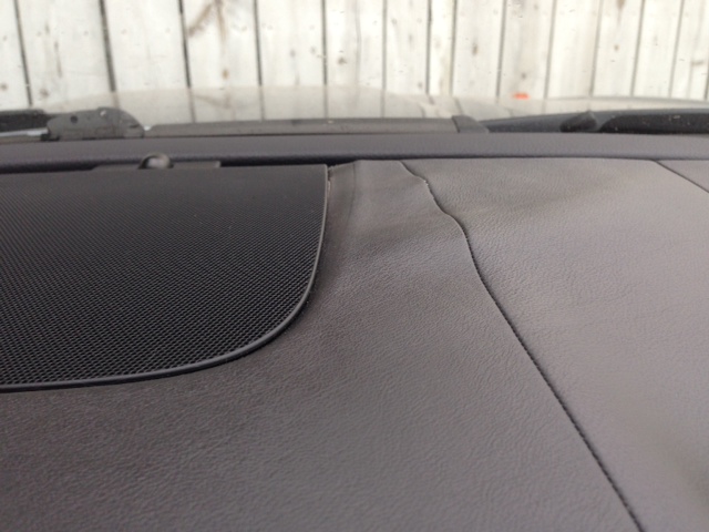

There are many car makers that have put together long lasting dashboards as well as many that continued to have prolems for years, and some, like Jaguar, that have done both. My 2002 XKR has over 150,000 miles (and my 2002 XJ8 is similar), spends its days baking in the heat of the San Fernando Valley everyday (typically at or over 100F through the summer and fall), and is never garaged at night, and its dash looks brand new. My 2010 XKR with the leather dash, prior to me having it fixed was a mess. I bought that car used and it had the leather dash option, it would not have been my choice were I to have ordered a new car.

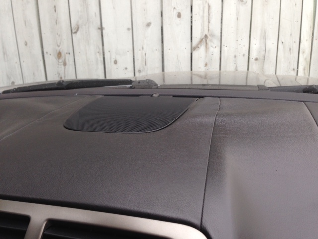

For those of you who proceed to remove your dash and have an upholsterer re-glue and staple to repair it as I have done, you will have one final issue which is that since there isn't enough leather to wrap around and staple on the underside of the actual dash "board," the staples are on the front edge of the board and show when you're looking in from the windshield. And the plastic defroster inserts don't extend high enough to cover them. I searched and found some 1/2" foldover leather that is a perfect match to the black (warm charcoal) dash both in texture and color. If glued to the front of the dash edge it will cover the staples and simply disappear. I will have photos when I get my car back from its modifications next week. Since it was so inexpensive, I purchased a small role of it and will have enough leftover to do anywhere from 5-7 more dashboards. For anyone who needs this edging to complete their repair, I will be more than happy to send you what you need, free of charge. Had I known I would find an exact match, I would have installed it before we put the dash back in, but there is room to squeeze it in place before the defroster trim piece goes in.
Let me know if any of you need some.

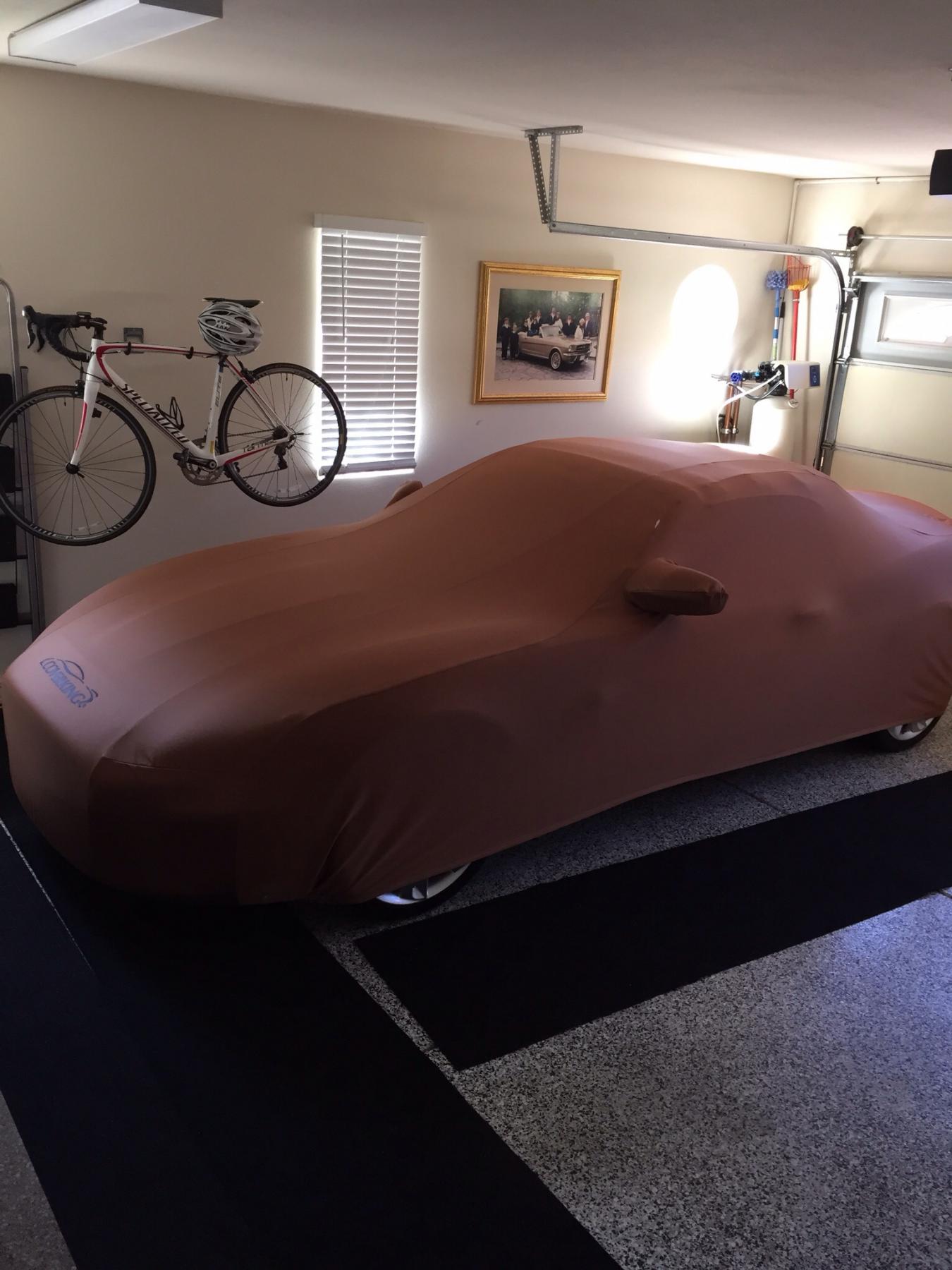

Old Jan 7, 2015 | 11:45 AM
  #219
Ceckman's Avatar
Joined: Jun 2014
Posts: 165
Likes: 46
From: La Quinta, CA
OK you've all succeeded in moving me towards paranoia.
The garage is heated / air conditioned.
I have clay barred, carnauba waxed and spritzed with detailer.
The dash / interior is glowing with a fresh coat of Lexol.
The custom sun shade is in-place.
The Ctek Charger is attached.
The tank is full of fuel stabilizer.
The tires are slightly over-inflated.
The custom fleece lined cover is on.
I'm exhausted and scared to take her outside!
