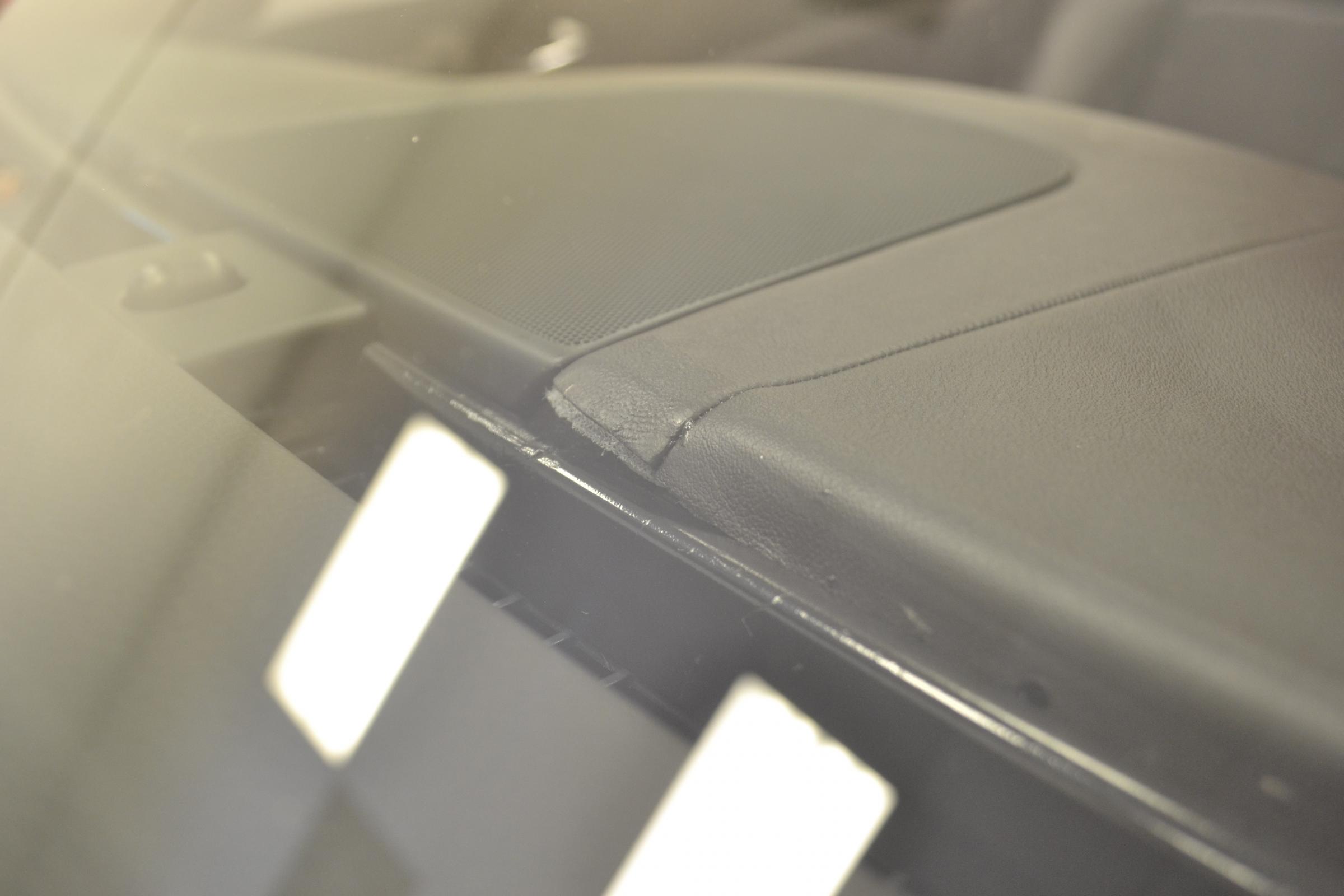

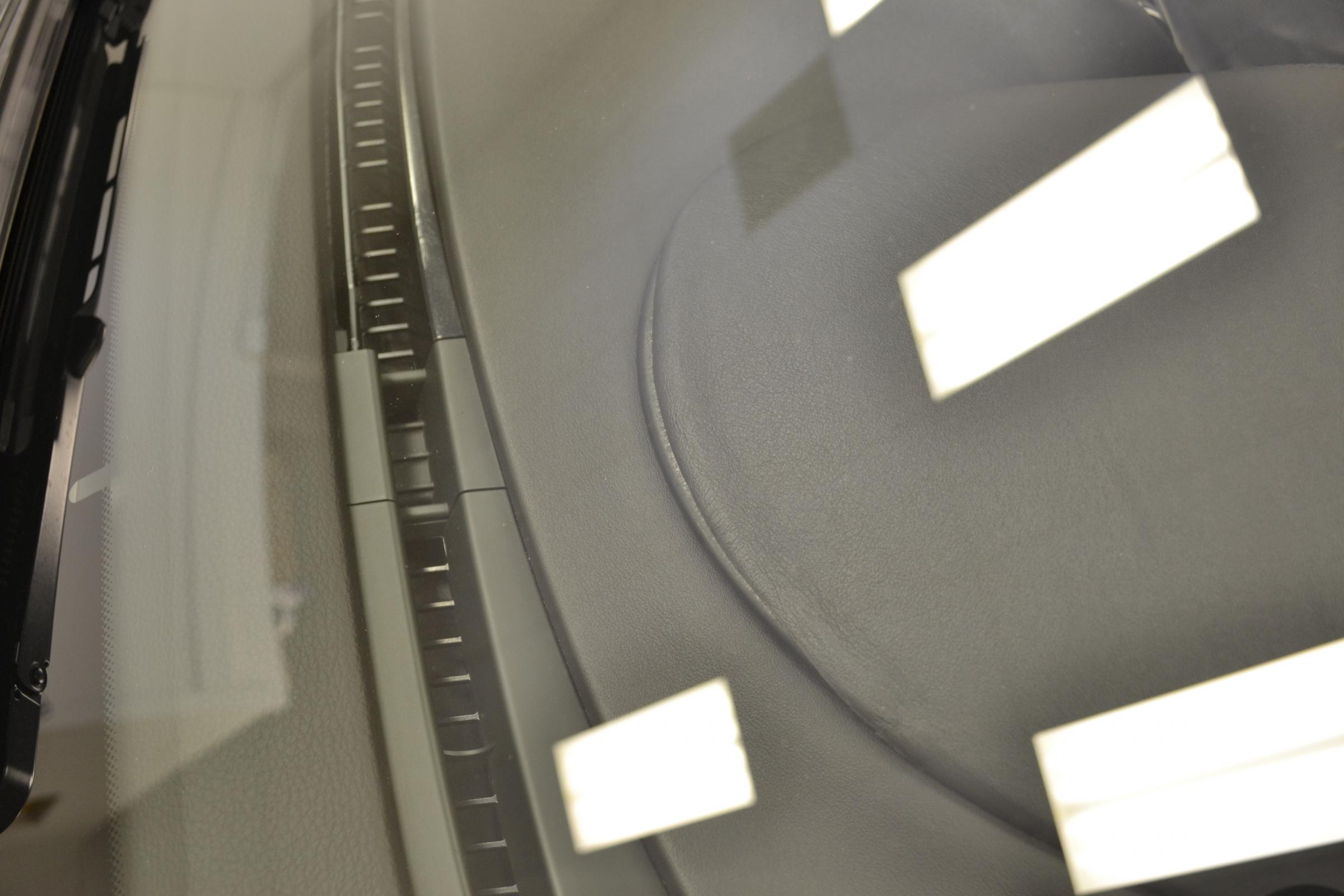

Here are a few pics I snapped minutes ago:
Mmm, looks expensive!
The leather on the gauge hood is retreating faster than a French soldier!

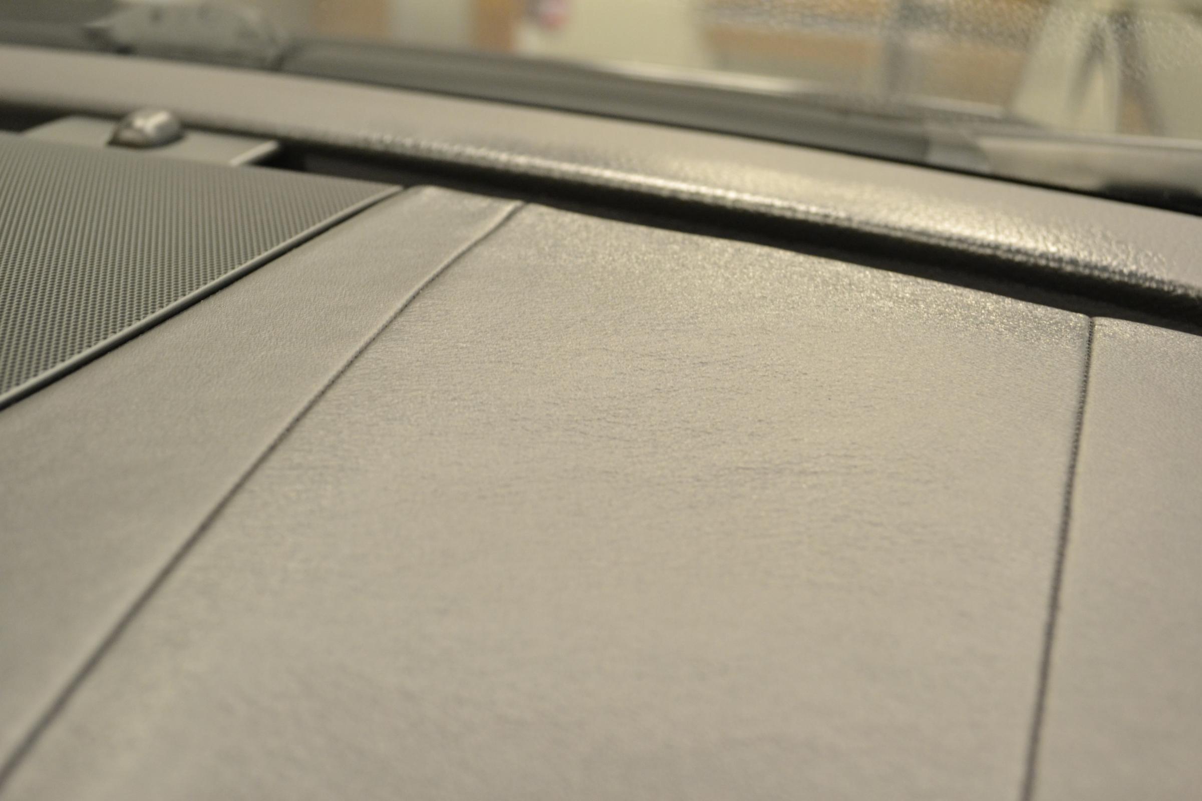

And, my favorite: the air pockets. (One can hide treasures in there!)
Okay, so here I am showing you just how far the leather has receded from the leading edge of the dash frame. You can see the shaped corner from the original application, and you can see how far from the corner is has moved. It's like a tectonic crawl--but on the dash of my beautiful kitten.
The arrows are pointing out the odd, shiny 'goo' that was left behind from whatever the dealership used to stretch the leather. I will be attempting to remove this today. Note: when I took delivery of this car the leather wasn't even adhered to the leading edge of the dash frame; I glued it down.
