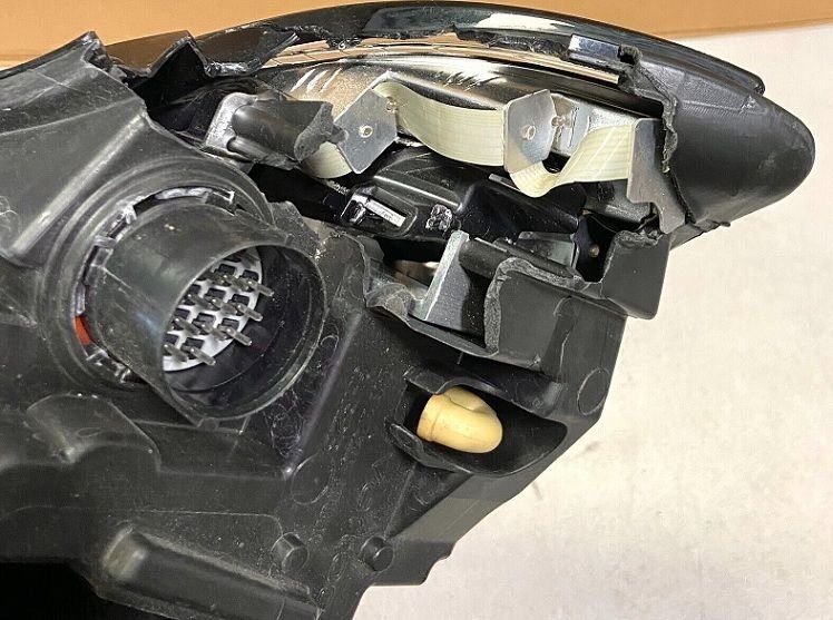

Sorry these are sealed lights and I have been following the few repair attempts that have been made. So far not much has been done because separating the lens from the head light is very difficult. I don't see anyway of inspecting or repairing the LED's until this can be done without inflicting further damage to the assembly. Remember it has to be put back together in the end.
So first do no harm!
Here is a broken light on EBay and that shows a bit of the inside of the light.
Broken XK Head Light
This picture at least gives you what the LED's look like inside the light. Even broken and unusable the guy still wants $400!
Good luck and I would be interested in how you get this repaired if you do.
