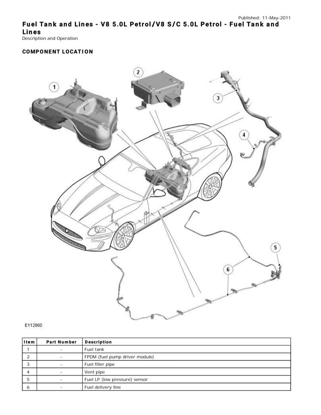

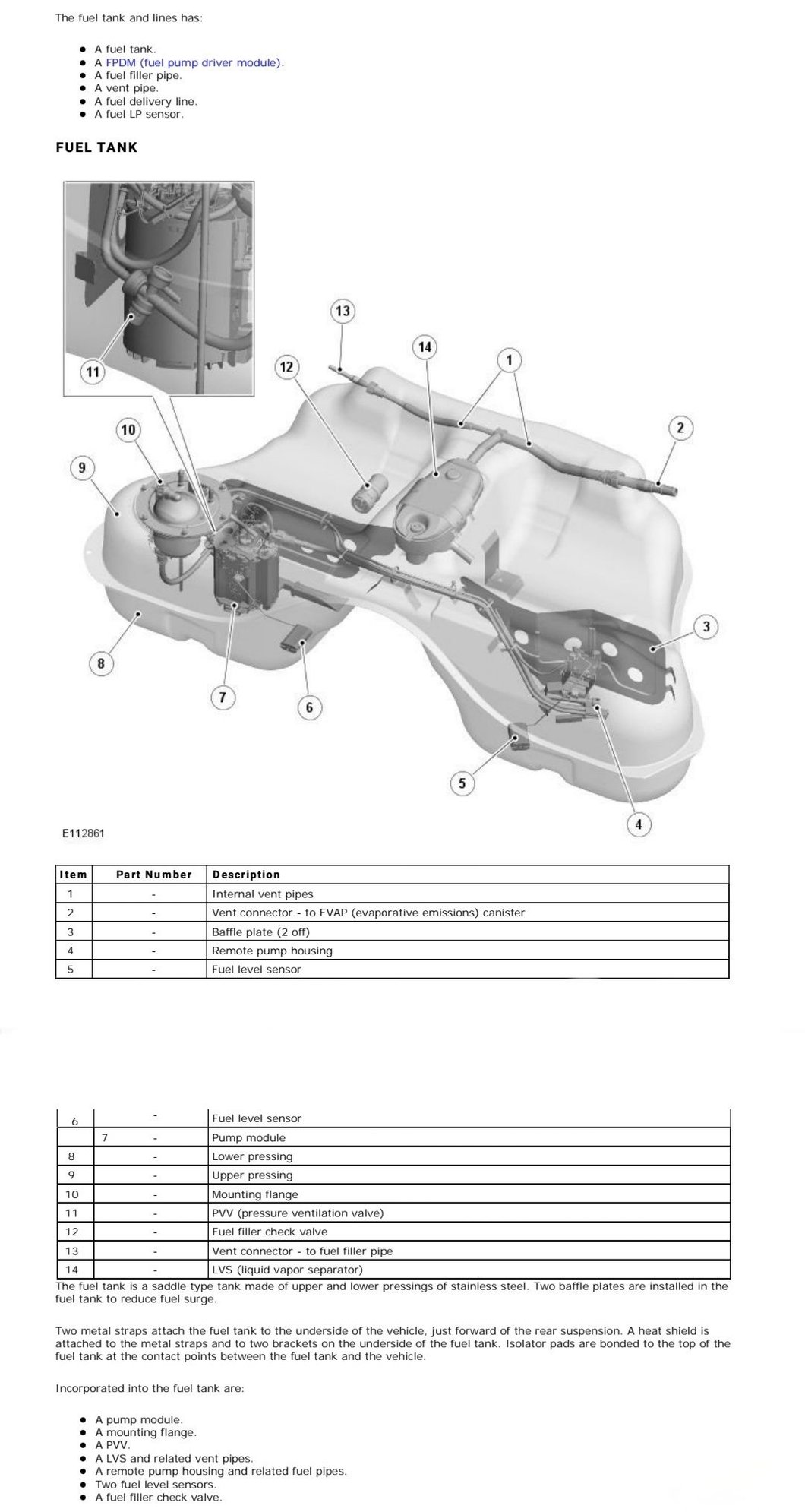

Old Dec 10, 2021 | 09:02 PM
TraxtarXKR's Avatar
Joined: Apr 2019
Posts: 391
Likes: 151
From: Dallas, TX
Was this ever resolved?
I'm having the same issue and trying different stations and nozzle depths/positions does not fix it... Agree that it's a venting issue, but I don't see any threads that detail an exact diagnosis and fix to the issue.
There's one instance of @Cee Jay replacing his evap canister, but but much more available on concurrence to that fix.
Maybe I'm just bad at searching, haha. I've attached some relevant pages from the service manual... It makes me wonder if one of the "vapor pipes" is clogged.
Is there a diagnostic procedure for all this?
