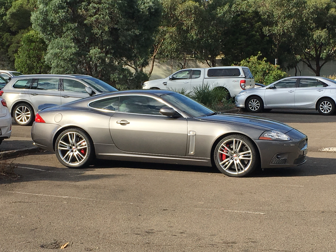

XKR-S springs in mine which are supposedly 10mm lower at the front and 15mm lower at the rear. Looks just about right to me.
Attachment 217628
I had forgotten you did that Cambo. Comment on the ride for me?

Well as it turns out I had two XKR Portfolio's at my disposal last year, so I had the chance to swap between them driving the same roads.
Mine being quite modified, the other being all original (at the time), similar mileage on both cars, same tyres even; Michelin PS4S.
Mine with the XKR-S springs and shocks (the OEM Bilsteins from the 2009MY UK/EU 4.2L XKR-S, not the 5.0L XKR-S), the other with the original XKR springs and shocks.
The stock one had a much nicer ride, absorbed the bumps of bad roads more effectively and was generally more comfortable to drive, at first it made me wish I hadn't put the XKR-S gear in mine.
What hasn't been tested is the XKR-S springs with XKR shocks. I don't know how much of the firmness in the ride is from the springs, or from the yellow B6 Bilsteins...
Probably not going to find out any time soon either...
