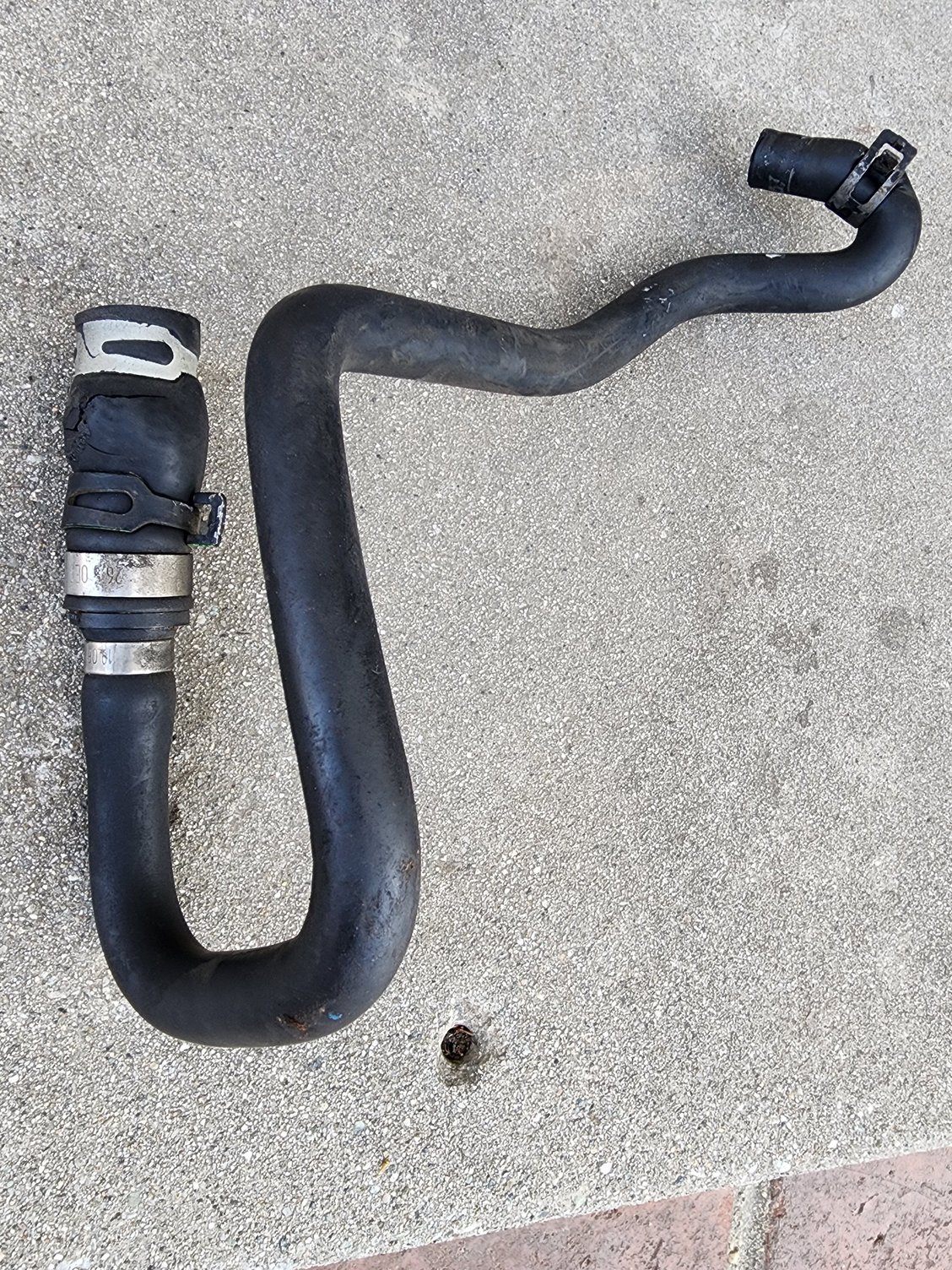

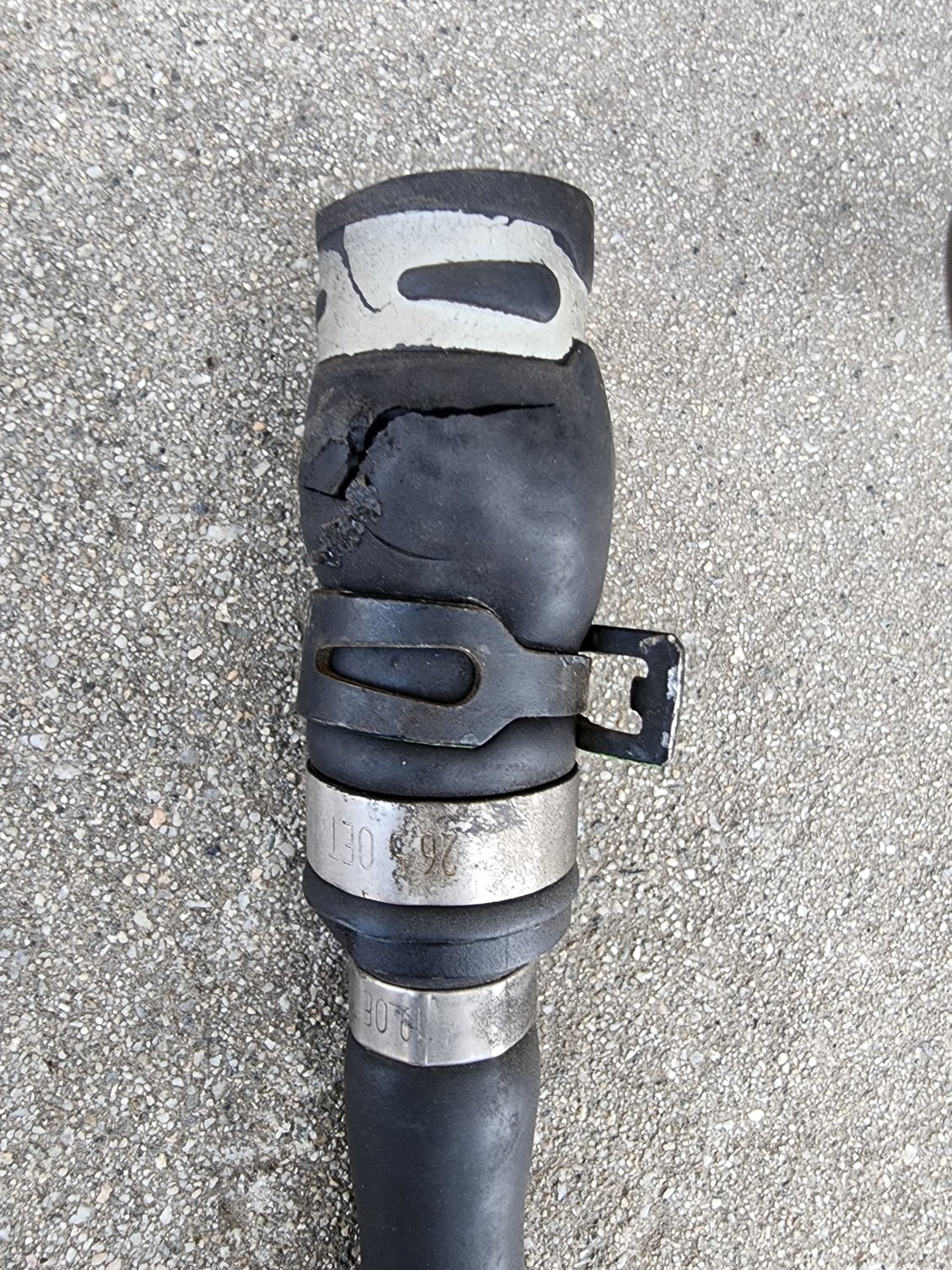

Latest on my coolant leak. It sure was that hose in the valley, upon closer inspection. I've attached a pic of the hose and a closeup of the rupture. Now, does anyone have a suggestion for the best place to source the hose, and does it come as one whole piece with the connecting part and clamps or do you have to buy all separately. Thanks in advance. Doug

That's the one where the bigger hose runs into the smaller hose! There already exists a discussion on this. You'll have to dig it out for opinions.

I'm pretty sure it's one piece - hoses from a Jag dealer are not that expensive - think these are the part numbers probably AJ89093
To VIN B20074 - AJ89093
From VIN B20075 - AJ811763

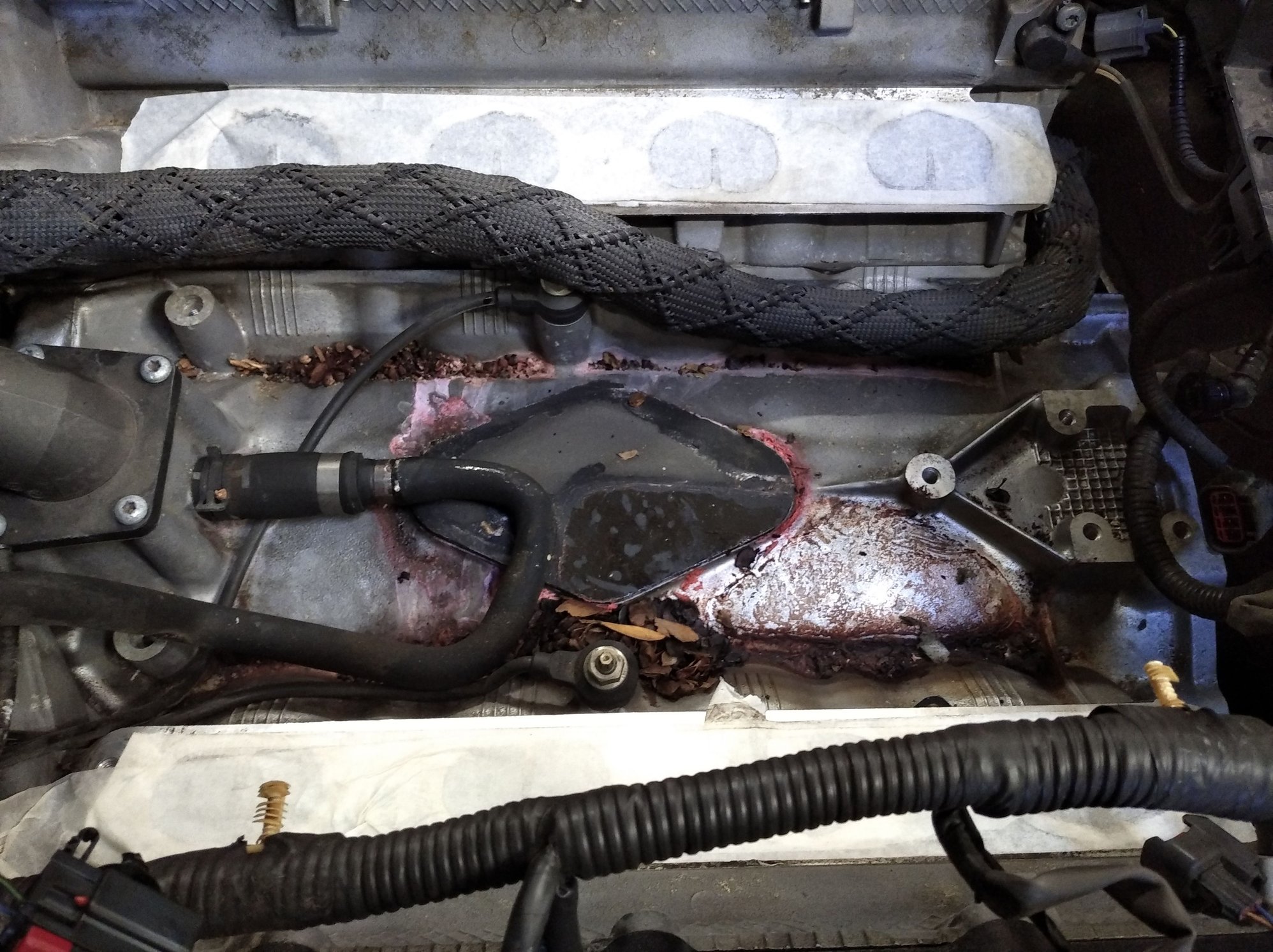

I don't really understand what's going on here.
Firstly, are you running your cooling system on pure water? When that hose splits the valley is coated in coolant, especially when you lose it all as you did, and it would be impossible to remove the inlet manifold and not see the pink, green or blue coolant residue everywhere. Years ago I used to buy colourless coolant but I've not seen it for years and am not sure that it is still available but even then there would be sticky clear residue inside the valley. If you are running the cooling system on pure water without any anti-corrosion additive, your cooling components will be corroding internally.
Secondly, the OEM hose completes complete with the the different diameter sections and even includes the hose clips.
This was my valley after removing the inlet manifold.
