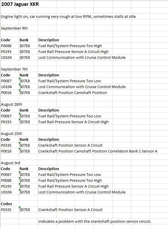

My 2007 Jaguar XKR has about 130k miles on it. For the last month or two it runs rough at times and then throws codes. The codes are not that consistent (fuel rail, cruise control, crankshaft, camshaft). I charge the battery overnight, clear the codes and then it runs fine for a while, sometimes weeks without throwing codes. The other day it was running rough and then stalled several times while I drove it home. It seems like the rough running is happening more frequently between charges although I am not 100% sure of that.
I read some articles here and saw the suggestions that there might be an electrical drain somewhere. When charged the battery shows 12.4 - 12.8 volts and when running the voltage is 14+. It starts every time without issue. It often starts running rough after I have driven it a few miles.
I brought it to the mechanic yesterday and today he said it was fine, no issues. He said an electrical drain would have to be large and would stop the car from starting at times. He tested the battery and the alternator and cleared the codes. He ran it and found no codes that indicated any electrical problem or other problem. I told him I was sure it was not fine, that it might take a day or 2 weeks to run rough but that it was happening consistently. He said he will run more tests. They do European cars but more German than English.
Any insights would be appreciated (other than get a new mechanic). I listed the dates and the codes I have seen below.

The codes are primarily fuel pressure focused.
I think you can ignore the cruise control code as its probably a spin off from the poor running condition.
Add to this your experience of poor running, I agree the fuel system should be looked at first.
These specific codes do not indicate a battery in poor state. Modules of lower priority are the first to “fail” with a poor battery. EPB, and the nav screen for instance.

Update: The mechanic replaced the fuel pressure sensor/regulator and a vacuum line and the car is running much smoother. On the downside, there is still an occasional smell of gas and I it is still throwing codes. For the last two days, it threw the following codes after some driving. I cleared them each day.
P0087 $07E8 Fuel Rail/System Pressure Too Low
P0193 $07E8 Fuel Rail Pressure Sensor A Circuit High
Biff
