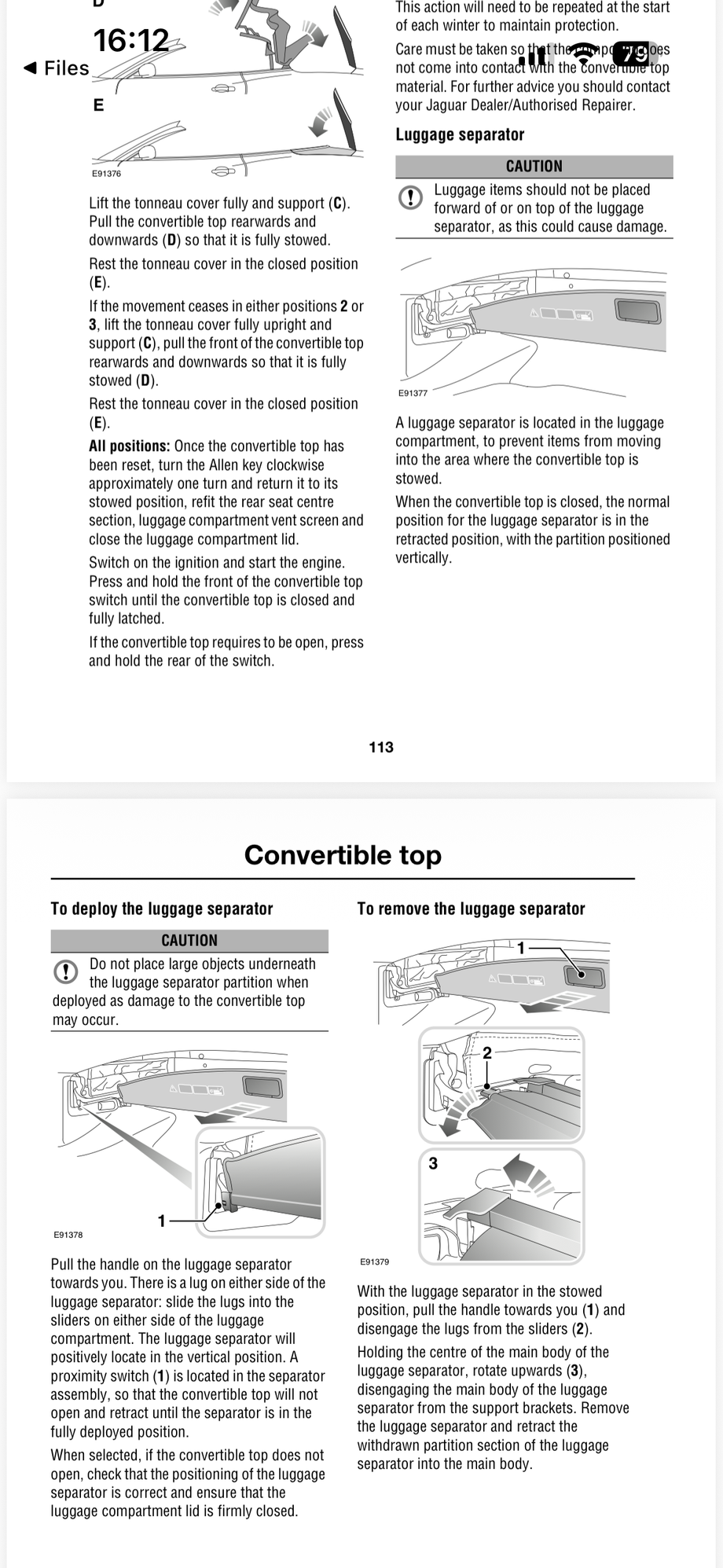

Can someone tell me how to remove. I do not have manual. Is there a procedure? 2007 jaguar xkr.

Not sure if my 13 is same but I just had it out to get at the battery. If the folding piece is in the up position so you can see the slot in the middle just put your hand in and slightly lift and that panel drops down flat. Then I just put hands at both ends underneath, lifted and jiggled it out. Make sure you remember how it is positioned when out and flat or take a pic.

So this luggage separator bar is totally removable? I need to access battery and I think a CD player? Very hard to get to.

it is the Nav DVD reader, not CD.
Yes you can remove it. Just be gentle as the top will not open/close without it properly in place.

@Leo Dalla Rosa The owner manual is freely available from online sources including this site and JLR.
The service manual is freely available from several sources.
For example, see Gus Glikas' JagRepair.com - Jaguar Repair Information Resource.
A donation to help defer the cost of the website is always appreciated.
Thank you to Gus, motorcarman and others.

Yes, just sort of lift and twist.
