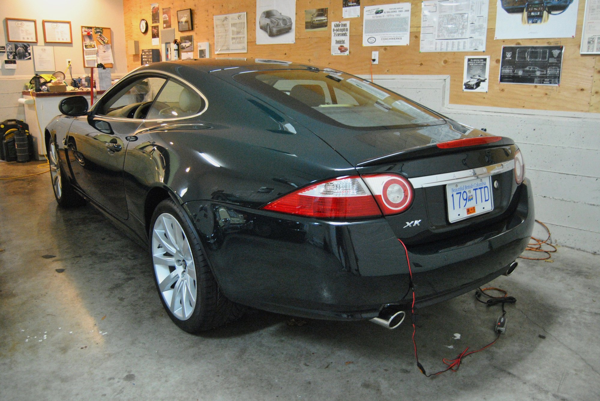

The CTEK battery maintainer is VERY EASY to hook up permanently. You do it once and it takes less than 10 minutes. When you put the car in the garage it takes 3 seconds, perhaps 4 seconds if you are slow, to connect the charger. Using this charger eliminates any possible electronic gremlins caused by low battery voltage and ensures a fully charged battery always. These cars are very, very reliable - the equal of any luxury make including the vaunted Germans. But any car requires servicing on a yearly basis at least.

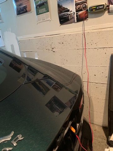

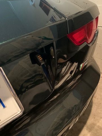

As you can see on the first photo of my XK, the CTEK cord goes from the permanent battery connection out the trunk; the cord can be left with the small waterproof connector outside. There is no damage to the weatherstripping or the car - but this photo does not show the wire routing I suggest. The second and third photos (from my F-Type) do. You can see the small waterproof connector sitting just at the edge of the trunk lid. No opening the trunk necessary for access; :
and as it is on the F-Type:
and to connect: the CTEK unit is on the wall; it can be left connected for months and months at a time with no damage:
