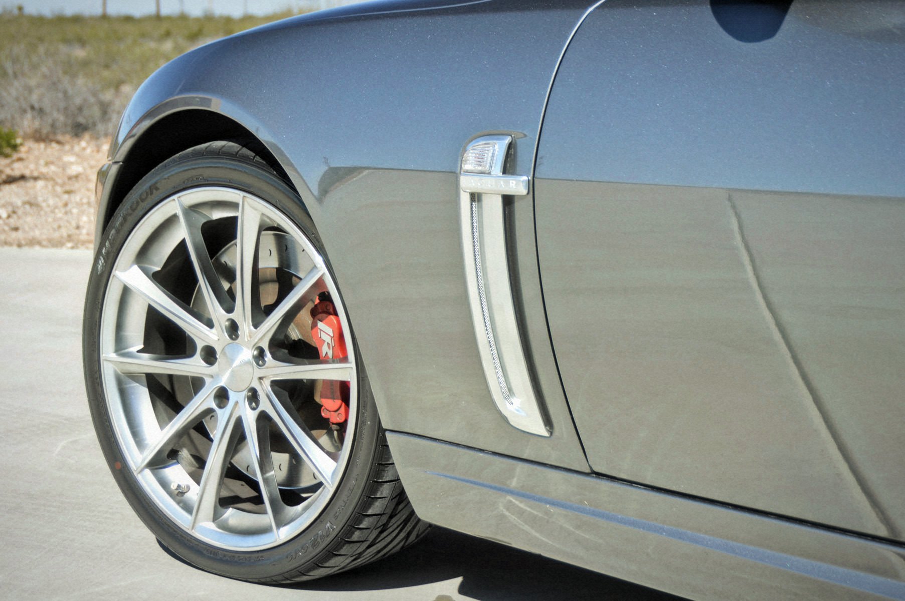

On my 2009 Jaguar XKR, I had the optionable Alcon braking system which was a $5000 upgrade to the XKR Portfolio Edition.
The Alcon system had 400mm and 350 mm rotors, the largest that Jaguar ever put on one of their cars. The brake system also had 6 piston ffront calipers and 4 piston rear calipers.
The brake system required a 20" wheel both front and rear.
From my observation driving at normal speeds, this $5000 upgrade was "not" needed or necessary for an average driver.
To replace the Alcon calipers and rotors the replacement cost is quite excessive. The Alcon rotors were slotted "moon's" cut into the rotor.
The rotors were massive compared to many other brake systems found on sports cars.
My suggestion would be to stay with the OEM brake systems unless you're a very aggressive and hard driver or plan to track the vehicle.
Other than looking "cool" the extra expensive to buy the upgrade when new or if making a modification to an existing brake system is not worth the effort, price, or the extra expense to do so.
