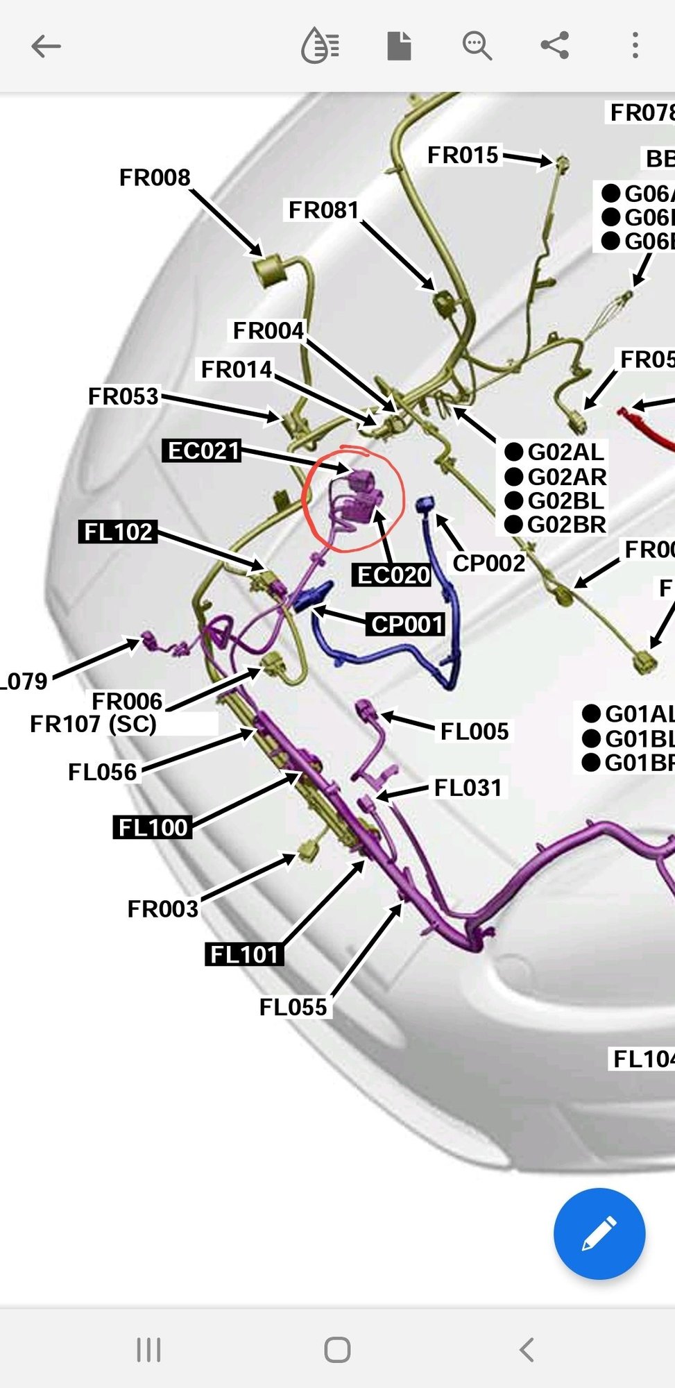

The cooling fan connectors...
Can't find a photo but there is a harness mounted below lower lateral frame strut , coming from the front left side of the front .
See screenshot from the electrical manual. It is the purple harness. Look for the connectors marked with the red circle
There is a big chance you removed that loom and now it is resting in the lower front left area somewhere
Hope it helps

Thanks for trying to help there brother 🤗
I am having difficulty in locating the little bugger, I will have another fo tomorrow evening. It's so dam close, just need to find it.
What I need is a definitive picture or location. Although your diagram clearly shows it coming in from the left to right. This may help if I try to locate and follow that loom.
Thanks Danny🤗

Found that fan plug, it was looking me in the face 😂

Thanks Danny J for helping out with the scoop location thing, always appreciate some one who goes out of there way to help🤗
