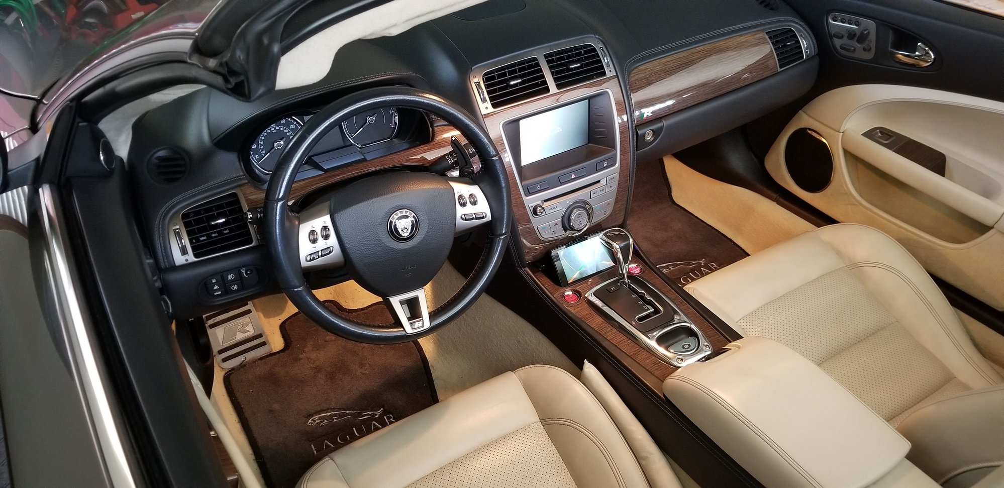

You're in the USA, where 2009 was the last model year for the the 4.2L engine. I suggest that you consider the limited production 2009 XKR Portfolio coupe or convertible as well as the similar 2008 XKR Portfolios. One drawback is that although the Portfolios are pretty much loaded up with options and unique features, you could not get a heated steering wheel with either the 2008 or 2009 Portfolio, so that might make it a dealbreaker.
All 2008 Portfolios were Celestial Black and included the Alcon Performance Brake Package with 6-piston front 4-piston rear calipers and huge crescent-grooved rotors, which was a $5,000 option on the 2009 Portfolio. All 2009 Portfolios were Shadow Gray and included iPod connectivity for music with steering wheel controls and integrated touchscreen display. iPod connectivity became standard equipment in 2009, but a dealer-installed accessory Audio Connectivity Module with similar features became available for 2007 and 2008 models.
Here are a few pictures of my 2009 XKR Portfolio convertible.
P.S. A 2009 XKR Portfolio coupe is available for sale in the Forum Marketplace. Here's the link: https://www.jaguarforums.com/forum/market/222463
