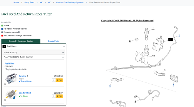

Fuel filter and associated parts for an X150 listing on SNG Barratt, one of the forum sponsors:

@NBCat - Yes that is the fuel filter that I just ordered yesterday.
