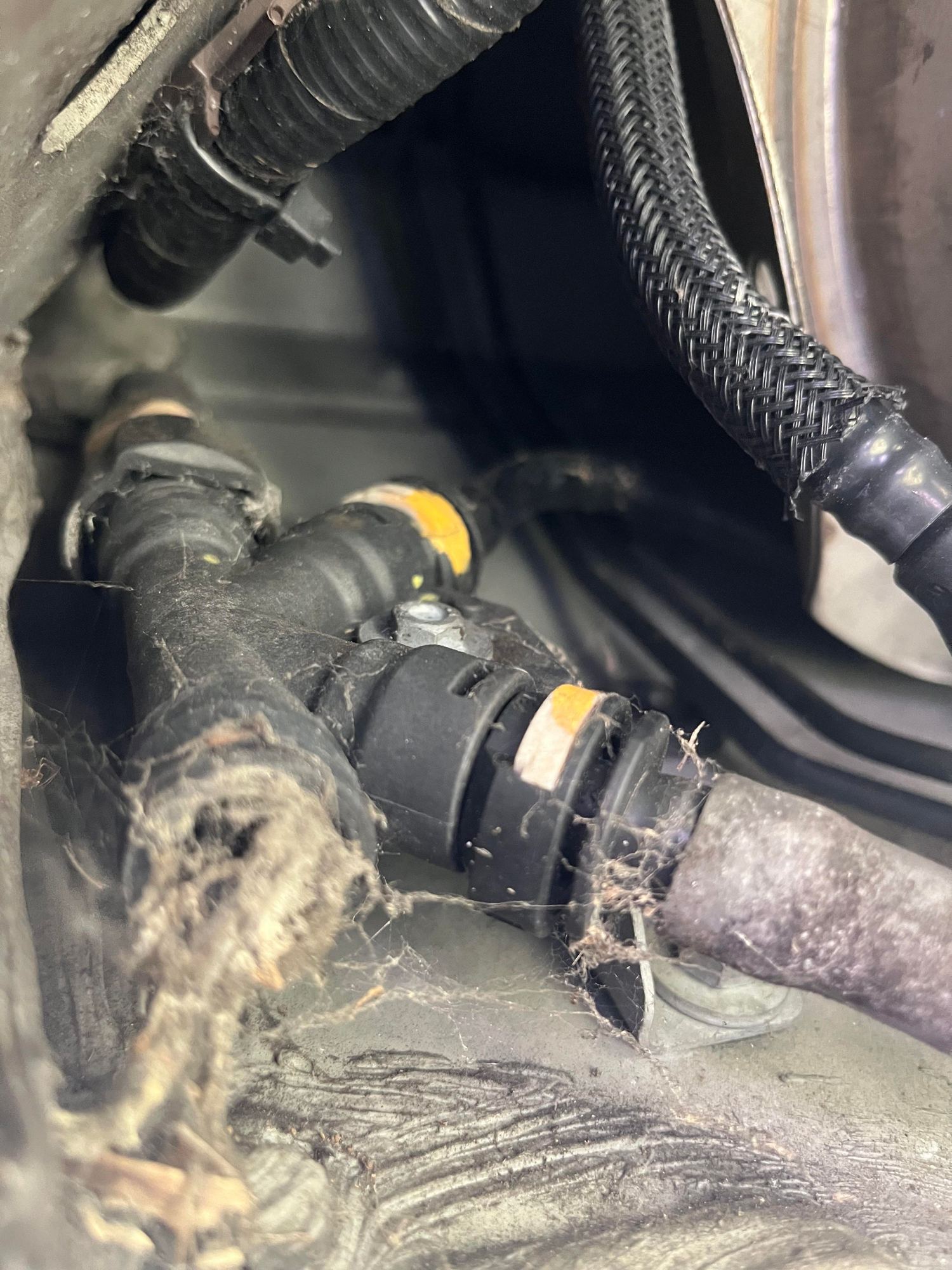

Fuel filter and associated parts for an X150 listing on SNG Barratt, one of the forum sponsors:
@NBCat does it say where this is? One person said in front of the left rear suspension. I do not see anything there.

Here’s where an how to change on XKR 150. After filling my tank, I got some missing at moderate speed. I didn’t check codes. Figured it might be bad gas. I put in fuel system cleaner, and treatment to allow water to breakdown. So far fine. But, for yucks I bought a new fuel filter. I’ll be doing that next week. Damn…it was $175 at the dealer.
Your 2014 doesn't HAVE a replaceable fuel filter. Yours is a mesh sock on the fuel tank feed on the primary fuel pump.

The fuel filter is built into the flange on top of the fuel tank
it's accessible from behind the rear passenger seat,
small access port, the flange won't fit through that port
I've replaced mine.

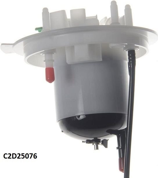

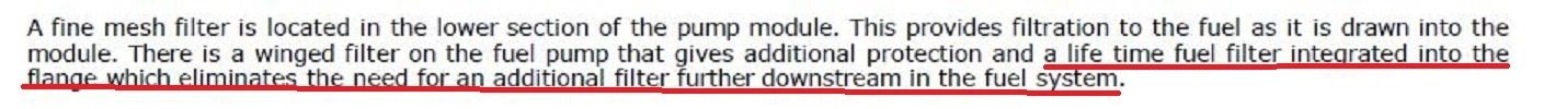

The fuel filter and it's replacement is kind of a mystery if you read the Jaguar documents. As posted above first they tell you it does not need changing as it's a "lifetime" filter! Well we all know that Jaguars definition of lifetime is different from us car owners! Plus I have NEVER heard of any filter being lifetime and am puzzled about how it even could be?
So here is what I have found so far.
Here is Jaguar statement from the workshop manual.
I spent some time and did find a part number for the filter but I have a 2014 XJR so check the number before ordering the filter. I suspect that this is used across the entire Jaguar lineup.
Here is the entire fuel pump/filter assembly. The standard filter sock is visible on the left as always.
I have the filter on my bench and don't know if I will change it out or not right now as I am at about 60K miles.
Anyone change theirs?
