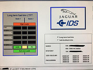

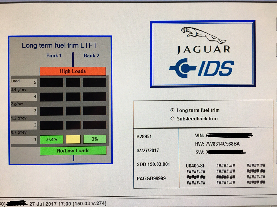

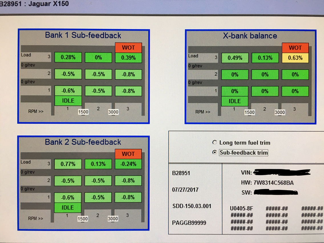

IDS/SDD gives you a much more detailed view of the fuel trims in the 2006MY onward cars.
Are the mods worthwhile ?-photo122.jpgAre the mods worthwhile ?-photo756.jpg
Note that in the 2nd pic a lot of data is missing because the car didn't do enough miles at that time after the PCM had been reflashed (which cleared the adaptations)

No it's just read over the OBD port, with a VCM, DA-Dongle, etc... you do not need the VMM for this.
If you clear the adaptations it does take a while for the re-learning to be completed, when I took those pictures i'd driven 300km since the reflash, and they were still not complete...

You see the black boxes in the 2nd pic of the LTFT's, it's not recorded any values yet.
