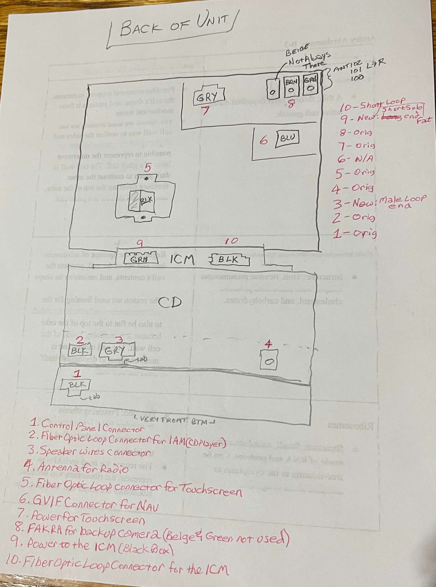

After going through the video over and over, grabbing screen shots, I also made this drawing:
If anyone wants to help with labels on things, I’ll be glad to make updates.

So I have successfully installed my Mr12Volt unit.
Again, thank you to everyone who assisted along the way, especially a handful of you who went over and above.
I have completed all of the install videos. I just need to figure out how to use iMovie on my phone (terrible) or go find a free video editing software suite for this WIn11Pro machine which I will search in a few minutes.
This was a one and done. There were too many places that could have ended poorly for me to return it to stock and start over.
So Here's the thing:
I made a lot of mistakes.
Some silly like during the removal video, I called the dull bolts long and shiny short. It's the other way around.
Some not so silly, like screwing up the contacts on a ribbon cable (Original not Mr12V). Thank God I was able to straighten it.
Then, in one of the last videos, my planning was extremely poor and two of my blue tape labels were incorrect.
I forgot who the admin is who can edit our threads, but I will probably restart an End All Be All Mr12V thread from scratch with everything in it to be pinned.
And relabel this one to "I am going to make an end all be all...." Thread. Or something.
OK, off to see if there is a good easy video editing software for Win11 and get the videos over here.
I'd like to add text over spots where I screwed up to correct them in real time. While it's all fresh in my foggy brain.
