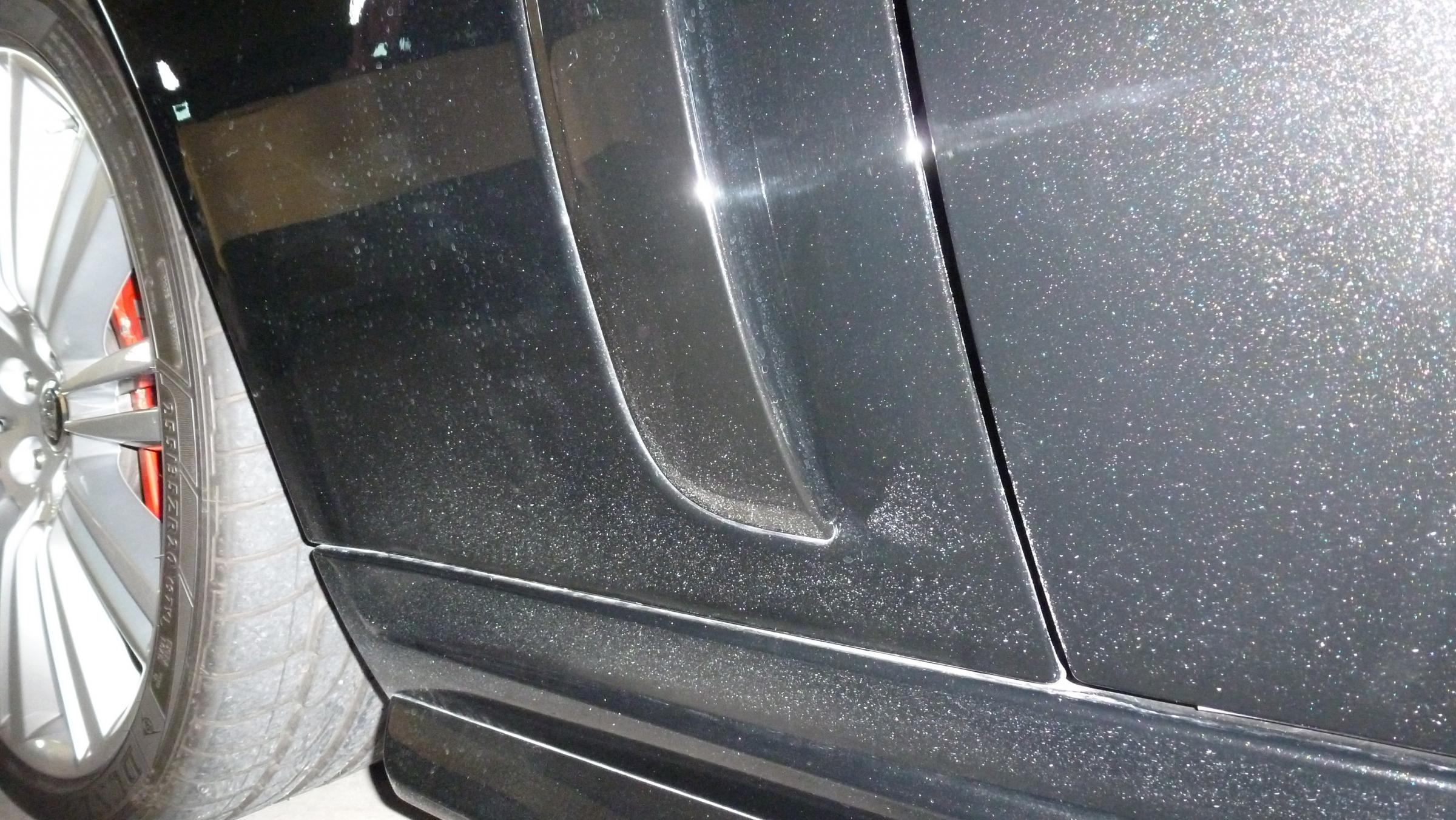

Picture of road rash on my sold 2011 XKR 175 with only 4,000 miles. It looked like someone sand blasted the side of my car. You can see the pepper sprayed look 12" up down the side, especially noticeable behind the front vent. It also felt very rough. What a shame. My new XKR has been clear covered 18" on sides wheel to wheel to avoid the same problem. Has anyone installed custom fitted mud flaps? I would install them in a heart beat!!!

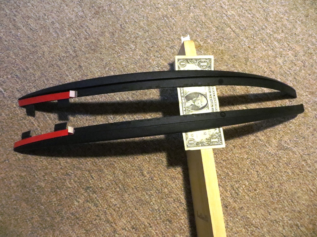

Here, and you can see the panel gap I need to fix.. (Probably loosen the bumper and push it more to the drivers side, grrr)

Those are the standard back mud flaps on the XKR. I looked at my car last night thinking of doing a similar install on the front. The protection is only required from about 12" down where all the damage occurs. If installed from about 12" down they will fit better, look better and offer the best protection with the widest end (cut end) at the bottom. The cut end could be rounded off around the end to look better and would be on the very bottom out of sight.
The front fenders have a very narrow return unlike the back quarter panels. Will the clips hold the pieces securely in place on the front fenders? I never noticed any screws holding them on to the back quarter panels on my 2013. They seem to be held in place with clips.
I want to avoid road rash damage as evident on my last 2011 XKR 175 with only 4,000 miles. Picture below. I have the mouldings on my new 2013 XKR and sold 2011 XKR 175 rear quarter panels. It's the front that mostly needs the protection.
The moulding are very pliable and should fit on without any need to adjust your rear bumper.

DGL - thanks for the photos. This is exactly the problem I have on my 2010 XKR. I am talking to a paint shop now about repairing it and covering it with clear bra. We've also decided to order a pair of the rear mud flaps and adapt them onto the front wheel wells as you described.
Please let me know if you beat me to it with any tips. Thanks again.
