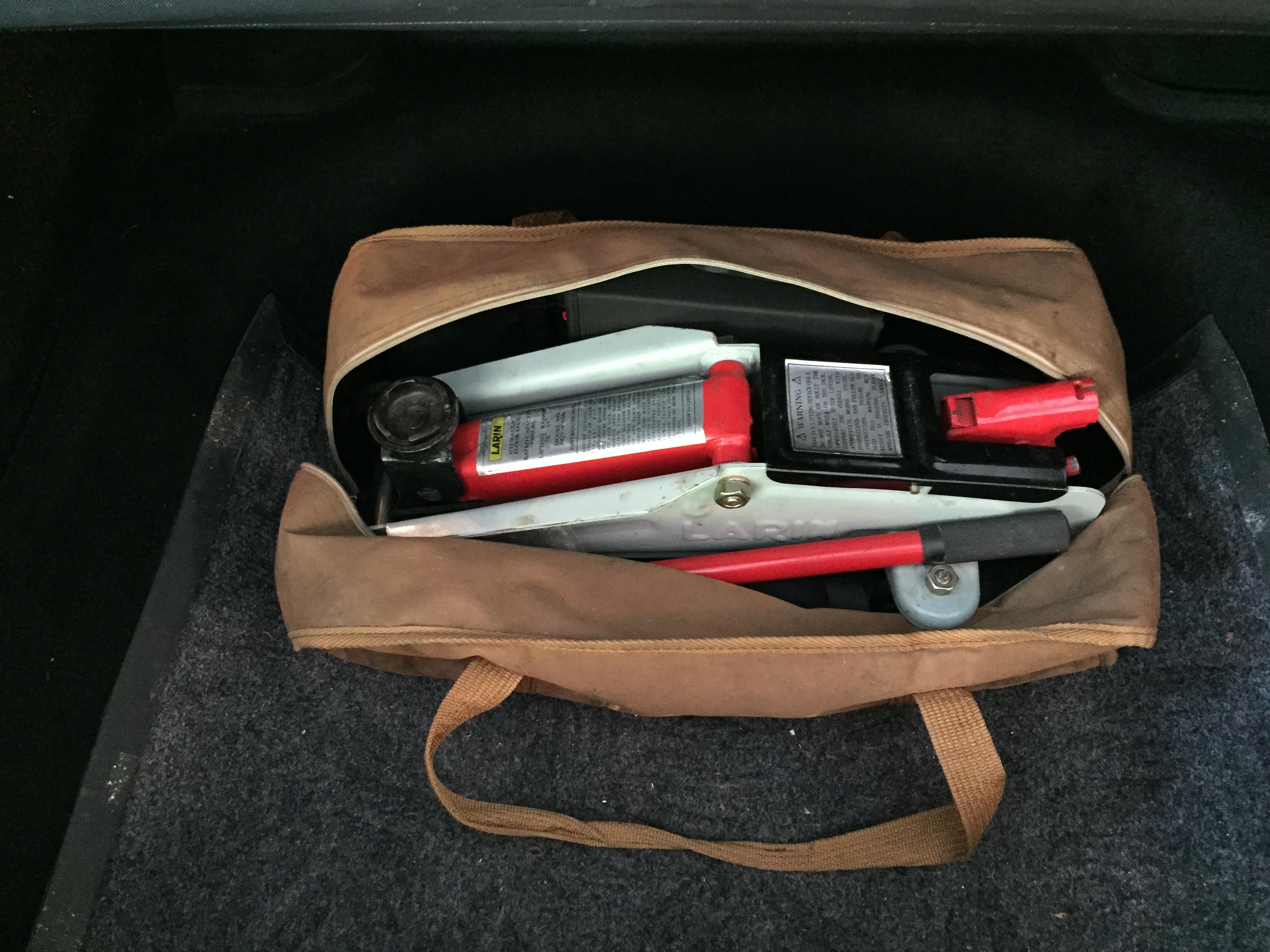

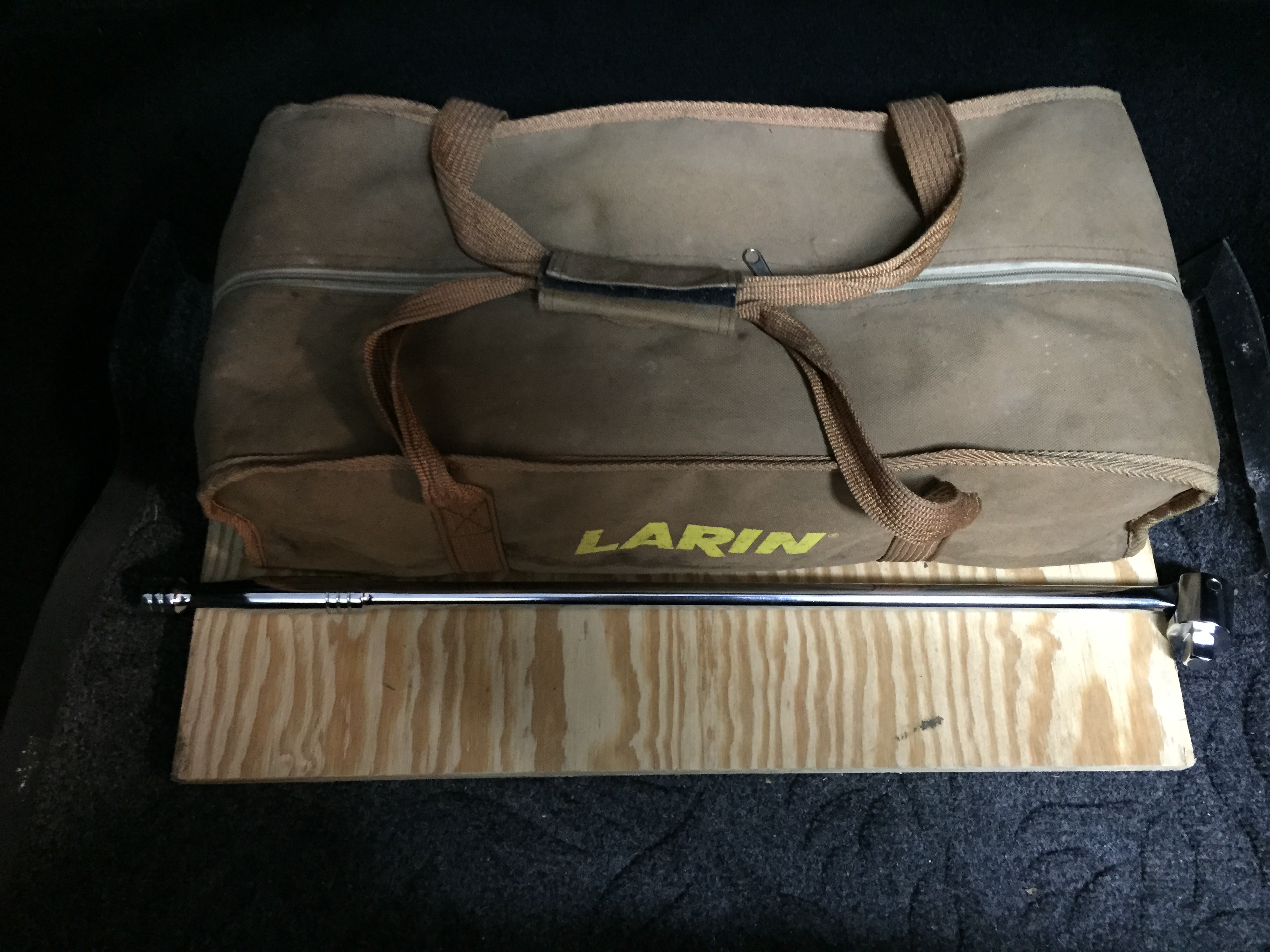

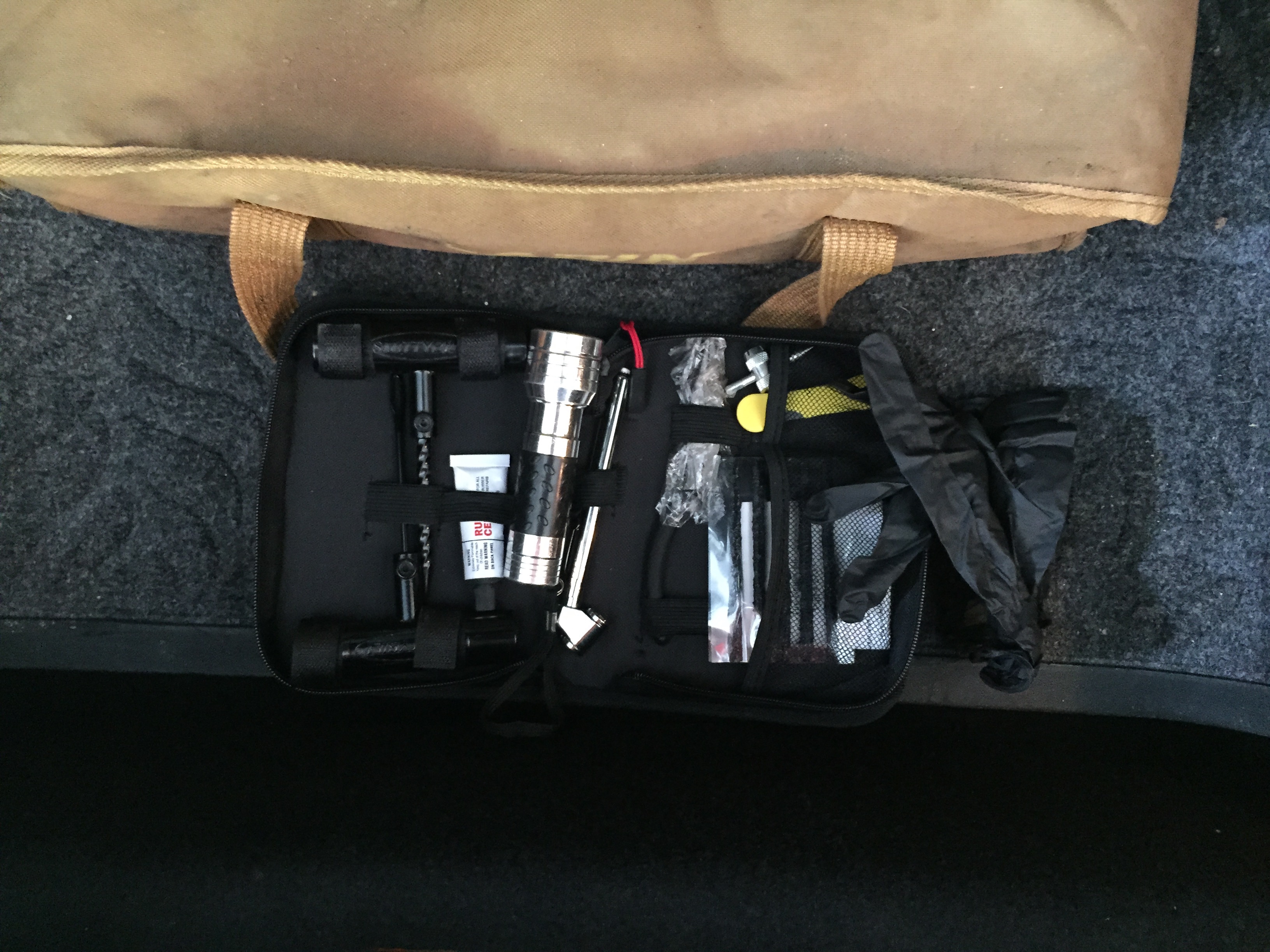

A number of members have offered their suggestions.....This is mine: Drawing on comments and suggestions from various members (a few have already offered great suggestions)...
1. I'm using my Jags existing inflator (check it for operation)
2. Added a small hydraulic "jack 'n bag"
3. Added a complete plug kit (has gauge, gator plugs and tools to insert). I added rubber gloves and a flashlight.
4. a 3/4" plywood (base for jack on soft ground)
5. 25" breaker bar and socket for removing tire.
