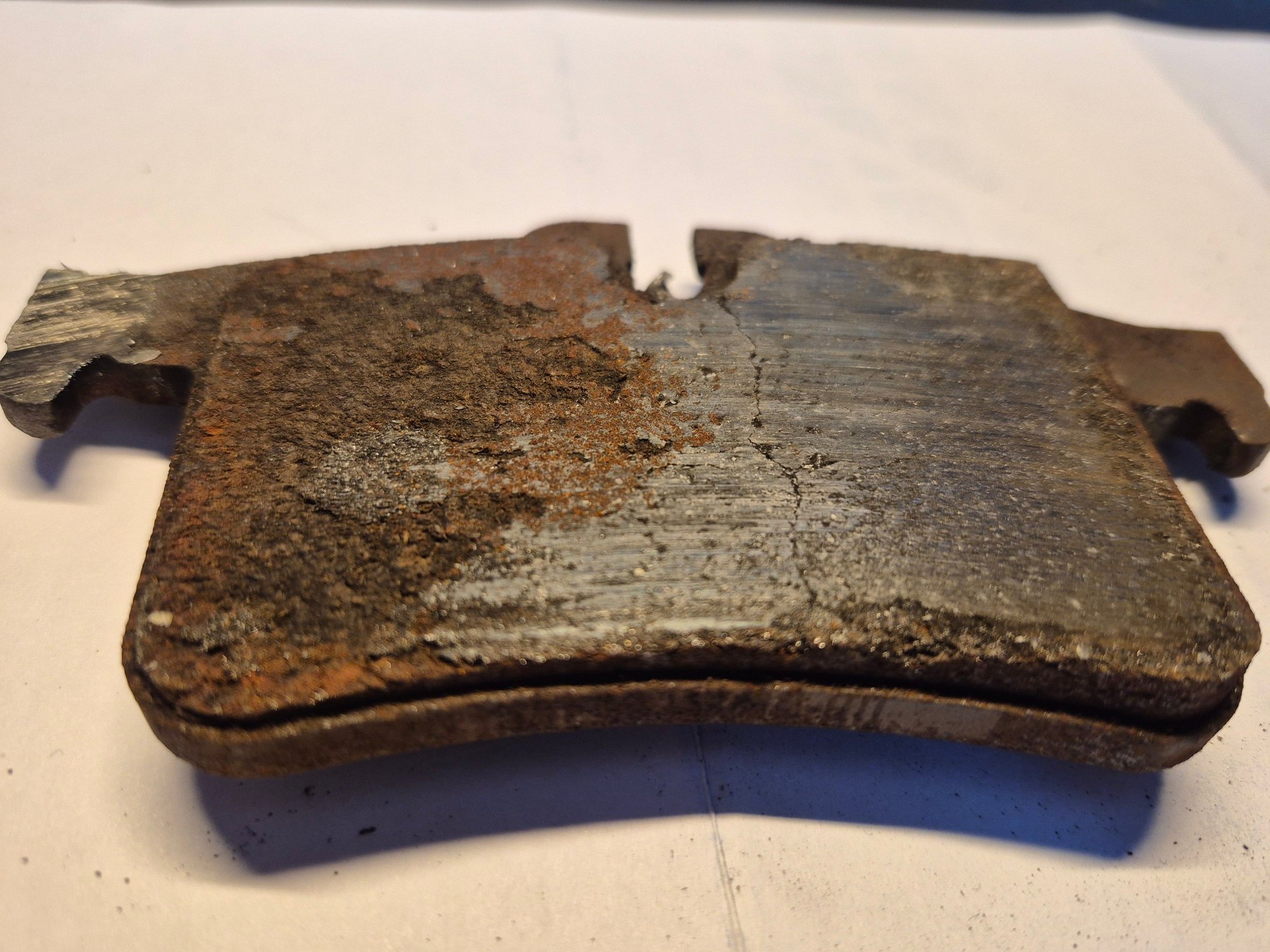

After 1 year (and a few performance sessions) of using suggested new pads C2P25493 for my 2012 XKR-S, I replaced them and will never use them again. Here is why. The spacing between the springs in the back is much smaller than my my piston and I could not get them around. As a results, one of the springs broke, the other got trapped under the piston. This happened on both sides. This resulted in uneven pad wear, pitted piston, and the feeling of brake softness that drove me crazy. It was almost like some air got trapped in the system. Take a look at the pictures.

Those pads really don't look like they sat right. Anyway, as you say, the Ferodos do feel better and the extra springs don't seem to achieve much, even if you can get them to fit correctly but add rather a lot to the price of the pads.

No worries, going to stick with Ferodo now. Just do not see how you can get these stock springs around 2012 piston. Plus, I do not line the idea of these springs touching the dust boots, they will burn them through.
