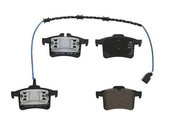

Hi
I have 2012 XKR-S and I need to replace my rear brake pads. According to several dealers the correct part number for my car is C2P25493 and it should look like this
However, when I look at my old pads installed, they look like C2D3792
The main difference here is the anti-rattle spring that attaches to the top of the inner pad for C2D3792 and all the springs attached to the back of the inner pad for C2P25493.
I am not the original owner, but I bought the car when it was 1 year old with 1,500 miles (it has 20,000 now) from a dealer and it's likely that pads installed are the original ones from the factory. However, if that's the case, why it's a different part number / design now?
Can anyone with XKR-S comment here? What do you have in the rear? Do you have to anti-rattle spring installed on top of the inner pad? You can see or feel it with your finger even with the wheels installed. That's the easiest way to tell them apart. I am really puzzled as why I have C2D3792 installed and the dealer says I should have C2P25493
BTW, if I go directly to Ate site (brake manufacture) and look at their recommendation for XKR-S, it's C2D3792 (what I have installed) as well.
I am really confused.

I don't have an XKR let alone an XKR-S but I did have a 2010 XFR and I now have a 2014 F-Type.
Both have the same 376 mm rear brakes as the XKR-S but with very different pads.
The XFR pads looked the same and were possibly identical to the C2D3792 and not like the C2P25493.
The "anti-rattle" spring you talk about on the pictured C2D3972 is not an anti-rattle spring at all, rather it is the brake pad wear sensor clip.
On my XFR with the same pads the anti-rattle spring was attached to the outside of the caliper, not the pad. The F-Type is different with little springs attached to each end of the pad. Neither are anything like the pictured C2P25493.
Point is if the existing/old pads look like the pictured C2D3792 you should have the external anti-rattle clips as well, and if you do you want the C2D3792 not the C2P25493.
If you look closely, both pads are actually the same ATE items. The XKR-S version has the extra backing plate pressure springs but they fit in the same calipers common to all these 5.0 S/C cars. Those backing plate springs are amazingly expensive!!! It is possible that the springs help with pedal feel or reduce knock-back effects, I don't know. However, if you want a 100% stock XKR-S, the C2P25493 are the correct pads. If you are OK with not having the extra springs, the C2D3792 are the same pad with the same friction compound (DOT edge code FF). Maybe later XKR-S didn't have the C2P25493 pads or yours left the factory with the less fancy ones. Either way it isn't a big deal.
In the UK, the base ATE-labeled version of the C2D3792 pad (13.0460-7255.2) can be had for 50 Pounds or less. The Jaguar-boxed C2D3792 lists at 130 Pounds. The C2P25493 lists at 420 Pounds but can found at around 200. Keeping it original is expensive for a rear pad that doesn't make much of a performance difference.
Mintex does an affordable copy of the C2P25493; the MDB3707 but it seems to have a less good compound (FE).
EDIT: I just noticed the issue with the wear sensor fit. It looks to me like the C2P25493 pads take a sensor like the one for the front - simple push fit into the existing slot. The C2D3792 has a different ant-rattle spring that slots into the same recess and the wear sensor slots into the "O" in that anit-rattle spring. The C2P25493 comes with a wear sensor to suit supporting the theory that they are different (C2P24219 instead of C2D2976)

Thanks. It looks like my car left the factory with C2D3792 and old style wear sensor. It appears that starting from 2013 Jag started using C2P25493 with a new sensor that fits. This would explain why many part websites list C2D3792 as the right part from my car and not C2P25493. Jaguar is the only one that claims C2P25493 as the correct part number. The only change appears to be the backing plate and new wear sensor.

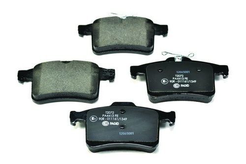

Aftermarket equivalents are appearing in addition to the Mintex:
  • Blue Print ADJ134245
  • Brembo P 36 034
  • HELLA PAGID 8DB 355 021-561
  • Mintex MDB3707
Old Jul 13, 2021 | 09:08 AM
BlueXKR-S's Avatar
Joined: Jun 2013
Posts: 181
Likes: 40
From: Pittsburgh, USA
  • Brembo P 36 034
  • Mintex MDB3707
Do you know if any of them are FF? I saw that Pagid is FE from a picture. Have not investigated the rest yet.
Old Jul 14, 2021 | 04:21 AM
neilr's Avatar
Joined: Sep 2014
Posts: 606
Likes: 330
From: Germany
Nope All the photos I found suggested that they are all FE-rated. So far, the only FF rated pad I have seen are the ATE ones. Ferodo do a GG rated one but with the standard spring clips and not the "on-piston-locating" clips. I'm tempted to try the Ferodo ones just out of curiosity.

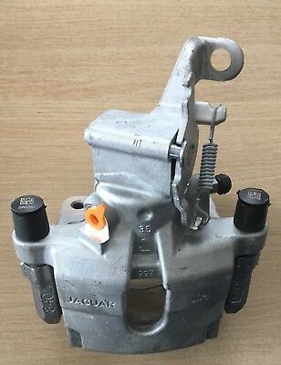

After seeing this thread, and the different spring designs, I became curious to see if the XKR-S part number pads would fit on my XKR...
Is there any advantage to one spring design over the others?
Are there compatibility issues between the multi spring XKR-S pads and my calipers?
Do any porterfield pads have the springs on the back?

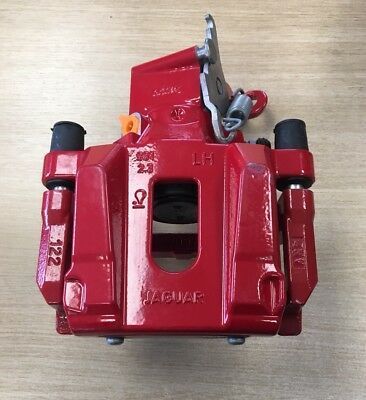

I have red calipers, but am not sure about the part number (VIN B46623)... I only found one part number for red calipers, so it's a good possibility I have C2D39490/92.

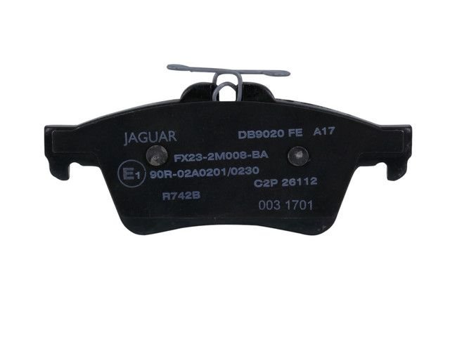

As stated in the first post, there's at least 2 options of pads (possibly 3); one with angled sides and a single spring in the wear sensor cutout, one with flat sides and a single spring, and one with flat sides and multiple springs on the back of the pad plate.
The parts catalog has all these options:
2006-2015 caliper part numbers C2P12432/3:
https://www.jaguarparts.com/oem-part...liper-c2p12432
2006-2015 caliper part numbers C2D35333/35
https://www.jaguarparts.com/oem-part...liper-c2d35333
2010-2015 caliper part numbers C2D39489/90/91/92, which is red, or gray painted:
https://www.jaguarparts.com/oem-part...liper-c2d39489
2006-2015 pad part number is C2P26112 (angled shape):
https://www.jaguarparts.com/oem-part...-rear-c2p26112
2010-2015 pad part number is C2D3792:
​​​​​​https://www.jaguarparts.com/oem-part...s-rear-c2d3792
2013-2015 pad part number is C2P25493:
https://www.jaguarparts.com/oem-part...-rear-c2p25493
