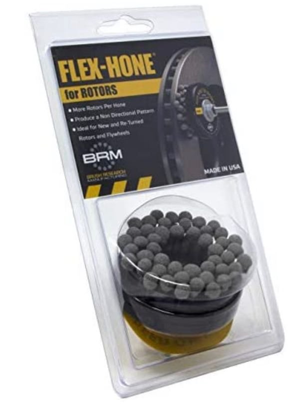

Well im sure somewhere somebody did something where they ended up with a warped rotor but I wonder if maybe it hit something and was bent more than warped. Or maybe counterfeit rotors made from pot metal.
all I know is ive driven high powered muscle cars all my life. My first car was a dodge challenger and the second a cuda and now a hellcat. I drive the wheels off all of them and have taken them to the brink of destruction and yet ive never seen one warped.
Bent one? Maybe? worn irregularly?? Sure! All the time. Heated them till thd were blue, crazed snd cracked? Sure! But thats not warp. And im looking for them to warp and sure they will pulse after a while. But I fix pulsating brakes that arent cracked either by bedding the brakes or using a drill mounted brake hone which looks like a wire wheel brush from a drill with little ***** on the ends that take off small imperfections, glaze and gives a great like new machined crosshatched high fiction surface.
I run my brakes hard. I really abuse them. I should see warpage all the time. But I dont and I use oreilly brake best. Crap, wagner crap. AC Delco. Basically anything except generic no name ****. That why I dont believe brakes warp. And ive been driving since I was 14 back in ‘ 77. Thats a shitton of miles. But im sure it can happen. I just have to believe it was rare though or a **** poor install or a caliper or bracket was bad causing uneven wear that pulsed.
now if the rotor hat went on, wasnt seated or wasnt flush to the hub it will wear funny and probably pulse and that needs machining to fix because it wore the rotor unevenly
did you ever watch brakes get turned? The always seem to have a single period like a high side and a low side. Not a potato shape or multiple dips and bumps. Idk. Maybe cheap chinese counterfeits caused it.
Btw cast iron pans do warp but they arent anything like disks. Cast iron pans are thin walled, cheap cast iron made in a sand mold the sit on a hot stove burner directly contacting the entire bottom of the pan for long periods of time- 10 20, 30 minutes or more. A rotor gets part of it heated where the brake pad touched and then it spins into forced cooling air for may 20 second or a minute at most. Cast iron pans are CAST. Not forged, stress relieved or machined nor do cast iron pans have the structural integrity that the boxed ventilated thick disk does. The reason theres a minimum thickness is because bad things can happen when the rotors too thin! as the faces wear down theres a less metal to dissipate the heat so you get really holt and then you get brake fade. the rotor metal overheats bc its thinner and cant dissipate the heat as well. Then turns colors, gets all polished so the brakes work poor and then you get crazing and cracks and DANGER. That rotor boxlike structure is strong as hell to resist bending. But you can overheat them and crack them and its easier when the rotors are worn down and grooved and thats when stress cracks start coming . Also when they are too thin, you can run the risk of pushing a piston out too far, or cooking the seals from the heat which causes the pistonseals to harden, brake fluid to boil and bake so its viscosity changes. The caliper piston jams or sticks or leak brake fluid. Thats why there a minimum thickness.
If you work on your own car, try the brake bedding trick. It costs nothing. And I really recommend a brake hone! I just recently got this hone but ive used it several times and its amazing. Just have to use it right at the correct steady rpm as the rotor rotates. And it cheap. Try it!!
hasta
hasta
Never seen that tool, thanks for mentioning. Definitely would be worth a try.
I thought I uploaded a pic of it but I guess I didnt. Here it is.

Originally Posted by ThatAlconGuy
Uhhh... No.
Hey alconguy, whats your opinion on these brake rotor hones. I spin the rotor as I hone it with a drill set to the stated speed and I get a beautiful pattern on the rotor. Seems like it works but I figured id ask an expert

Yes he said he saw 2 or 3 rotors that were warped but out of how many? Hundreds? Thousands? 10s of thousands? And he didnt say why so it could have been from impact damage!
long story short. Most of the brake shudder is from the transfer of pad material. Not all of us are saying its always one thing. I specifically tried to state the cause is most likely.
and as someone else said, if brake warping from heat were more common, the manufacturers would love it because they could sell more rotors. And it wouldnt be a manufacturing defect under warranty due it being caused by the driver overheating the brakes.
just try re-bedding the pads when your brakes shudder. Hone the rotor with the hone I posted. Youll see if its physically warped or not
