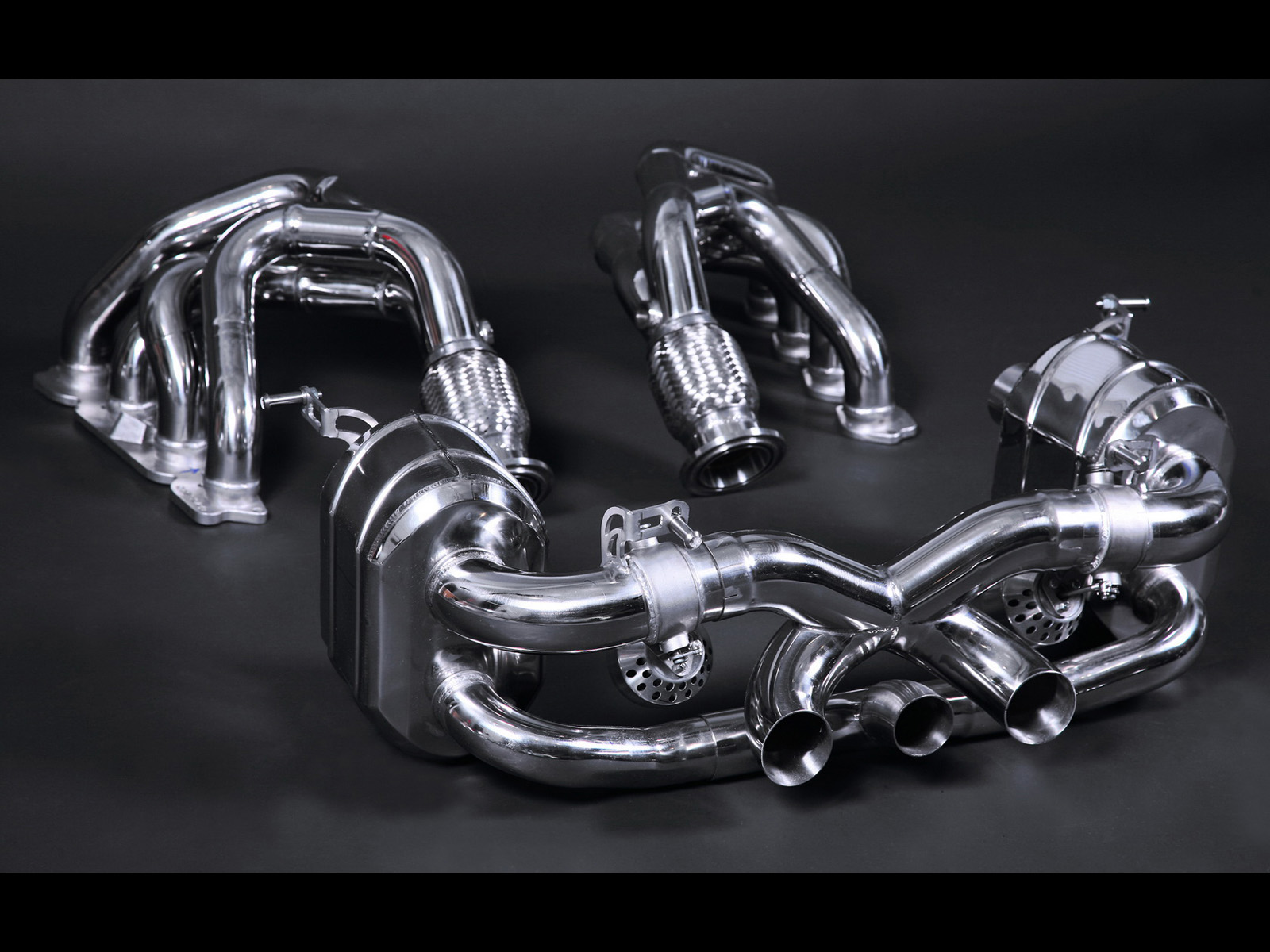

OK, here's the sort of contrast you're talking about:
Both are V8s; the 458 is a bit smaller at 4.5l. However, the 458 revs to 9000 RPM, which is going to be a big contributor to that scream. Secondly, this is the 458 exhaust:
It's very short - the resonant frequencies will be much higher than the long pipes on the R-S. So I think you'll struggle to find an exhaust configuration for the XKR that can generate the sort of wail the 458 can put out. You should still be able to achieve a different sound from other XKRs, but I don't think it's going to be the same timbre as a 9000-RPM mid-engined V8.
