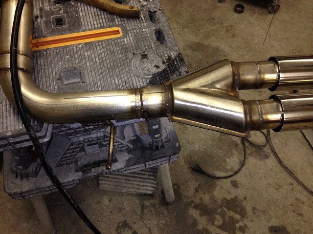

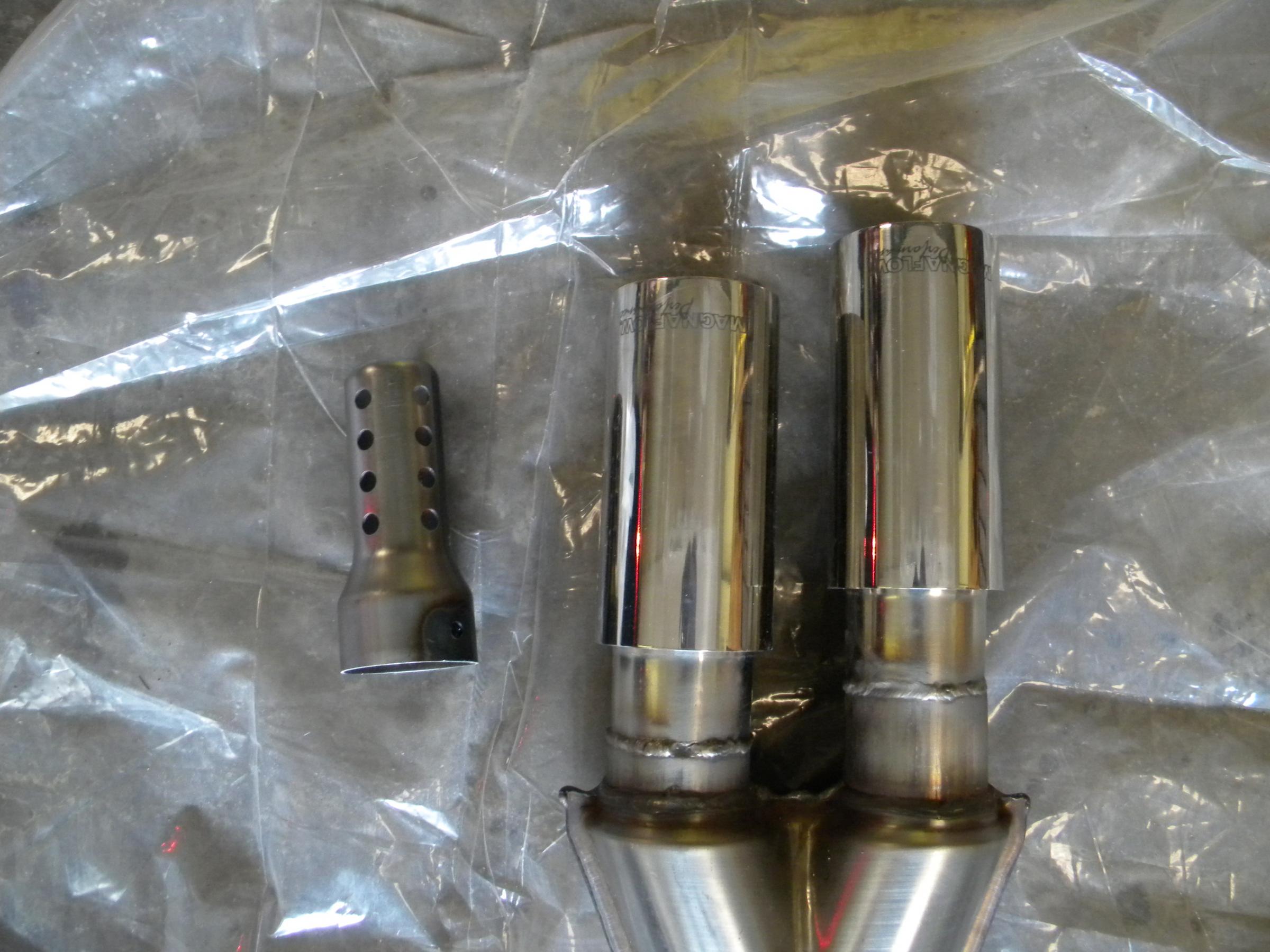

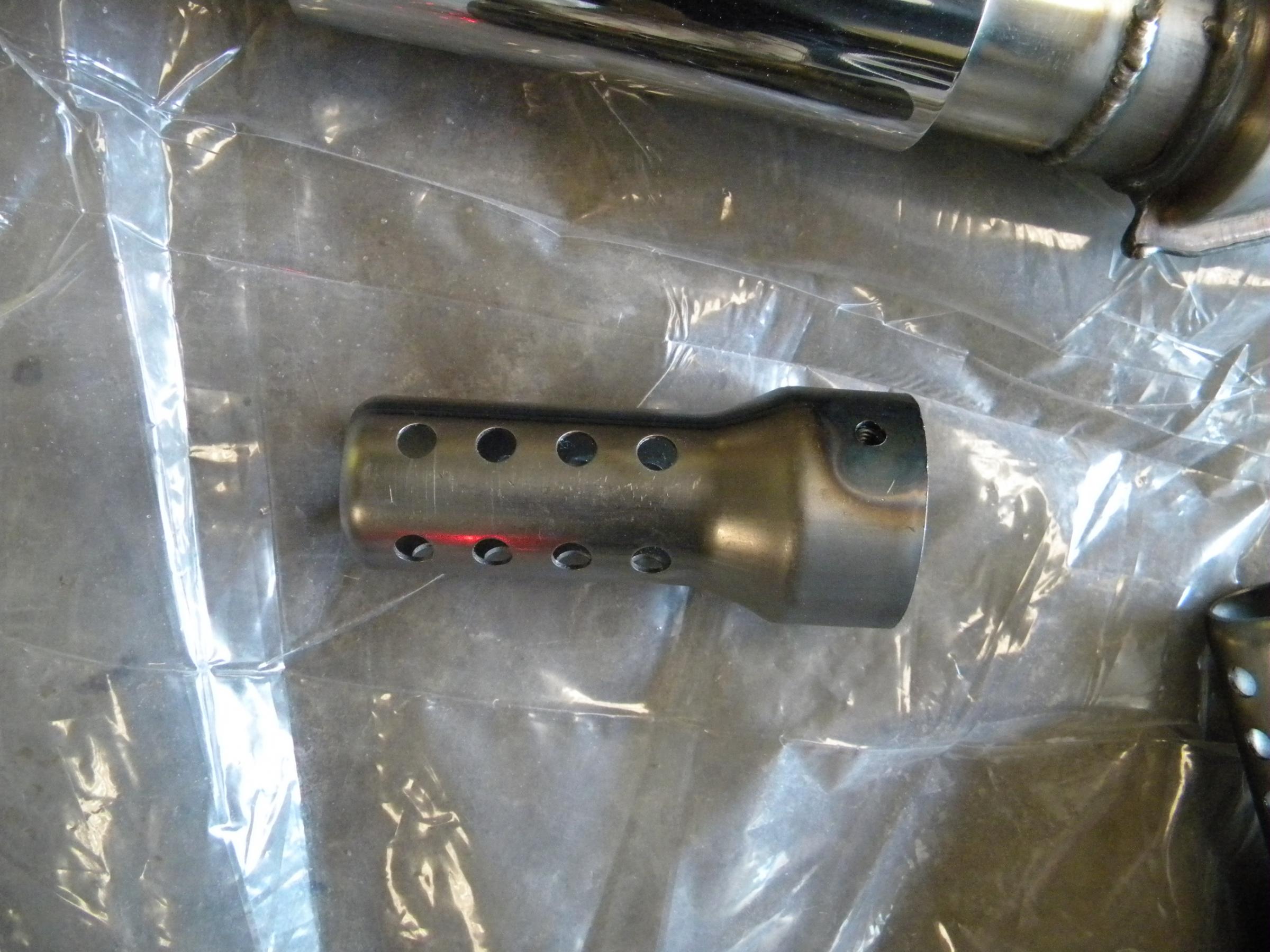

Several threads ago, I displayed an exhaust system that I made myself. If you look aT THE first set of pics u can see a Hyabusa (sp) baffle tht is perforated with an O.D. of 2.5". This is increased from the standard diameter of the stock 13 xkr pipe. The intent was to get greater midrange and hi-end which it did. However, I lost a lot of low end. The baffle was used to provide greater restiction thus giving more back pressure and turbulance. We cut the dual connector prior to the bifurcation and welded the baffle in backwards. It you look at the installed baffle you will be able to see that I had to cut off the head to get the baffle in the pipe and then welded it tight. The baffle had a smallest diam of 1.5/8 ". This was done to the pipes on both sides. My questionis: Will I experience appreciably higher back pressure and any reduction in noise from the addition of the baffles. There are no mufflers on this set-up. After I made this system , I decided to see if I could duplicate the sound of an aventador or california system. I got an extra pair of bifurcated duals that were 2.5". My question is: if I put a baffle that is cork-screw, or auger shaped into the pipe prior to the bifurcation, will I be able to get the same "scream" out of the dual exhaust as the Lambo or Ferrari? Word around the camp fire is that both of those manufacturers use a cork-screw, auger, or catepillar system in the pipes My second question on this is: Does the cork -screw completly fill the tube diameter or is there a space between the vanes of the cork-screw and the inner wall of the exhaust tube. Any technical help, whether from a mechanical or autopmotive engineer or someone who is more versed than I am, would b greatly appreciated. If you cant reply in English, feel free to write back in Russian, Polish or German. If none of those 3 work please let me know, and I will find the person who speaks whatever. (This post was also place on several engineering forums) Thanks in advance

The hyabusa screams at 5000rpm. But these were out of a 220mph Hyabusa bike and they just happened to be the baffles that fit the 2.5 " pipes on my 13 xkr I havent fired it up yet
