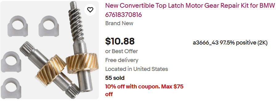

Sounds like the actuator gear is stripped. Remove the plastic trim cover and replace the plastic gear.
As seen on Amazon:
Better Deal. Do your own search using the BMW Part number 67618370816
Please take photos and document the repair for the next folks.

This part from
Convertible Top Latch Motor Gear Repair Kit Brass/Metal for 330i 2001-2006 67618370816 GP841650DH
does it also fit a 2009 Jaguar XKR? or do I need to find my own for a January?

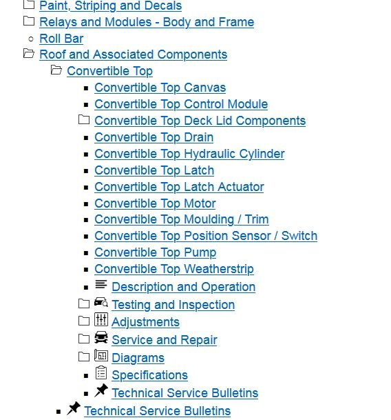

Check this out too:
Convertible Top
https://charm.li/Jaguar/2009/
Old Jul 19, 2025 | 03:12 PM
McJag222's Avatar
Joined: Jul 2016
Posts: 1,451
Likes: 857
From: Vancouver BC
Found more scroll down the link:
Scroll down the link to Body and Frame, then Roof and Associated Components, expand the box to convertible top:
https://charm.li/Jaguar/2009/XK%20%2...d%20Diagnosis/
