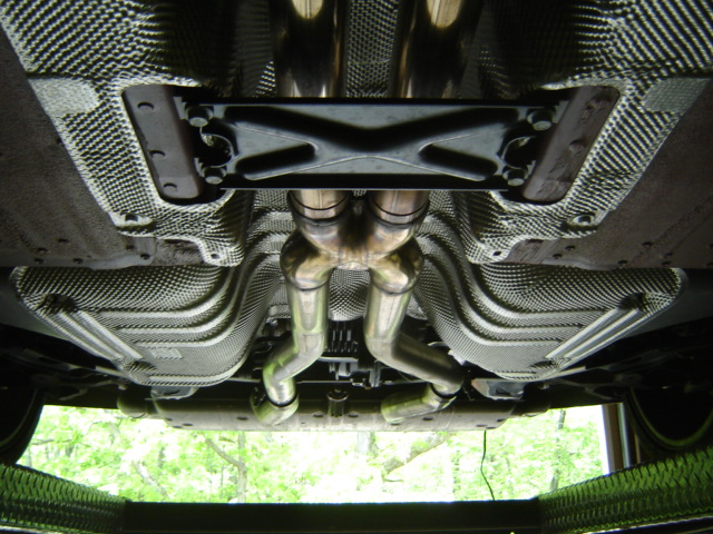

NV24 if you have your window sticker it will tell you if you have the Performance Active exhaust. I believe it was still an option in the 2014 XKR. That system has an X pipe instead of a center silencer. If you look under the car and see the picture below then you have it.

Jagtoes - thanks for the notes and picture. I found several references (Jag site and others) where it indicated that the XKR & XKR-S both had it standard, at least on the new ones. It does (did) have a 10-amp miniature in the #19 slot in the fuse block between the back seats. Will try to look underneath as soon as I can get it up in the air. More later.

All XKRs have the active exhaust, which is powered from Fuse 19 in the box between the rear seats. The Performance Active Exhaust was an extra-cost option on 5.0 XKRs from (I think) MY2011 - as jagtoes says, you can identify it by the crossover centre section and no centre mufflers. It was standard on the XKR 75 (not the 175), the XKR-S and (I think) the 2014 Dynamic R. It may be standard on other run-out models.
