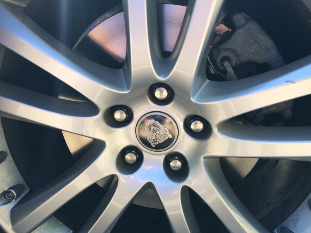

Pulled the front pad (which looked damned low eyeballing still on the car) and it was just under 3mm, the back was worse around 2mm. Darn. Just when I thought the car might have to have new springs on the front and back (the old ones are a little tired honey and the sports ones are the cheapest...) it looks like it's going to be the brakes that get the first attention.
I've also noted that a few of the rubber boots underneath are damaged here and there. Another little job for the future - brakes are first on the list!
What is the OEM brand for pads and discs? I'd like to make sure I don't cheap out on these as if I mess up the engine and can't get anywhere, it's one thing, but cheap poorly working brakes are a different box of monkeys all together!

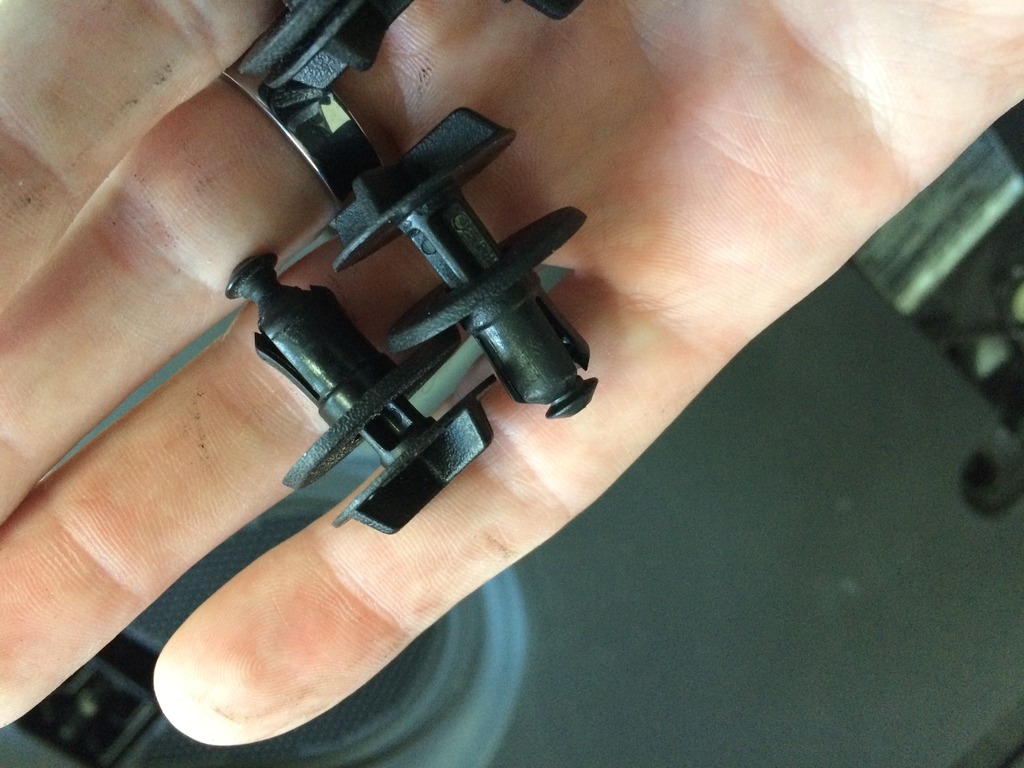

These are the typical unscrew and then pull out the expanded section. One of mine was broken. If anyone has the part number or spare, I would appreciate it! Thanks to kj. The part number is XR812941

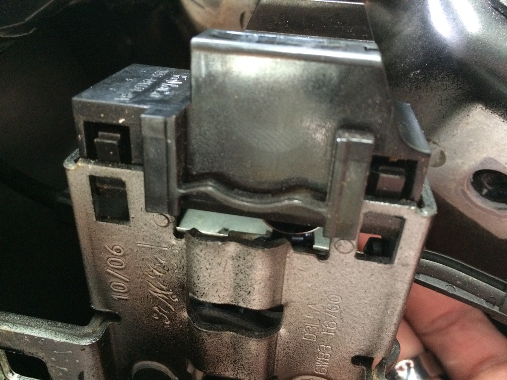

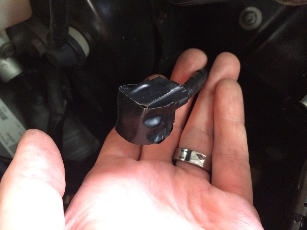

Next look at the hood catch and follow it down until you see the wires bundle going to it. Wiggle the connector out. Next find a short piece of wire and use it to short the connectors. I used a piece from a gudgeon pin.
Next you need to make sure you don't short it to anything else... So put some insulation tape over the top.
I then used some insulation tape to hold it to another part (so it didn't rattle). Closed the hood and checked for the warning light.
All good. Plastics back on and job hacked until the part arrived.

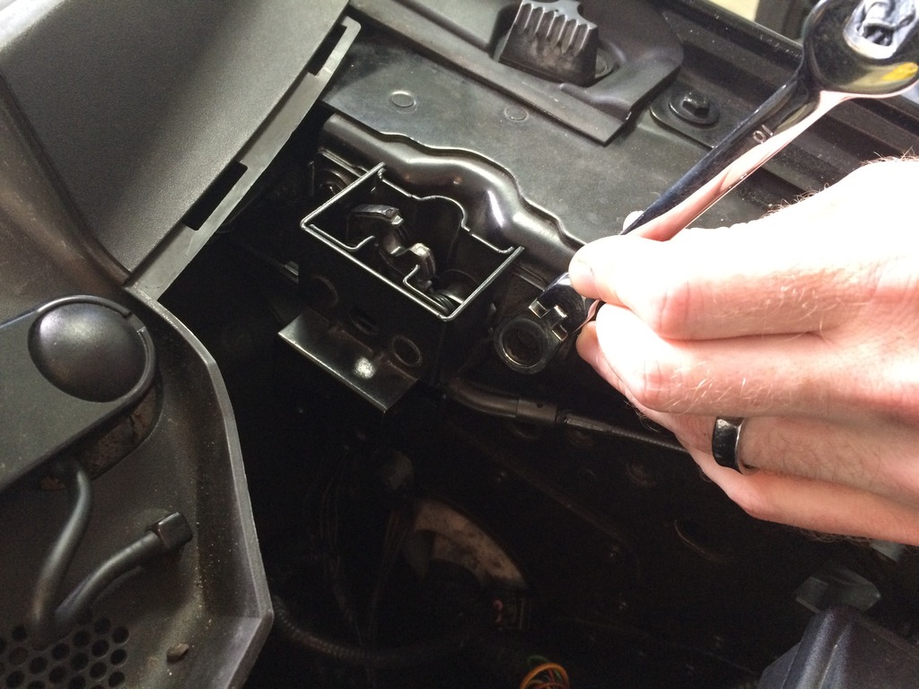

Anyway, plastics off again (try not to get annoyed by the partially broken screw) and ready to take the latch off. You need a 10mm wrench. The side nearest the windshield is tight for space so I used a ratcheting wrench but a normal one will also work - might just take an extra 30seconds.
I normally stuff a white shop towel underneath things I remove on cars with plastic under trays like the Jag. This gives me a fair chance of catching and seeing anything that clumsy four thumbs drops.
This time I went 'Onatural' (mainly as my usual towel for the job is in another engine bay).
Undo the two bolts and washers. With the bracket released but cables still attached

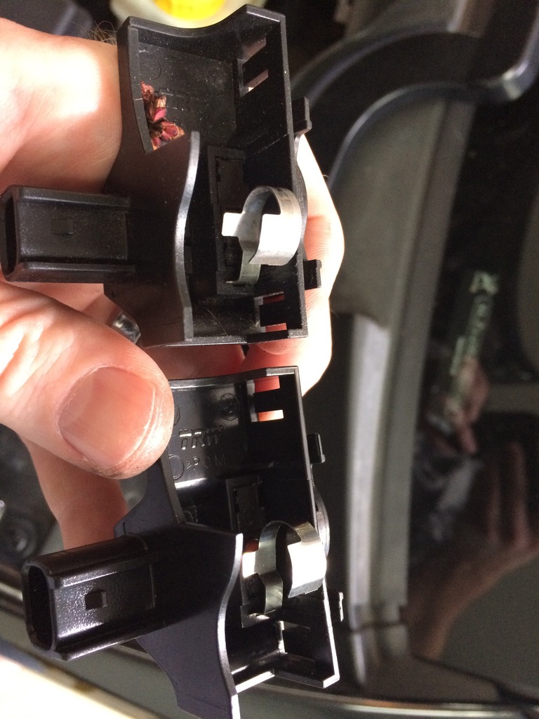

As you see comparing the old and new parts, old one upper, new one lower, I should have fiddled with mine.
The old one has a piece of vegetation in it (possible cause of the issue) and the spring seems a little more deformed than the new one.
Swap the old one out for the new. Slide everything back into place and you are done!

Edit: mine was an issue with the spring or that pretty little flower. I tested the switch itself with my multimeter and the switch still worked - no surprise I guess. Still, I have a spare now

Tomorrow is ceramic pads and new rotors

Do a forum search for the plastic screw thingys, there's a thread somewhere that mentions them and where to get them. I bought some based on that info.
If you don't find it, I'll take a look when I get back to a real PC on Monday.
Thanks kj. I'll see what I can find.
If I do find it, I'll stuff it in the post above.
Pads and discs today. A sure-fire way to get covered in grime...
Edit: found it - XR812941
Thanks kj.

$10 for two??? I'm sure I can find these for less(!)
Thanks kj.
http://www.ebay.com/itm/JAGUAR-S-TYP...hU-iLP&vxp=mtr
Thanks kj.
Jaguar s Type Radiator Shield Retaining Clips XR812941010 Set of 2 XR812941 | eBay
Thanks kj.
Yeah, that eBay seller always has high prices on stuff.
Brakes done. Not much hassle but lots of grit and dirt everywhere! Including my face apparently!
Took some pics so will put something together tomorrow to give others some idea of probably how not to do it
