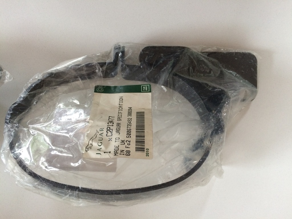

Dang is right. If you search the web, you can find those parts for less than $200 each.

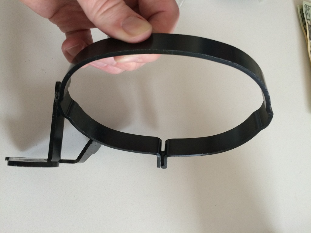

Thanks for posting the pics!
I did try the net but seems like although they are advertised, the sellers I've come across return your money and tell you they can't actually get them.
As I understand from Mike (super parts person), he had to supply my vin and had to ask the sales center / parts rep. They had to get approval from Jag USA before the parts could be released.
I will make some paper templates of them before I fit them. That way I can photocopy them and send them to anyone who might want to fabricate their own.

Here's a picture I found of them fitted:

As far as I can tell, they are brackets that attach to the transmission in a couple of places and have a metal strap that attaches around the cats. No rubbers provided with mine (or bolts for that matter!)
I simply went to my Jaguar dealer with the part numbers, asked them to order them (no argument and no nonsense about a diagnosis fee) and had the dealer install them. No more droning, no vibration, no hassle.
OK got ya so if is attached to the transmission then the rubber isolators are what the transmission is mounted to. Thanks.
