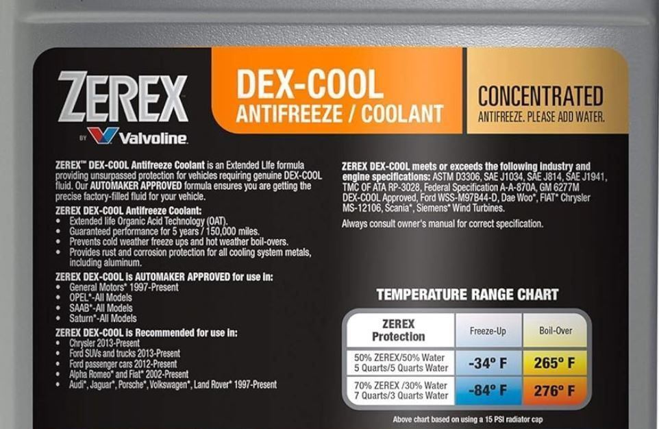

The spec in the 4.2 and 5.0 service manuals is Wss-m97b44-d, which was a Ford spec at the time. If anyone has an update from Jag with a newer spec, please advise.
Below are some examples that say they meet this spec, from a Google search of the above number. If you want to use another, check the label, and if no spec there check the online manufacturers spec sheet. Color is sometimes a guide, but is not to be trusted in a coolant you haven't confirmed as the above spec in documentation. Also, the Ford spec is independent of "American" or "Euro" designations. Motorcraft is hard to find, Peak is getting iffy, but Zerex is pretty much available.
I won't use "universal", but that's my choice. I've used Peak as noted below, and am going to Zerex next time I change.
One more point: The old manufacturer spec numbers are being supplanted by ASTM and SAE ones. The image of the Zerex bottle cross references the Ford/Jag spec to the ASTM and SAE ones. I think (?) that means the Ford spec cross references to the ASTM D3306. FYI.
