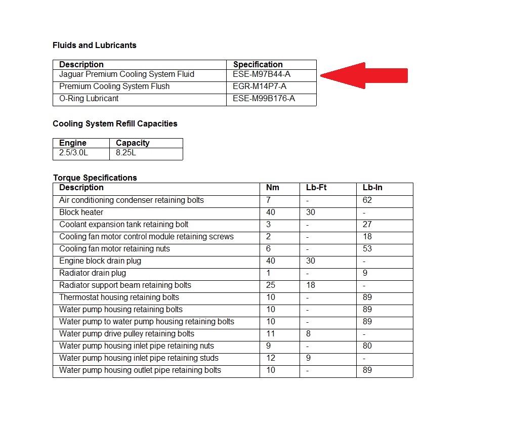

Matt,
JTIS lists the A type in the Cooling System specs:
Several sources across the Internet suggesting the A type and others that it should be the D type!

Thanks Graham. I think it may also vary by model year. From what I've been able to discern, the A is green (and anecdotally it seems like pre-2003 models came with green coolant) and the D is orange (later models, including mine, came with orange coolant).
There's no sticker or label near my coolant reservoir that indicates what the coolant spec should be. If I don't end up going with the Jaguar coolant, I'm thinking to be safe, I'm going to drain the coolant, then refill and flush the system with just plain distilled water, then re-fill with the orange spec D Prestone or Ford coolant. My owner's manual just says "WSS M97B44", without specifying a letter.
