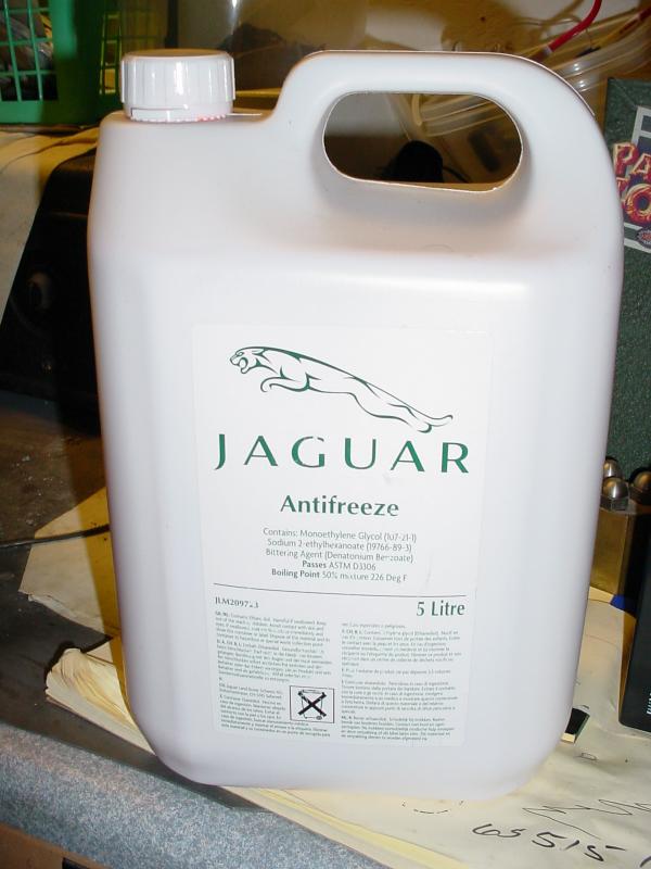

Originally Posted by DPK
I only know of the dealer as a source of the Jaguar Coolant..here is a picture of it..
How much of the Jaguar brand will I need for a full flush? Also a rouge mechanic topped it off with the green stuff, should I do any extra flushing or use a pre flush aid?

Green and Orange mixed, usually turns to a gel mess.
Amounts are in the post on the top of this current page.
