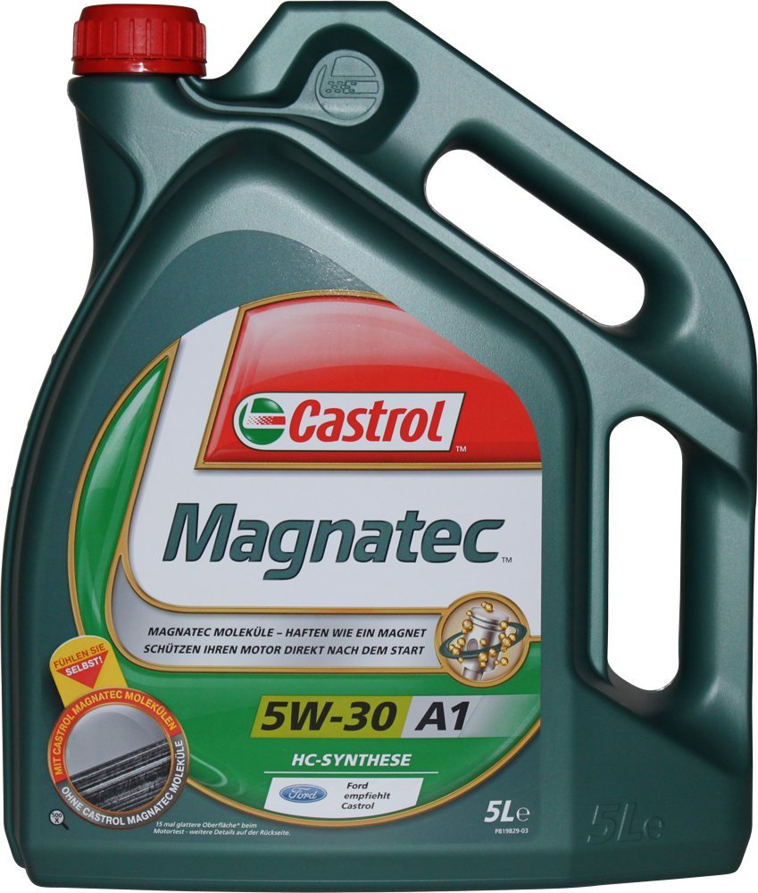

So going to do oil change my self and going by handbook spec, which reads:
Oil specification from owners manual:
API SL/EC and ILSAC GF-3 An oil of 5w-30 viscosity meeting jaguar specification WSS M2C913-A or B is preferred. Where this is not possible, oil meeting API SJ/EC and ACEA A1 98 or ACEA A3 98 may be used.
Ok so now the oil spec on the containers first,
Castrol Magnatec 5w 30 A1 FULLY SYNTHETIC, Which states:
SAE 5W-30;API SL;ILSAC GF-3; ACEA A1/B1, A5/B5;
Meets Ford WSS-M2C913-A, WSS-M2C913-B, WSS-M2C913-C
Now second
Castrol Edge 5w30 fully synthetic which reads:
SAE 5W-30; ACEA C3; VW 504 00/ 507 00; BMW Longlife-04; MB-Approval 229.31/ 229.51; Porsche C30; Fulfils the requirements of the former VW 503 01 specification.
After reading this my conclusion would be that the Castrol Magnatec is the proper oil for my car and models 2007-2009 4.2 xkr.
Any comments.

Think i will go with the magnatec A1
Attached Thumbnails O.k what is the correct oil for a 2007-2009 xkr?-right-oil.png

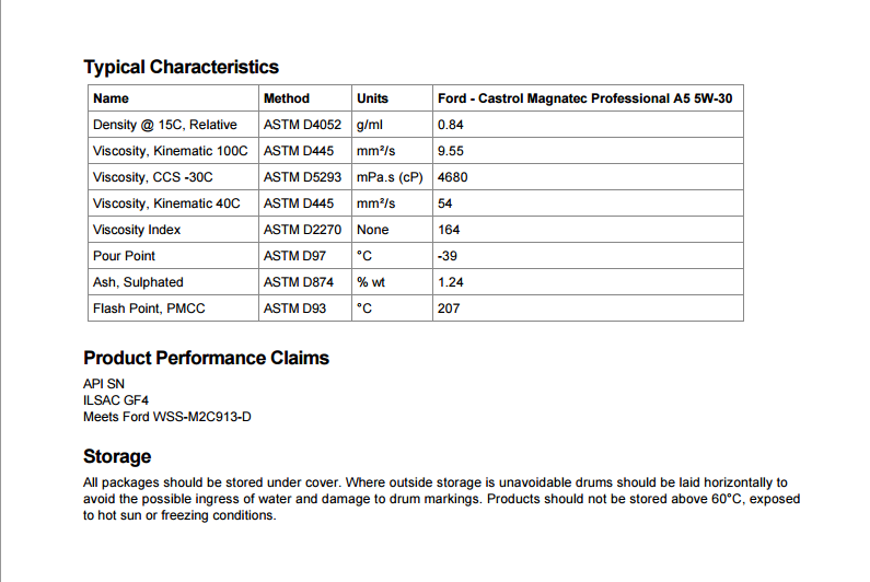

Here we go again, went to the auto shop to get the magnatec A1 as it is the nearest to the manual spec. He told be it has now been superseded by magnatec 5w30 A5. I said was he sure and he phoned Castrol Ireland while i was there. So now it looks like i am going for this, it states that it has the same requirement as the A1.
Holy crap such s**t. Info on Magnatec A5 below.
Attached Thumbnails O.k what is the correct oil for a 2007-2009 xkr?-a5.png   O.k what is the correct oil for a 2007-2009 xkr?-a52.png

Mikey's Avatar
Joined: Oct 2009
Posts: 11,057
Likes: 2,272
From: Perth Ontario Canada
That's the oil I linked to above. It meets the spec precisely.
