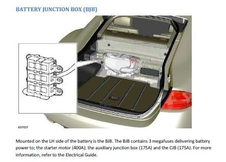

A regular issue with earlier models has been the HPPM (High Power Protection Module) where megafused connections from the battery to the starter motor have slackened or the cable terminals begun to break up. The result has been intermittent starter motor issues. The XK is a more complex design but has a similar battery fuse connection known as the BJB (Battery Junction Box):
Worth checking and eliminating the connections as a possible cause.

Okay, so got around to removing the BJB about a month and a half ago, took it apart smudged some NOALOX paste on the contacts, put it back together, reinstalled it and haven't had the problem reoccur since. I've let it sit for up to three days, cranks right up, no accessories failures so far.
Thanks for the tip GGG!
