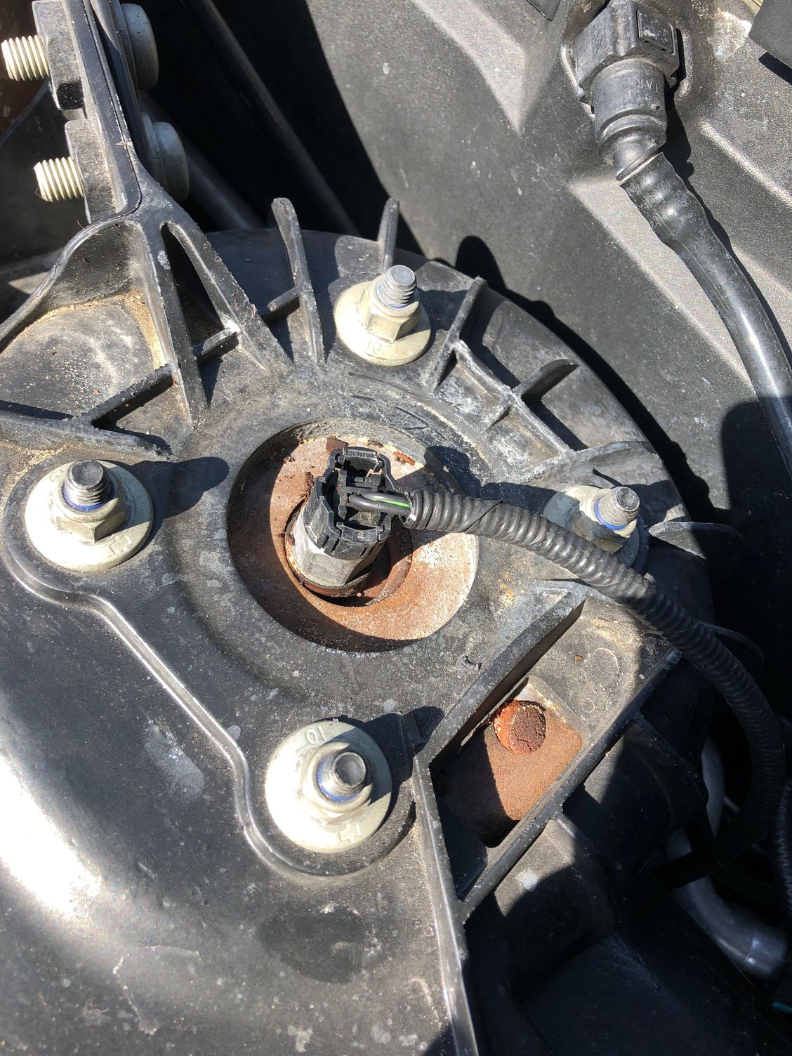

It's the shock mount, which explains why the frequency and speed doesn't change.
cheers

Yep, it's the shock mount. Just WD-40 the top of the mount real good and it will go away. Ask me how I know.....
